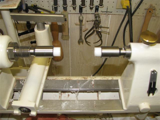

I own the Big Horn model. It works well and is easy to adjust for various lengths. However, I use my lathe to press parts together these days. I turned some soft plastic fittings for my headstock and tailstock. I just crank on the quill to press the pieces together. I got the idea when I saw PSI had come out with two plastic parts for pressing on the lathe. The Big Horn just collects dust and shavings now. A pen press would be very low on the priority list if I were advising someone new to pen turning. There are so many ways to get the job done without spending the money on a press.

Here's mine! Works great!
attachment.php
2 MT2 stub arbours with some Delrin stuck on the arbours with double-sided tape.
Less than $20.00 cost.

I don't use one. Similar to (but nowhere near as elaborate as) Mac's above I just turned a couple of 'stoppers' for headstock & tailstock from scraps. Didn't even cost me $5. Works great with very fine control on insertion of mechanisms etc. When they get a bit chewed up, just turn a few more.
I turned a piece of 1" maple dowel I had with a #2 MT on each end and then cut it apart in the middle. Inserted into eachend of my Jet lathe it will press the pens together with good control. Just turn the handle crank on the tail end till the parts are set. Cost, free.

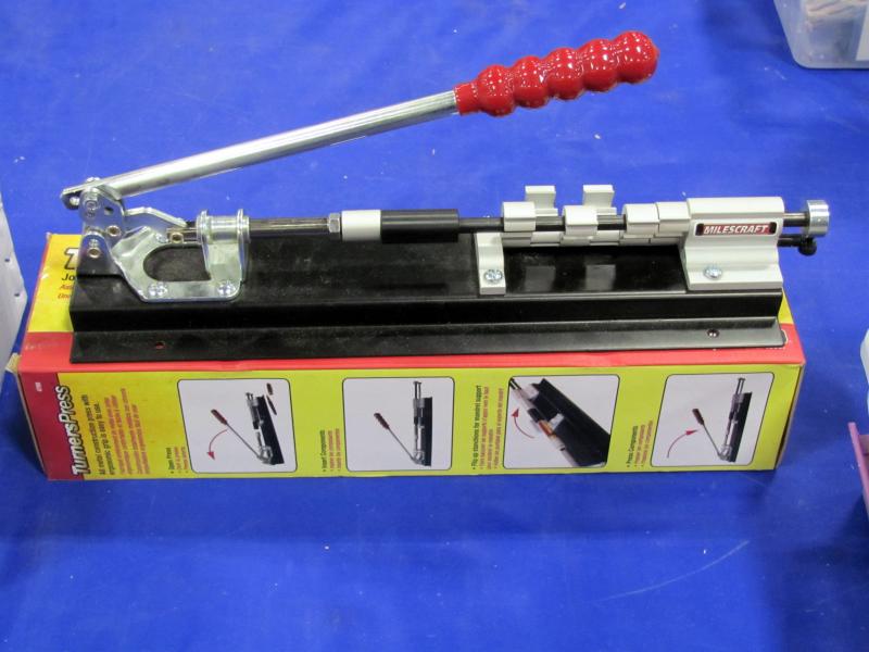

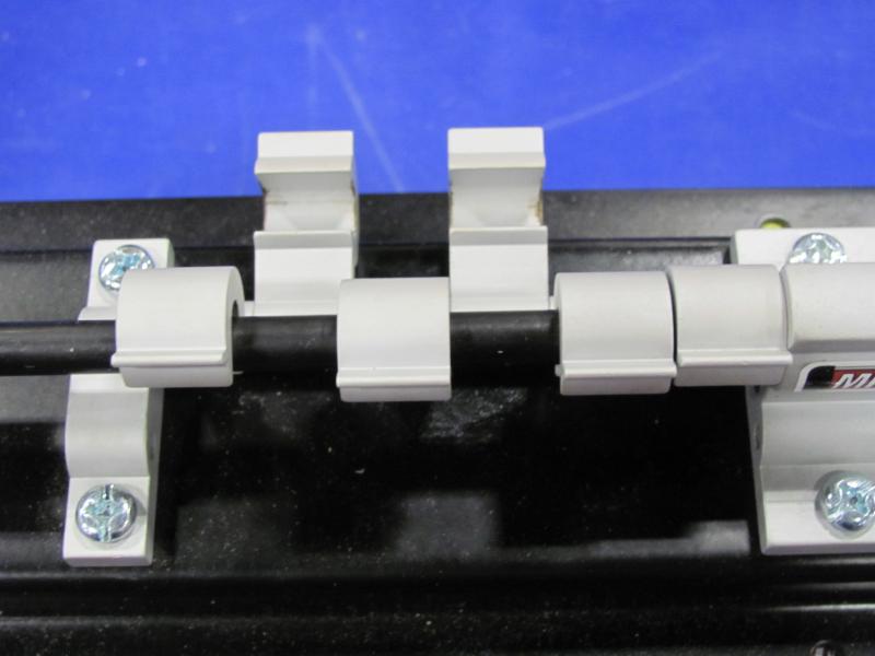

I was pleased with my Zyliss until I used the new Milescraft model while working the "Learn to turn" exhibit last weekend. Spring loaded rod and flip spacers with micro adjust piston allowed me to punch slim transmissions accurately in one shot and complete the pen way faster than I could have done on my Zyliss. Of course I had to take one home. :rolleyes:

I too worked at the "Learn to Turn" CSUSA booth last weekend at the Woodworking Show in Ft. Worth. I used the Milescradft pen press and also returned home with one.

Harry, How did you set it to do slim transmissions? Is it something that will stay setup or do you need to reset it every time?
Thanks
I'd like to learn Harry's technique, too. Love the Milescraft. I've suspected that it could be set for pressing transmissions in to the same depth, but haven't known how. Of course, if I had read the manual . . . Russ

David, if you have problems with the parts jumping off the press, and who hasn't picked a few up off the floor? I would recommend the spring loaded Miles Craft with quick flip length adjustments. After using one at a turn-a-thon I was hooked.
Amazon.com: Milescraft 4700 Turners Press for Joining Pens and Other Turned Projects of All Types: Home Improvement
