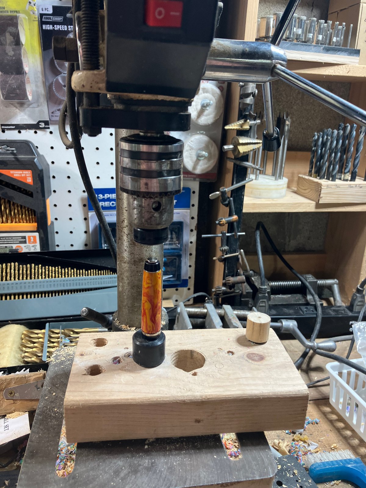

My wife will attest to my passion for tools of all kinds. When it comes to pen turning there are no exceptions, usually. I have tired a couple pen presses over the years but they usually get covered with dust from not being used. I always go back to what works for me, one of my drill presses. I keep Delrin stock on hand so I turned myself a couple soft-faced pieces over the years along with one of my "drilling aids" (piece of 2x4) I have laying around and viola, my drill press becomes an arbor press. I use a deburing tool to clean up the inside of the tube ends and this also creates a slight taper which aid with the parts aligning easier and more quickly for and during insertion. I also found that for me, maintaining parts alignment is easier in a vertical position than a horizontal one. Excuse my mess, been busy and haven't cleaned.
