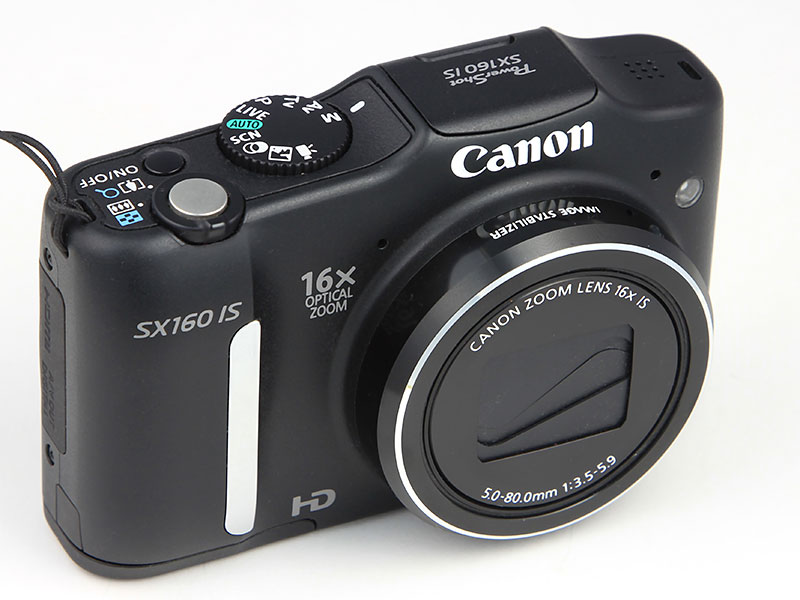

I want to make things as simple as I can, so I'm keeping the gear to a minimum. You don't need a high-end camera and a lot of expensive studio equipment to take a decent picture. For this demonstration, I've chosen a relatively inexpensive point-and-shoot camera:
attachment.php
This is a Canon Powershot SX-160 IS that I picked up last year for about $70. There's nothing special about this particular model, it's just one of the cheaper cameras that still has manual controls.

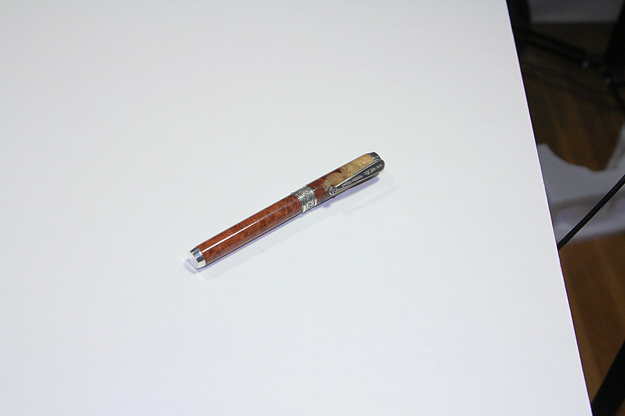

I'm going for a simple composition as well- just a plain white background. For this exercise, I've placed the pen flat on white mat board, angled across the frame and towards the camera.
attachment.php
I put the matboard inside the light tent, so that I could photograph it at roughly a 45 degree angle. I usuallly prefer a lower point of view, but the front light tent opening makes that awkward. So, I compromised.

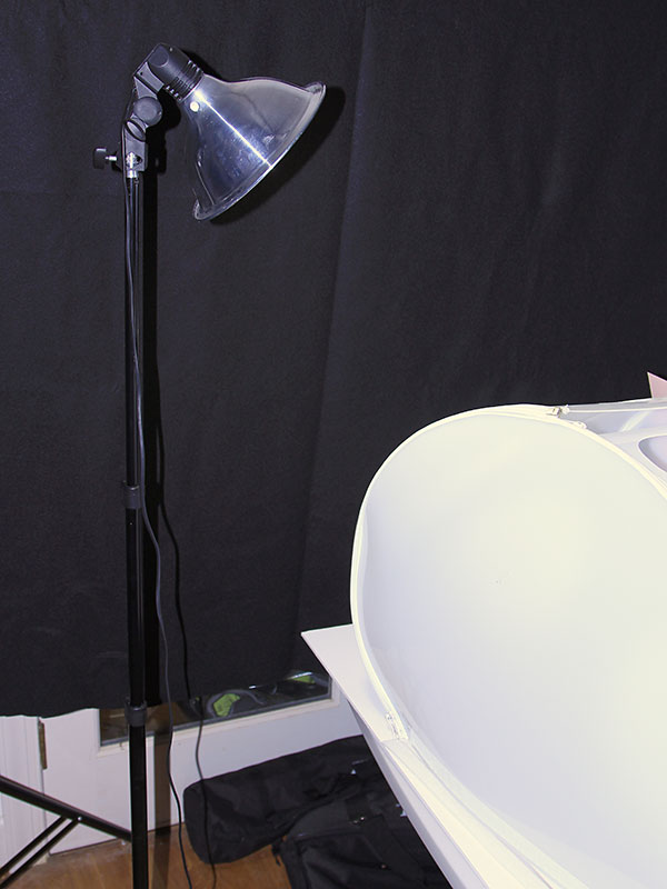

A little shadow under the pen adds depth to the photo, so I chose to backlight the pen. I placed the primary light above, behind, and to the left of the light tent, aimed at the rear and left walls.
attachment.php

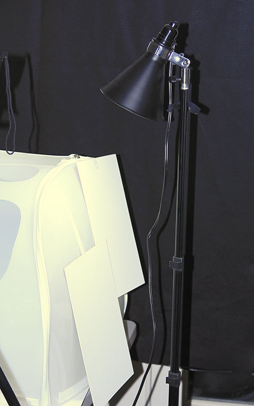

The secondary light serves two purposes. First, it illuminates the front of the pen (otherwise the blank would be in shadow). Second, it creates the "shine line" on the top. A little reflection serves to add depth and it also calls out the glossy finish. I positioned this light to shine on the upper front edge of the right wall of the light tent.
attachment.php
You can also see that I've taped a couple small pieces of mat-board to the light tent. By blocking the light this way, I've controlled the size and shape of the surface reflection. If I had lit the light tent wall evenly, there would be no shine line at all. I used mat-board because I have a bunch of it laying around, but anything opaque (construction paper, fabric, cardboard, etc.) works.
Now the pen is well lit, with a soft shadow and a highlight. Because the reflective metal components are inside the light tent, they are evenly illuminated and show their detail nicely.

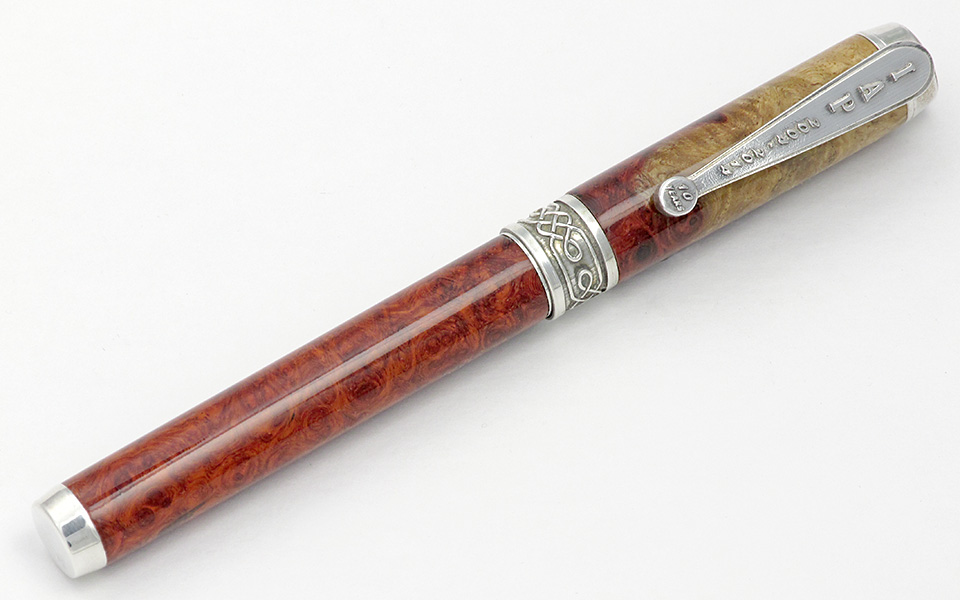

Here's the result

Eric, Fantastic and informative as always, and the photo is excellent.
I've used Museum Wax (or tacky wax as we always called it...) and yes, it is not friendly to porous materials, I can't say anything about the gel as I never used it. I started using small pieces of kneaded erasers (Click here to see at Amazon), as they behave a lot like the wax (but they are MUCH less sticky) and don't leave anything behind (provided you don't squish it into deep crevices...
Your tips on blocking light with the mat board is an excellent one, and it shows in the photo very well and the effect should be very clear to anyone who has ever used a light tent.
Not knowing what the pen looks like in person (you can always send it to me if you want to rectify that...:biggrin:) I am wondering if the clip has specular highlights around where the 2014 is. If so, one way to deal with those is to find the spot on the tent that directly relates to those reflections and place a small piece of black tape or similar over JUST the area that is directly reflected (not a problem with constant lights or lights with modeling bulbs, but it can be a PITA if you are using strobes...) I'm also wondering if a few strategically placed small pieces of dark board (black or various shades of grey depending on how much you want) just outside the lower left edge of the frame might have helped define the lower and back part of the end of the pen by blocking the light reflecting off of the hardware. I'm not 100% positive that this would work, but I've done similar things in some situations, so it's something to keep in mind, especially with highly reflective surfaces being shot on white...
Certainly not any criticism of the photo, it is fantastic on it's own, and I'm not saying any of this would make it "better" just possibly different...
Todd,
Thanks for the feedback. There is some texture under the letters (and numbers) on the clip. Where the "2014" appears, it almost becomes a tiny moire pattern. That's what's catching the light.
I believe that a bit of black tape at the right spot on the light-tent wall might have tamed that reflection. I also agree that strategically placed dark paper could have yielded better edge definition to the silver finial and centerband. Both of those suggestions would indeed have improved the photograph. I also would have liked a slightly less prominent shine line. I probably should have moved the fill light away from the tent a bit. A polarizing filter might have helped there too.
I didn't, however, do any of those things - for two reasons:
  1. I wasn't looking critically enough at the picture while taking it, Therefore I didn't notice those opportunities for improvement, and
  2. As a teaching aid, I was more interested in producing a reasonably good photo with minimal fuss than in doing as much as possible to take the best picture I could. My goal was to explain how the concepts of composition, lighting, perspective, and exposure (et.al.) and the mechanics of using a digital still camera play out in a basic pen photography session - at minimal expense.
Regards,
Eric
