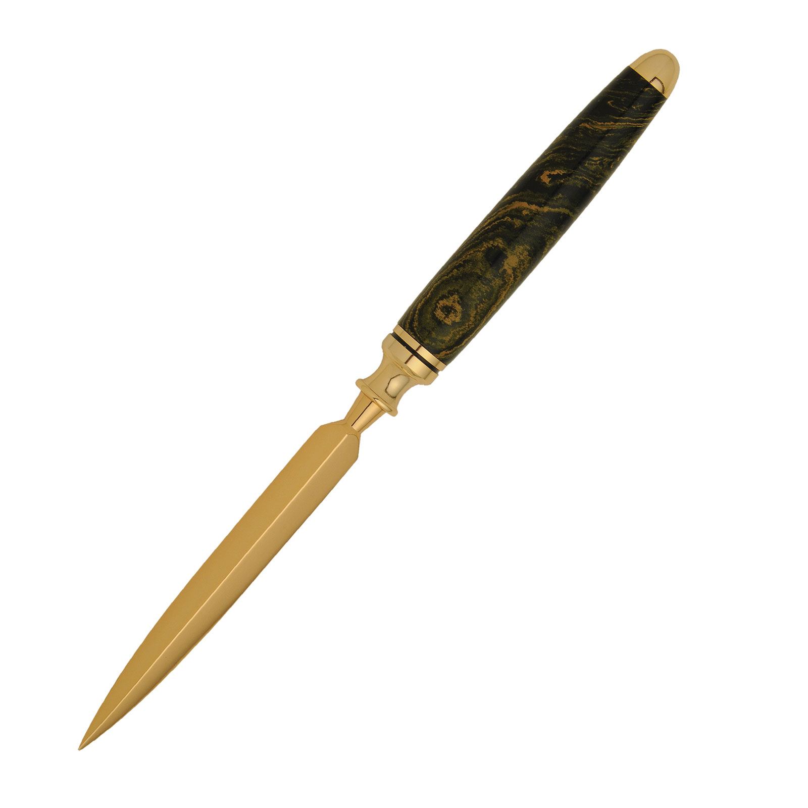

I always thought the European looked a lot like the PSI Designer. Here is one of their letter openers...
