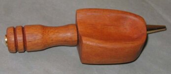

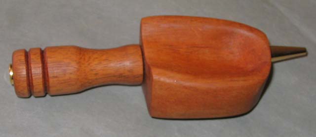

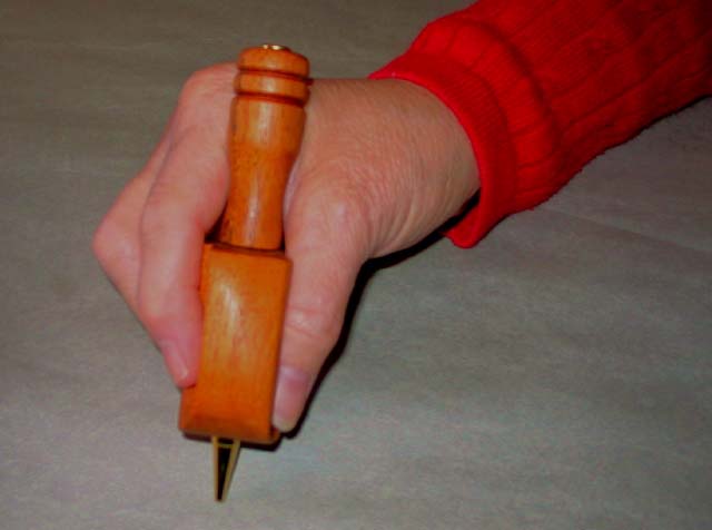

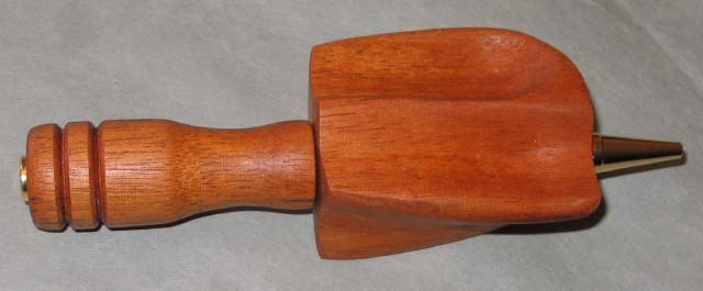

Here's how I did it.....
Here's a pen I did for a friend that has arthritis, it may give you some ideas. I put modeling clay around a slimline pen and had the person grip it and mold the clay until it was comfortable. One side has a large indentation for the thumb, the other a ridge between the index and middle fingers. Then I carved a wooden copy of the clay and assembled it on a slimline kit.
txbob
