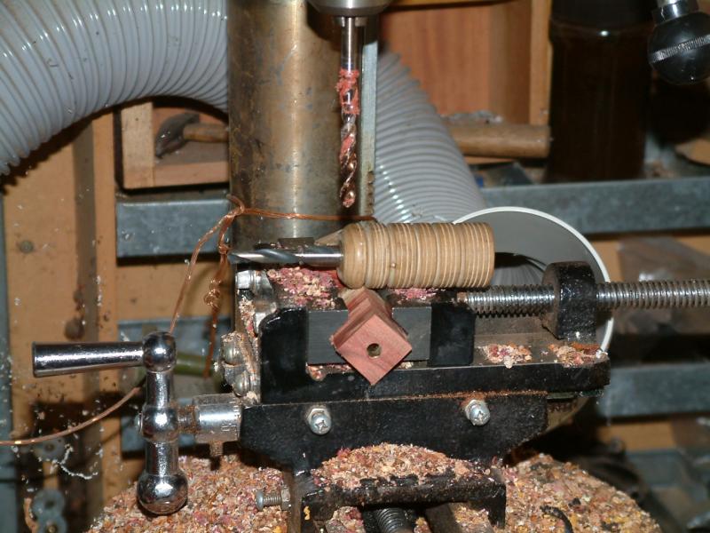

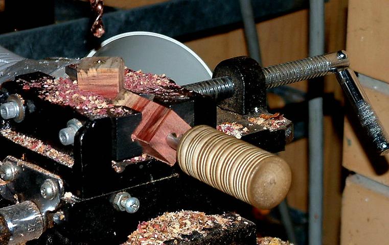

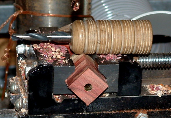

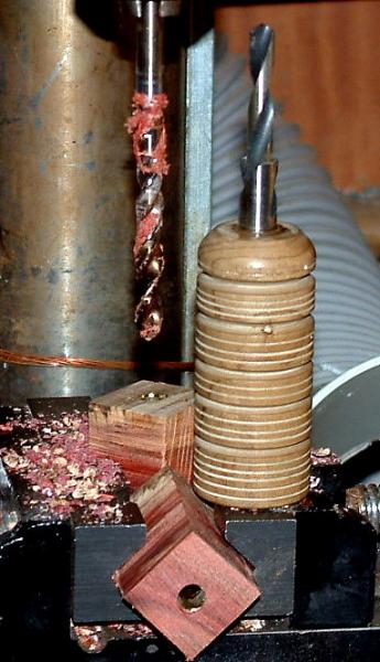

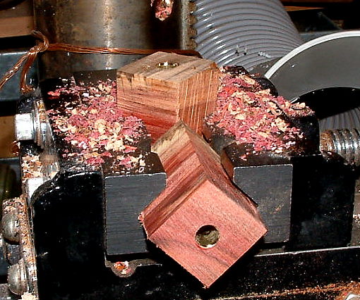

Keith,
Two things come to mind immediately this is a very old chestnut and I have given my thoughts on many posts.
Ist thought when you use any sander use protection from dust anyway.
2nd thought for over fifteen years and in use by me today is a stepdrill in high speed steel that was the very first reamer made in the good old USA.
Step drills have been loosely described as those tapered things that enlarge holes in a viscious way as well as many others.
The one I have is a snug fit first size approximately 1 1/2 inches the fit inside 7mm brass tubing( wonderful cause it does not poke through the brass and ream a hole in my hand) this then steps up (hence the name Step Drill) to around a half inch. In the process of manufacture it has a slight shaping where it meets the brass that perfectly reams the entry into the brass tube and the almost flat lands give a flat face to the blank.
As in all things in the hands of gung ho people they used to fit it into a battery drill and try
to ream the living daylights out of a blank and all sorts of problems ensued as they do to this day with most blank reamers.
My reamer is as good today as when purchased and since my majority interest is Slimlines with Streamline centre bands who hoo. Step drills can be made in any size in Tool Steel or Carborundrum drill manufacturers or remanufacturers can make them by grinding existing drills in either of the Tool or Carbo Steels. It is common practice in this country for special grinds.
I fitted a Wooden handle to mine initially and treat it as carefully as a Vernier Caliper.
Benefits and non benetits for me are pristine removal of any crap in the brass, perfect entry into the brass with the reaming on entry, double check my sanding technique for flatness.
A few old pics may assist my explanation.
My reamer cost me over twenty dollars at purchase should have heard the criticism over price all those years ago same as today all the kerfuffle over drills, shapes sizing resharpening. I use drill point DeWalt made in the USA drills cheerfully throw them away after so many hundreds of drillings. Amortising uses, lifetime ets tells me this has been and continues to be the cheapest part of penmaking for me. Promise this is the last time I will bore everyone.
Kind regards Peter.
