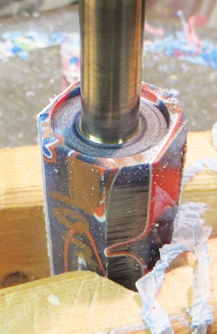

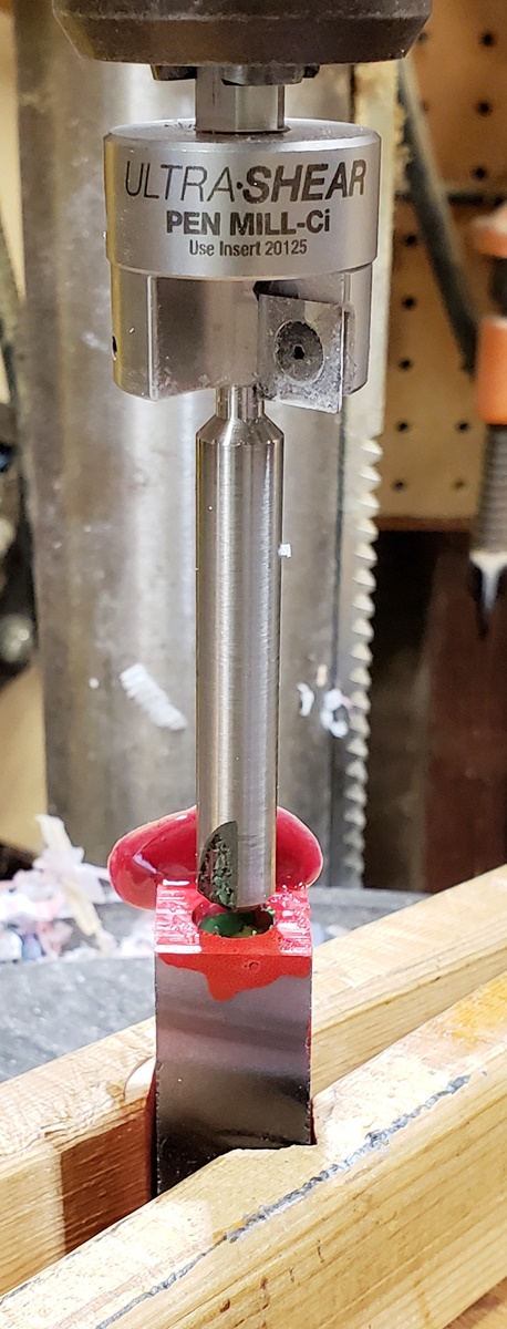

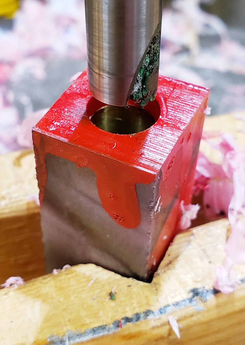

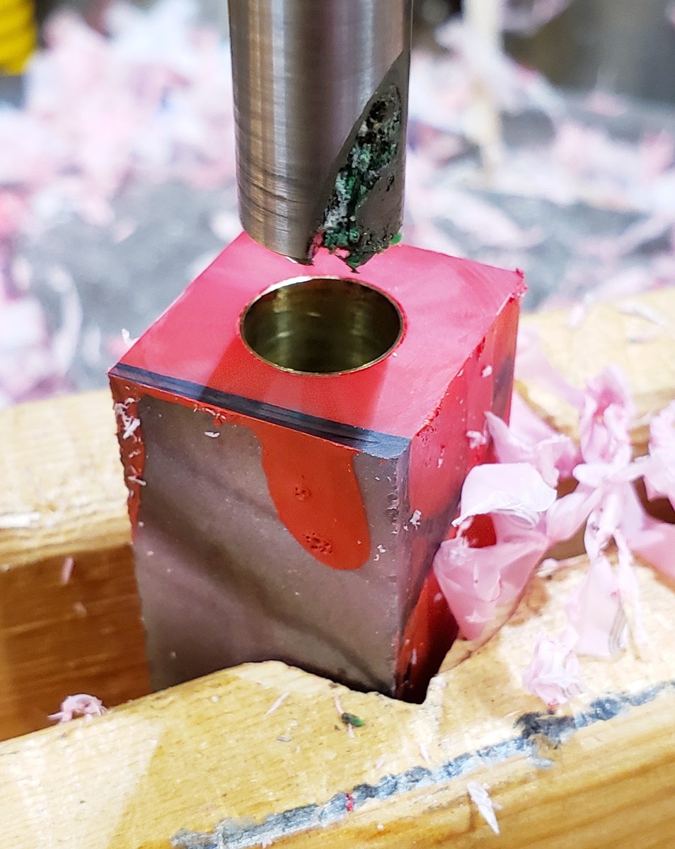

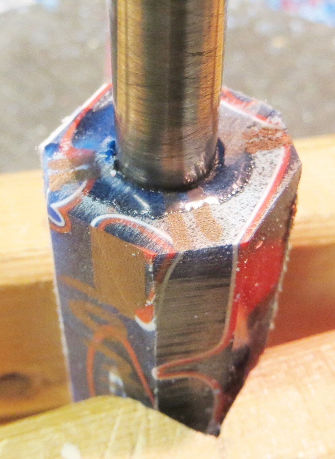

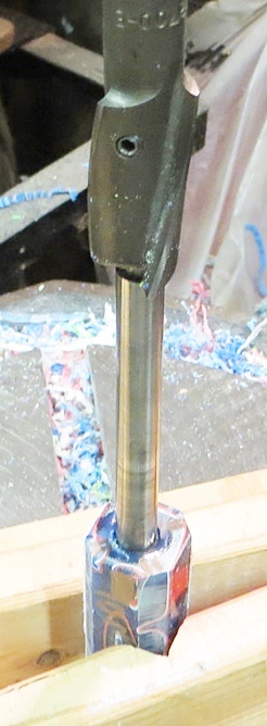

I have tried sanding, both with a jig on my disc sander, and a jig on my lathe. Don't like either method. I have used several commercial pen mills, over the years, and also a piloted end mill with custom pilots my b-in-law made for me over 10 years ago. My current favorite is the relatively new, and very expensive, Woodpeckers Ultra-Shear carbide pen mill. It uses carbide cutter inserts. The cutting face is a little bigger than most pen mills, at approximately 1.09". One thing I don't like about it, is they don't have all the pilots (13/32" and 25/64", to name two).
