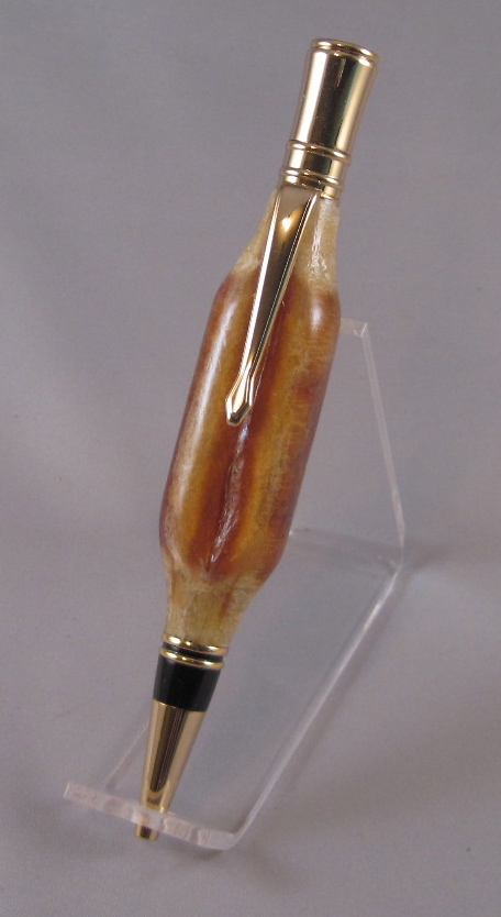

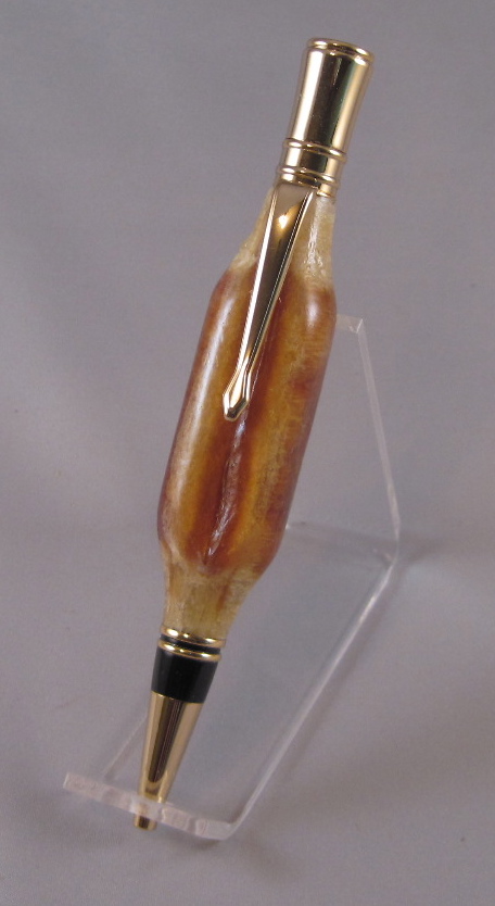

Here's a photo of my latest sale.
I have made and SOLD several pens made out of bull penis. No kidding. (Wear a respirator).
This leads to so many questions... Like how and why did you start? And where do you get the material? But more importantly, how did you start with that material?
I used to work at a zoo and suspect this would have been popular with a lot of the staff. My grandfather, a cattleman most if his life, met a lady at the Florida State Fair who made walking sticks out of bull penis. They were very popular.
Well, as you know, we as pen makers need help. We're addicted and always looking for way to expand the envelope. OK, OK, I need more help. LOML and my other pastime is competing in dog agility. Bull penis (bully sticks, puzzles) are dog treats that vendors routinely sell at the competitions. I saw some big ones and the light bulb clicked. BTW who do you think picks them up the most at a show???
I always wanted to do agility with an Australian shepherd I had, but she was too lazy to buy into it. Go figure, a lazy Australian shepherd.
I've seen those bully sticks for sale and never thought of that. I'll have to keep an eye out for them.
As for who buys the most? I have no idea, though my first thought was middle school boys buying them as joke.
I didn't realize that this pen turning thing was supposed to be a race between each of us and Ed. I guess I'm doing it wrong.
