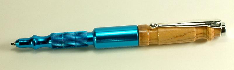

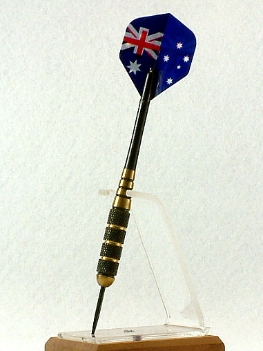

Using three brass knurled Darts a composite pen was made fitted to a score book also using Slimline parts to enable a twist mech and easy to replace the biro using two brasses.

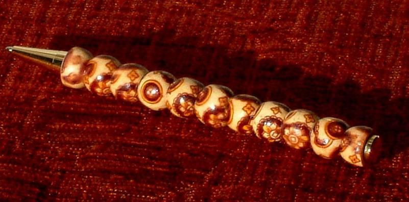

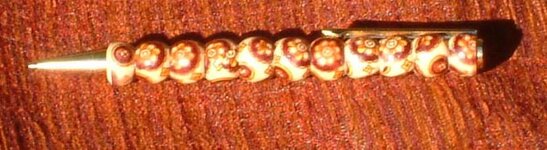

Handpainted, drilled , faced Beads.
Old pics bad luck changed computers a while ago so pics only to give ideas.
Have fun I do.
Kind regards Peter.

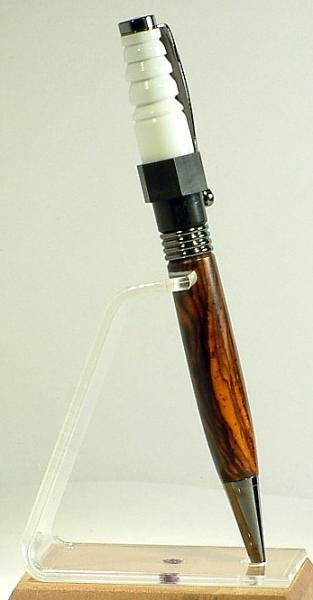

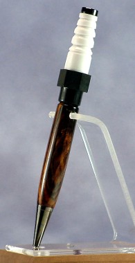

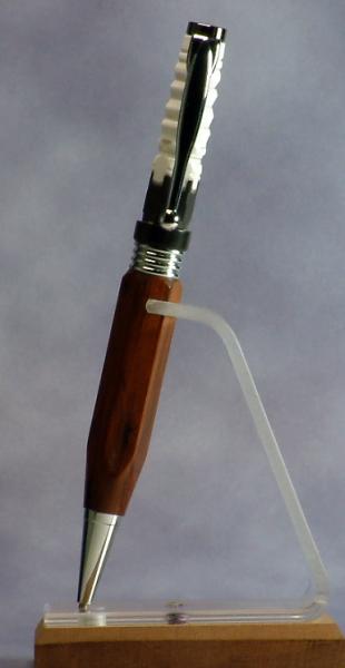

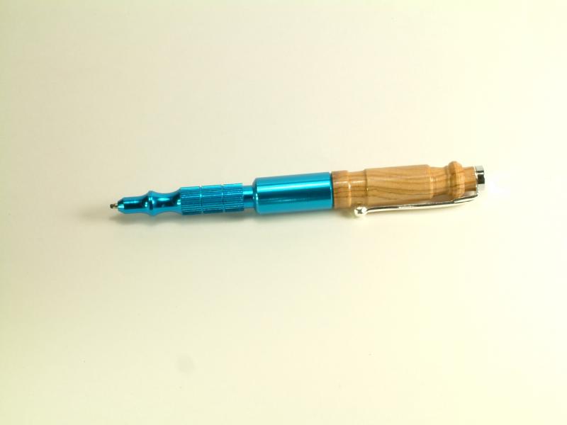

Some more pics. My Spark Plug pen African Ebony white Corian, Straight Air Gun Modified Slimline Streamline can be operated by the knurled section or the top.
Cheers Peter.
