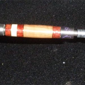

Here is a layout - a picture is worth a thousand words:
PICTURE With Mandrel which I personally rarely use:
IN the top two, you can see the blank on the lathe with a bushing on each end. On the bottom you can see the blank off the lathe and two sets of bushings. While it is difficult to see without knowing what to look for, one set of bushings is ordinary bushings and the other set of bushings have a cone shaped divot that fits perfectly with the head stock dead drive and tail stock live center. EITHER set of bushings work.
The process is to use the bushings on a blank until it is round and down to size (Use calipers to determine the size, not the bushings). Then take the bushings off for finishing. This works particularly well when finishing oily woods such as ebonies. Taking bushings off of ebony the woods after finishing with CA will often cause the CA to lift up off of the blank. Therefore, finishing is always easier without bushings, unless you use specialty nylon or other non stick bushings to use when finishing.
What is needed for TBC is a 60° live center for the tail stock and a 60° dead or drive center for the head stock and a set of bushings for the pen you are making. That is it.
