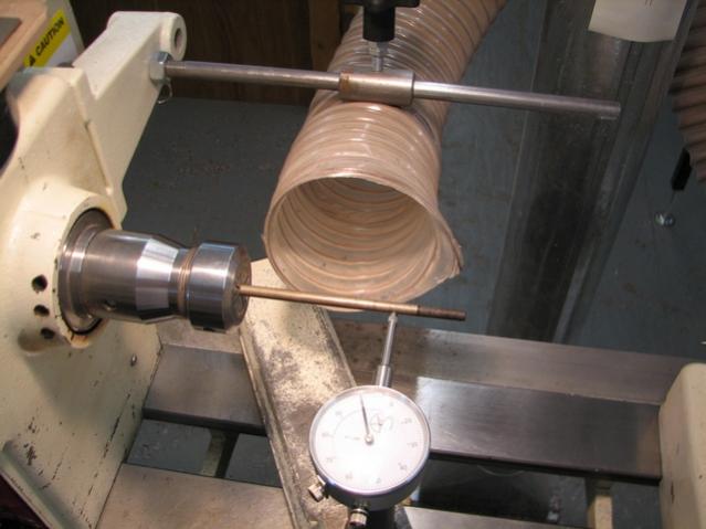

This is how I do it.....
Turn the lathe by hand until you find the high spot, I like to have the high spot AWAY from me so I can tap it BACK to me. Grab the plunger with one hand and push it in and with the other hand lightly tap the mandrel back towards you. I use a small hard rubber hammer. A couple taps is all it takes and I can get it under .001 in about 15 seconds. I also do this with EVERY Pentel Mandrel and Sanding Mill that I make and I swear by it!!!:wink::cool:
