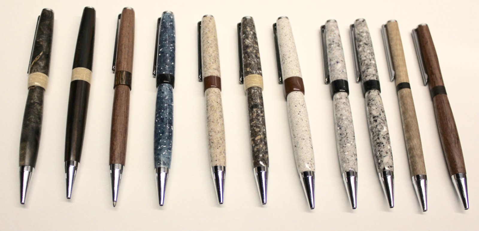

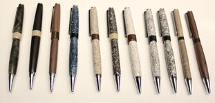

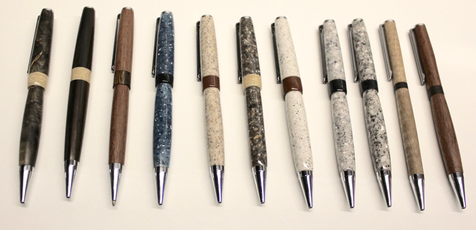

Consider some simple segmenting with any of the 7mm kits - these are actually very easy.

Dan - At some point I will try segmenting, as for the present I have been using and liking the slimline pro kit. Was curious as to what other kits I could use without segmenting.
Mark- Thanks for your input as well. I have seen your photo in the past. Very nice! I do like the look of some Corian alone without being segmented

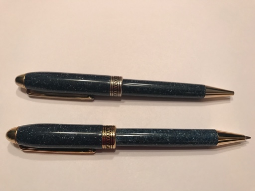

This is a European pen and pencil set that I did by gluing 2 pieces together. It gave me a 1" thick blank to work with.
