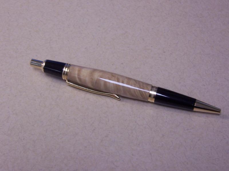

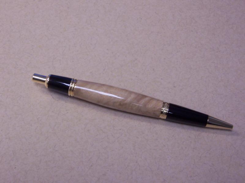

Hello,
I've been a wood worker for many, many years, but just got my first lathe a couple weeks ago...bought a pen starter kit from PSI. I am hooked! :embarrassed: First thing I did was toss the shellawax and started watching youtube videos, where I discovered CA finishing techniques. It took a while to get the hang of it but I think I have it down now. Made about 35 slimlines over the past couple weeks and decided last evening to try something a bit more interesting...its a Sierra click in box elder burl. Two coats of thin CA to seal and then about 6 coats of medium CA...the box elder had some voids I needed to fill. MM down to 12000 and then triple buff on Beall. This maybe overkill and I welcome comments, but I am pretty happy with the result. I consider this my first real pen! :) (I do need to work on my pen photography too!) I found this list and started reading yesterday afternoon...it helped me fix a couple of "problems" already...so thanks in advance.
- Frank

Frank, welcome aborad. Looking at your pen, looks like you are off to a great start!!:wink: As warren, said, quite a few of you folks in that area. Hope to see you guys start a local chapter!!

Hey Frank Great looking pen. I am up in the Davidson area about 45mins from you. Like Warren said there are a few guys around the area. We should look into a meeting at somepoint.

Welcome Frank. You are doing great and your background in WW'king is showing immediately.

Hello neighbor! Your right in my back yard.I'm just right up the road in Lucia.Welcome to the site there is a wealth of knowledge here.And btw thats a good looking pen you got there.

Welcome from sunny southern California, Frank. Sure seems like you've got that CA finish down well. Thats a beautiful pen.

Gee dustmaker!
I wish any of my early pens had looked that good. I didn't know about CA then. I recently discovered Adobe PSE, (it lets me crop the image so that the pen appears much closer/larger on this forum.) With it , I've stopped taking the corner to corner view of the pens too. The image then looks closer than before. Again, very nice work for a new turner. :biggrin:
