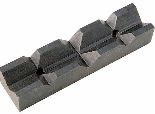

Since the 1980,s I have used prismatic jaws (bought from Grizzly in the US) as a pair in my X Y controlled vice on my bench drill.I threw away the taiwanese motor fitted a one HP Australian made motor in the bench drill.
Went through and replaced the bearings on the drill press (great improvement). Fitted a quality drill chuck held in place by a threaded rod.
The pic I just found shows how I use the jaws in the horizontal Vee to clean out and lightly ream the blank after glue up. The vertical Vees take care of any misshapen blanks (I am always chasing grain).
That said later years obtained a Vicmarc two jaw chuck with chuck combined for small accurate turning of small cut square timber for Lace Bobbins etc. This covers all bases for me. I have a few sets of Collets ,love them also, courses for horses.
