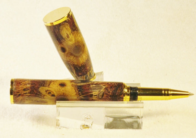

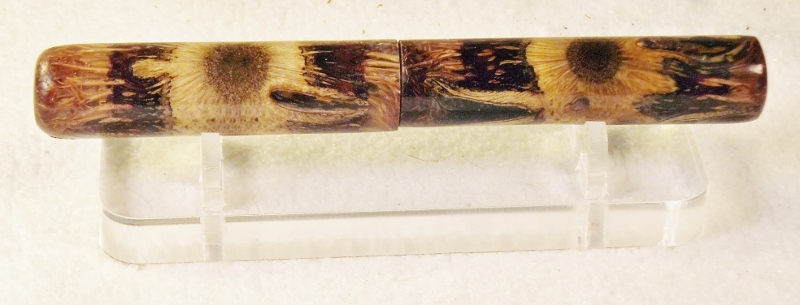

I would suggest using the largest pen kit you can buy. One with a finished diameter of 9/16ths, 11/16ths, or 3/4 inch would do justice to this blank. another suggesion would be to make a double closed end pen any size that you want. Last would be to go kitless and have no limits. Here are two pens I have made using these pods. Jim S

I'm sorry to butt in but, could you point me in the right direction to the post you made for the first pen, in your pics attachments...???
I can't recall to have seen it before or realised that, you went into a more difficult style of pen, particularly with these blanks. I always claimed that, these blanks will allow any style of pen to be made from them however, attempting a full kitless, would require some great experience and careful handling, on yours, I can't see if is a full kitless or you have the threads as part of a pen kit, reason why I'm interested in have a better look at that pen...!
Cheers
George
George: I just posted it tonight. You may have to go back aways in todays posts. No one has commented on it so far so that it hasn't reappeared on recent posts. ( kitless australian banksia pod) Jim S
