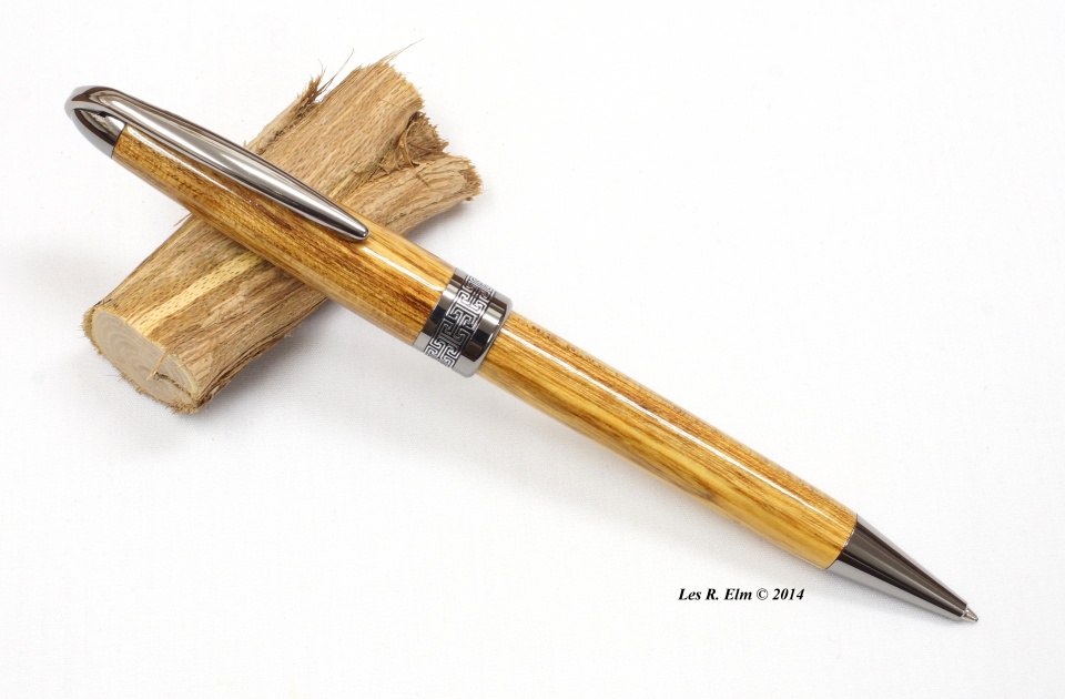

I started using Behlens instrument lacquer with the idea if its used on a musical instrument it would hold up on a pen. One specific property is its flexible. The bad side if you follow their instructions it takes time. I have no long term testing yet as to durability. My blanks ideally require spraying due to their design. The melamine is a consideration. Thanks for the info.
MINWAX WBOM Clear Satin using the Dipping Method leaves the wood with a warm natural feel with an easy to apply, durable finish.
Les
