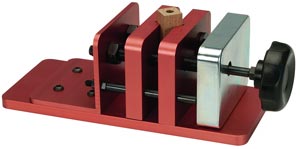

I need some opinions about this tool. I have researched 3 of them and they are shown below. They all seem to do the same thing except for the maximum size of blank they will take. Is it better to get the one for the largest blank? Another thing, for those of you who have the equipment, is there a hole for the bit to pass through the base of the vise or do you not have the base the blank touching the bottom when drilling? Is it best to get the wood base vise that way you can always change the base if you need to? Your feedback would be appreciated. Thanks.

I have the top one as it was the only one out when I got it several months ago. I really like it and it goes big enough that I can use it for my bottle stoppers also. It does NOT have a hole in the bottom. You just set it so the drill does not go through the bottom. I wouldn't be without mine. I have seen many home-made ones that have been made but I still like this the best. You can even use it on uneven or round stock.

I have the Woodcraft one, which looks more like the second one. It works well. I still use my homemade jig sometimes. It is based on a cheap drill press vise with wood blocks that have the V notch cut in them.

I'll vote for number 1. I have drilled literally hundreds of blanks using that kind and also really like it. What I do regarding the bottom is to place a small block of wood under the blank to drill into so I don't have a blank blow out. There are quite a few home made jigs around and I believe they work well but speaking for myself only, my time is better spent turning and making pens. I have serious health problems that limit my shop time so I try to use it wisely.

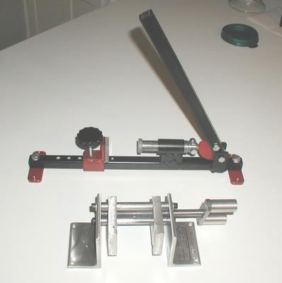

I've owned or used probably every commercially available pen vice and I own the one made by Paul Huffman in Oklahoma city. I actually own 2 others that serve as paperweights. Paul's is the best I've used. Here is a picture of it.

If anyone wants his info, I'll post it this afternoon. He has made me some special tooling and does great work. I love his penvice. Haven't tried his pen press.

Last I heard was that Paul had to take some time off from making his vise's. He will be letting us know when he will be up and running again. I hope that it's soon because his vise looks better than any that I've seen.

I have the bottom one from CS. After using numerous home jigs, what a blessing that was. Drills straight and fast centering, cut my drill time in half. But mine has about scene its last blank, I replaced the plastic handle twice. had to do some rethreading as well.The picture Don has posted looks like some real nice metal craft. I to would be interested in getting ahold of Paul, nice looking tools. The press is neat too. Anthony

Thought I'd jump in on this one [:D] I have not made any new vises or presses of late. Still trying to get a full nights sleep with the little one (now 7 weeks old!). Hope to get back in the groove soon. thanks,

As for the vises, they are $65 which includes shipping. The weight is about three pounds in the box. The press is $50, which also includes shipping. Thanks Don for posting a pic. I am going to try to put a pic in the photo area.

Gary, I don't have Paul's vice, but one thing I see that would make his better then the others is the location of the v-groove. On the others there two screw/bolts on each side of the groove that limits you to the size (thickness) of blank you can drill. Another thing I like is that it would be easier to clear the wood shavings because it's open. It really looks like good setup.

I agree with R.T. The other vises are limited to the size of blank because the v-groves are between bolts. I have one like #2 and 3. It was knocked off the workbench and the round tightening knob broke off. The bolts have come out, the nuts have come off, the thin coverings over the al parts is sharp....but Paul's vice solves these problems. It will handle large blanks and for me, is worth every bit the price I paid for it.
