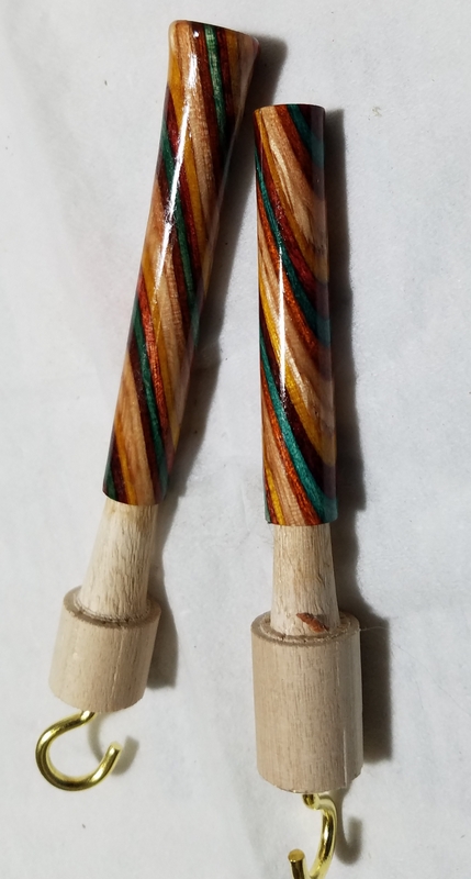

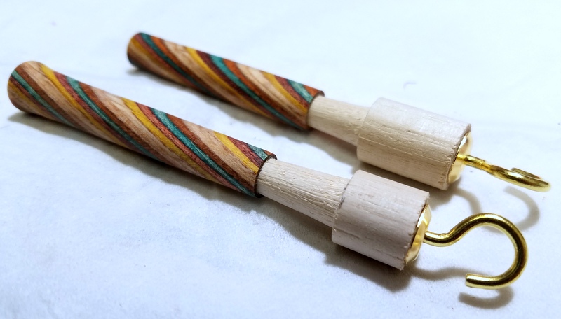

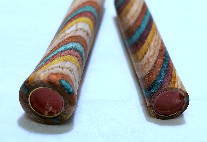

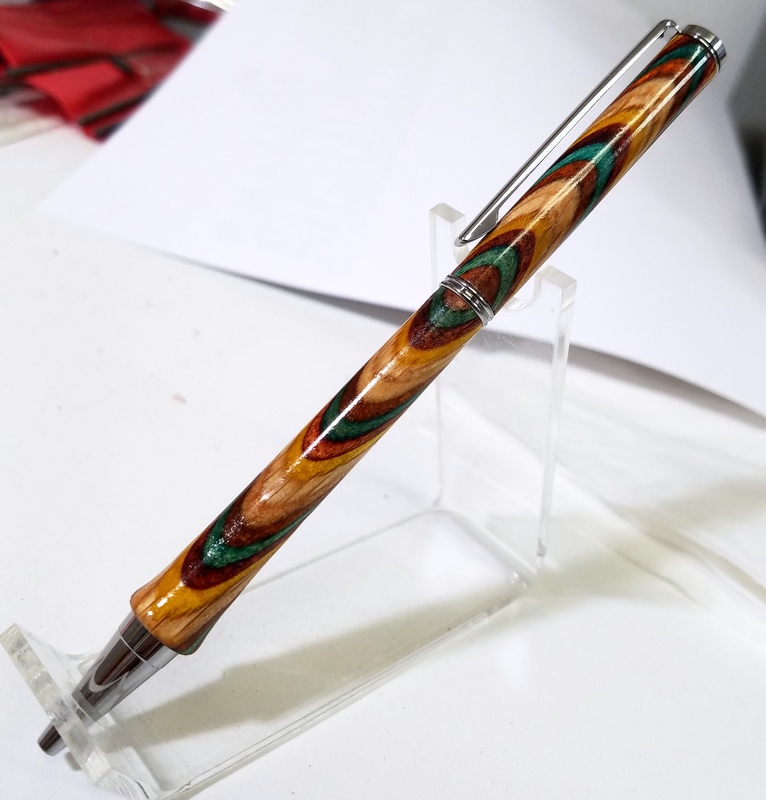

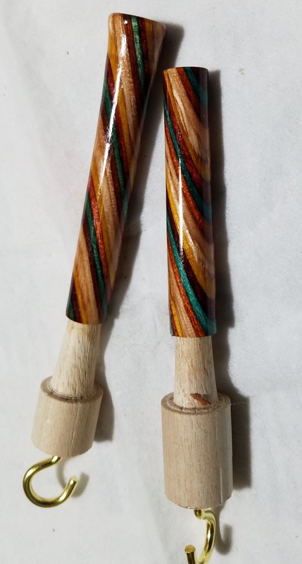

I just finished assembling my first dipped pen. I turned the blanks and sanded with 180 Abranet radially with lathe running and horizontally with the lathe stopped. I then did the same with 400 Abranet. I plugged the ends, dipped them and hung them up to dry. The temperature in my shop was about 50 degrees. I don't know how much that affects anything but they dried for two days before assembling. I only dipped once. I should, perhaps, have gone over the first coat with steel wool and given a second coat. Being in a hurry and not wanting to heat the shop I did not. There is a small blemish near the nib. Am not sure what happened there but overall I am satisfied. I will use it as my every day carry pen.

I had the same issue with the same product. Les switched me to water based oil modified polyurethane since it dried quicker. That did the trick, I think you could do the same with wipe on poly since it is thinner.
One modification that I made was using a synthetic wine cork instead of the wood as a plug. It's a little more pliable so it grabs better.

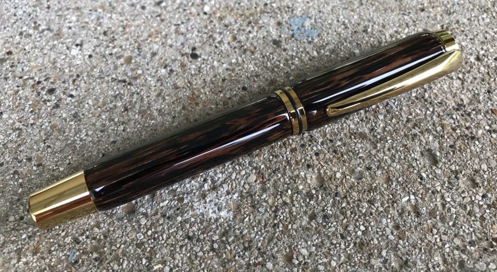

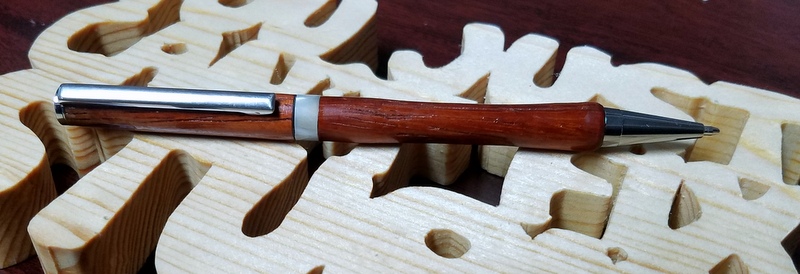

I'll answer in a couple of years. This pen has been daily carry for two years or longer. It has a poly finish.

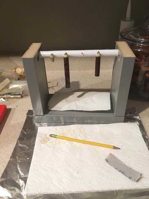

Here is my quick and dirty finishing station in my laundry room. The nice thing about poly is that it is low odor, so I can dip my pens indoors and not have to worry about temperature.
The blanks are held by synthetic wine cork with screw eyes.

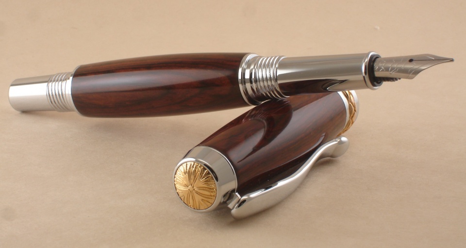

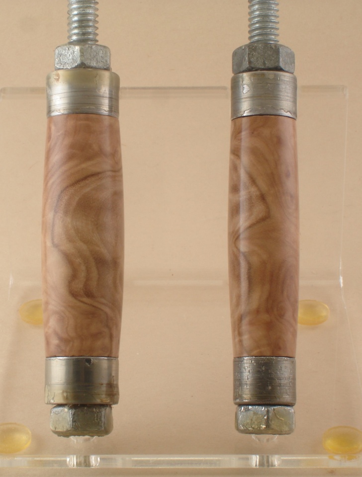

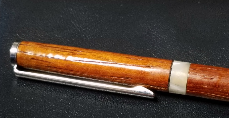

Just saw this post so I figured I'd add my $.02 as I haven't posted in a while. I started using a dipping method similar to Les Elms method that can be found in the library. I've included a few photos, my bushing setup, the product I use and the finished product. The Cocobolo pen has sanded and leveled using a sanding sealer and then dipped twice, rotating the blanks after the first dip. Any other questions ask away, thanks
P.S. My drying setup is similar to the one in the photo above.

Looks good. Do you have any issues with the finish building up at the seam between the blank and bushing? Also how do you remove the finish from the bushing itself?
Thanks.
Check out Les Elms dipping method in the library for some photos. I sort of do the same thing with the paper towel, I just dab the blank a few times on the towel to wick off some of the poly. This allows the finish to run down off of the bushing a little better so there isn't really any buildup at the seam. I don't really get any of the finish off of the bushing, the nut won't come off, but will unscrew from the bolt so I can use it again. Eventually you'll have to get new bushings, hope this helps,
Bill
