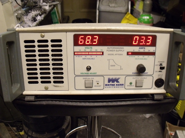

Here's my power supply Brad. :biggrin: Think it'll work? It's pretty old but works well. I used to use it years ago to test trip coils on HV circuit breakers.
All I need now is time to play!!!:frown:

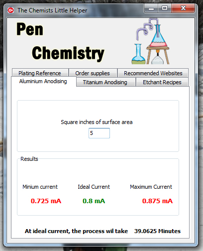

Ive added a download section to the site where members can download all the EPS files ive used in my products should they want to have them cut out in vinyl themselves.
Also, my Chemists Little Helper software is nearing completion of Verion 1.0, which will be available to download for free from the site.
