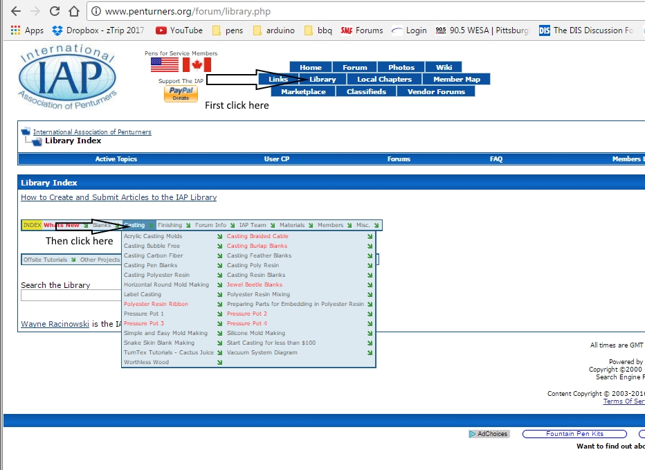

Try this.
There is a whole forum titled Blank Making and a sub title called casting blanks.
You can spends months here just reading on this topic. Have specific questions check back here. But no one is going to tell you how to cast blanks. Done many ways with many different materials. Good luck.
