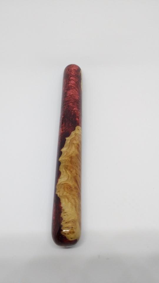

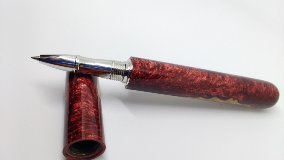

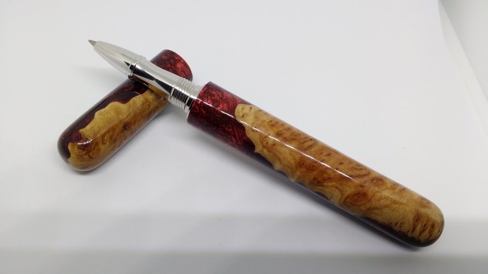

First time posting pics so hope it works.....
That's the other pen I made him, plundered a kit as he wanted chrome section and I don't have metal lathe. He wants similar, but in purple with mallee and not a screw cap. I was going to make the section myself this time as he doesn't care if it's metal or plastic.
