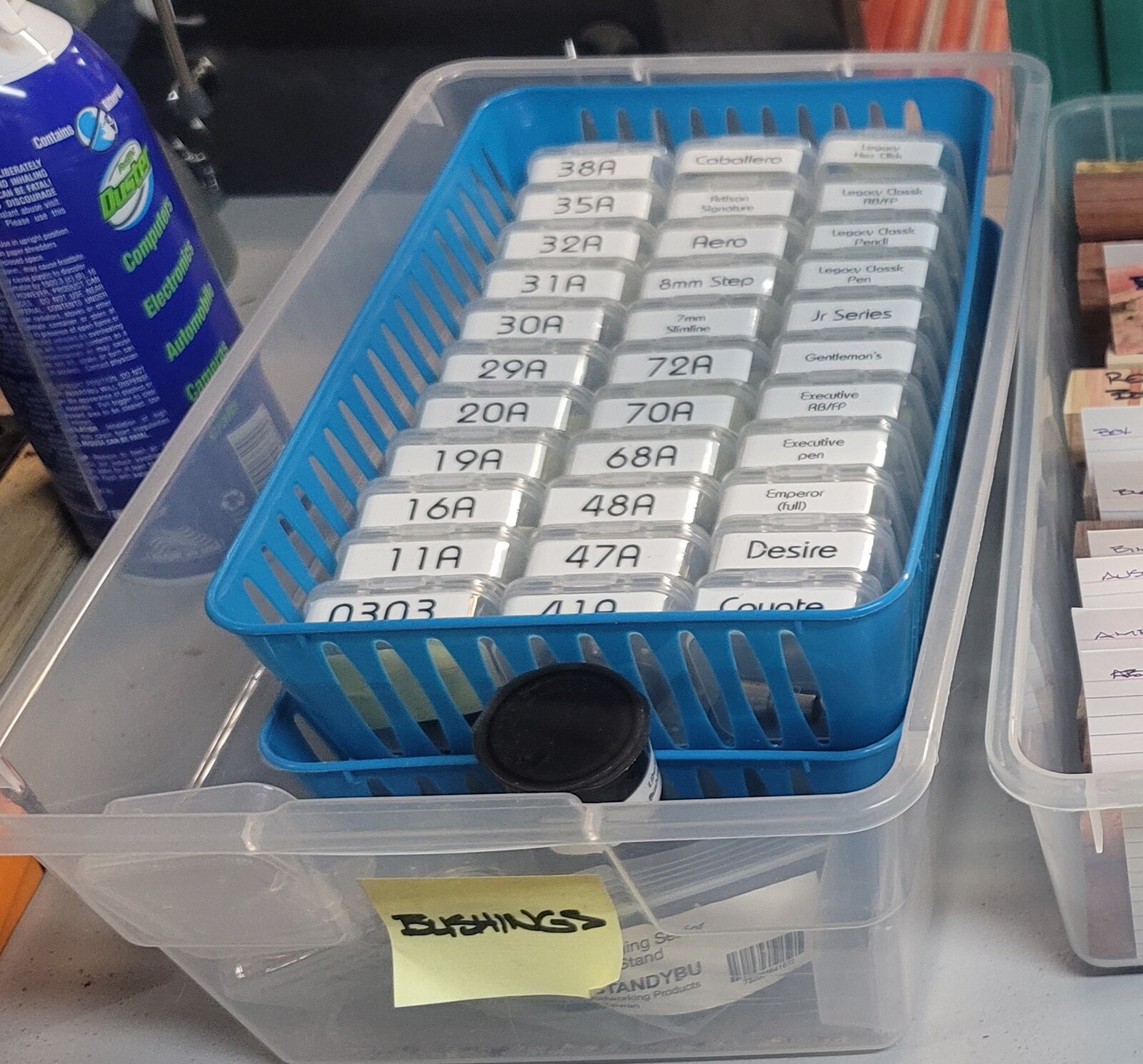

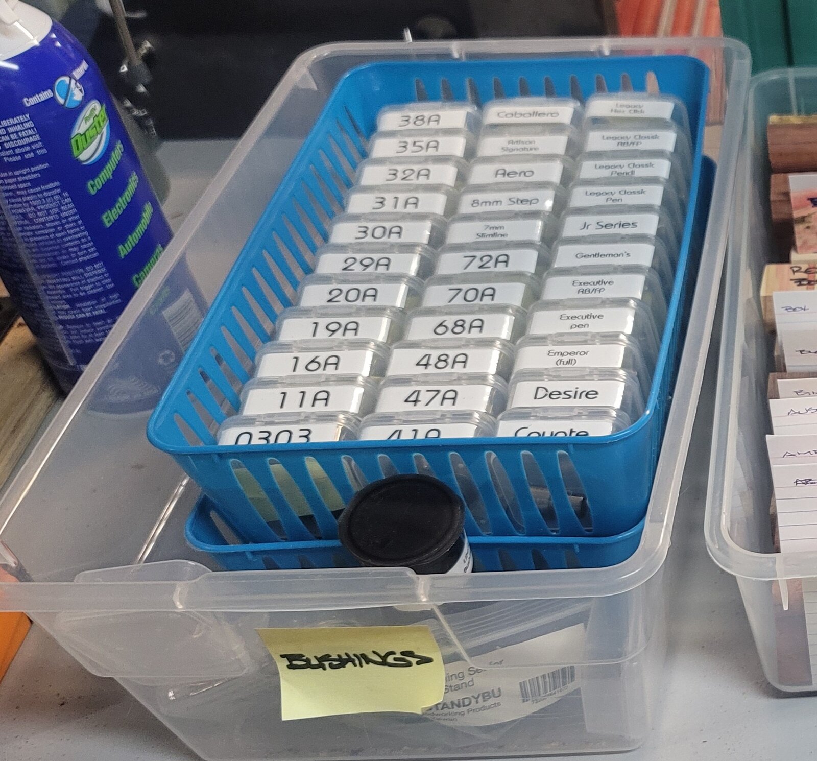

Small plastic containers from Amazon fit on set of bushings perfectly, labeled with Brother ptouch

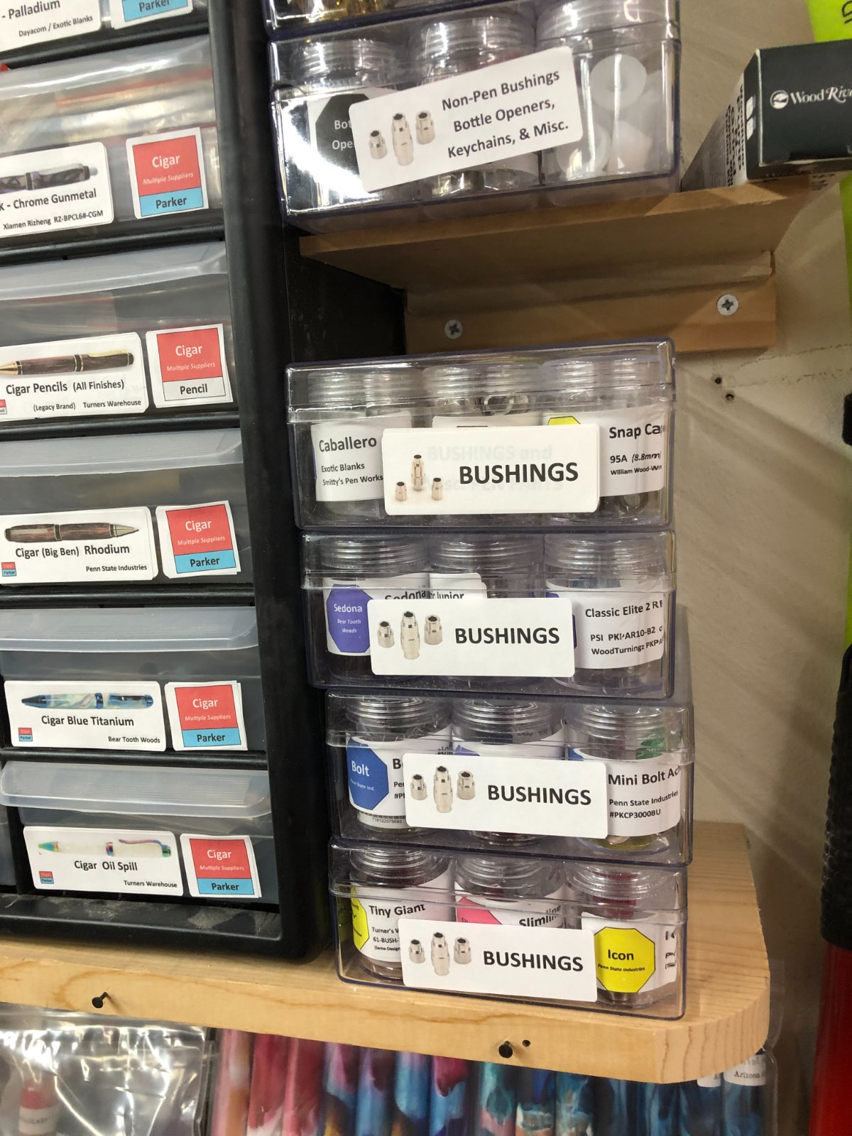

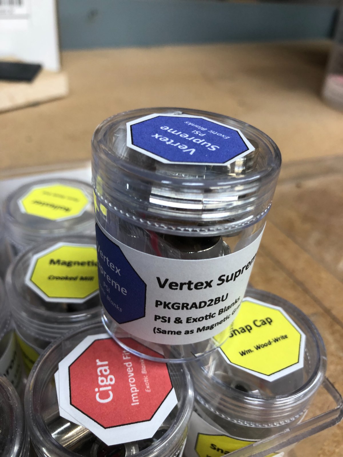

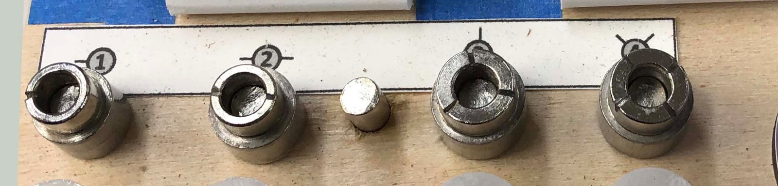

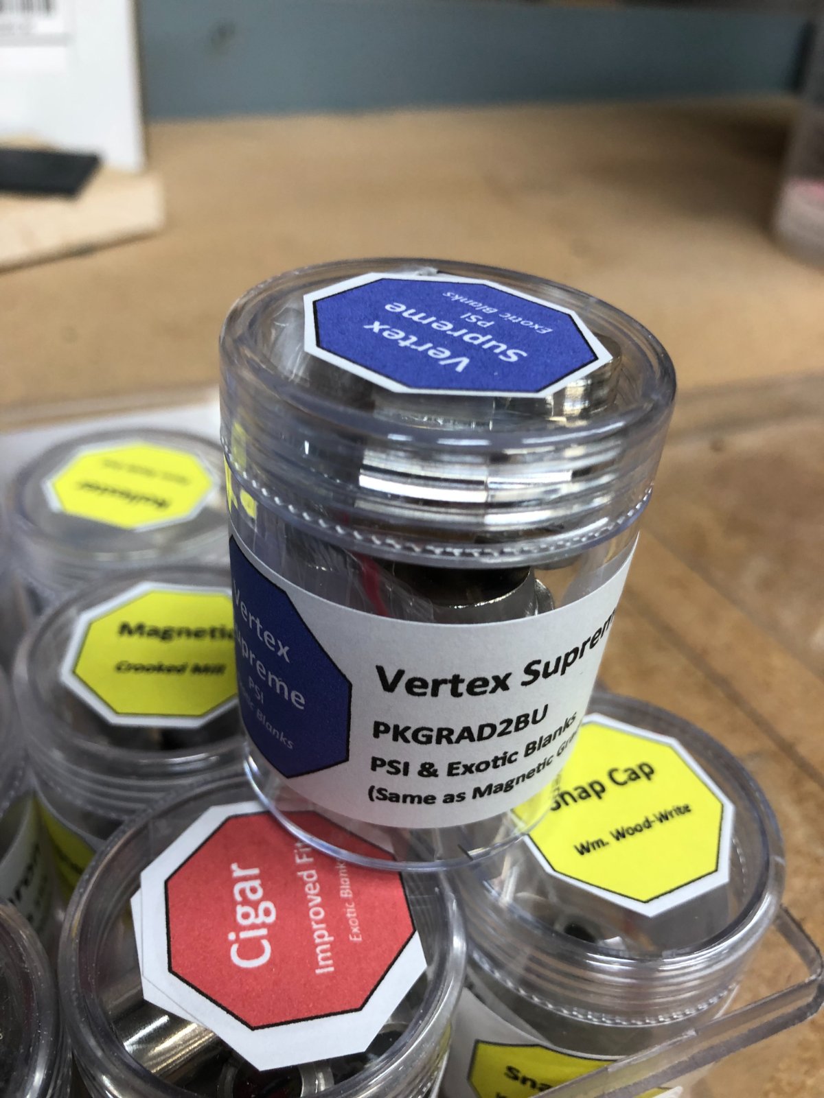

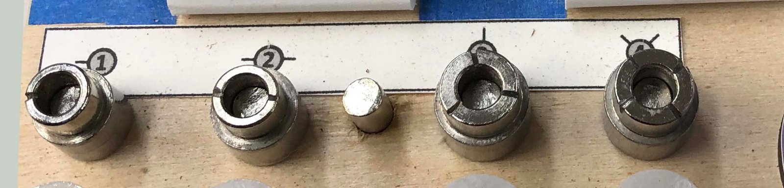

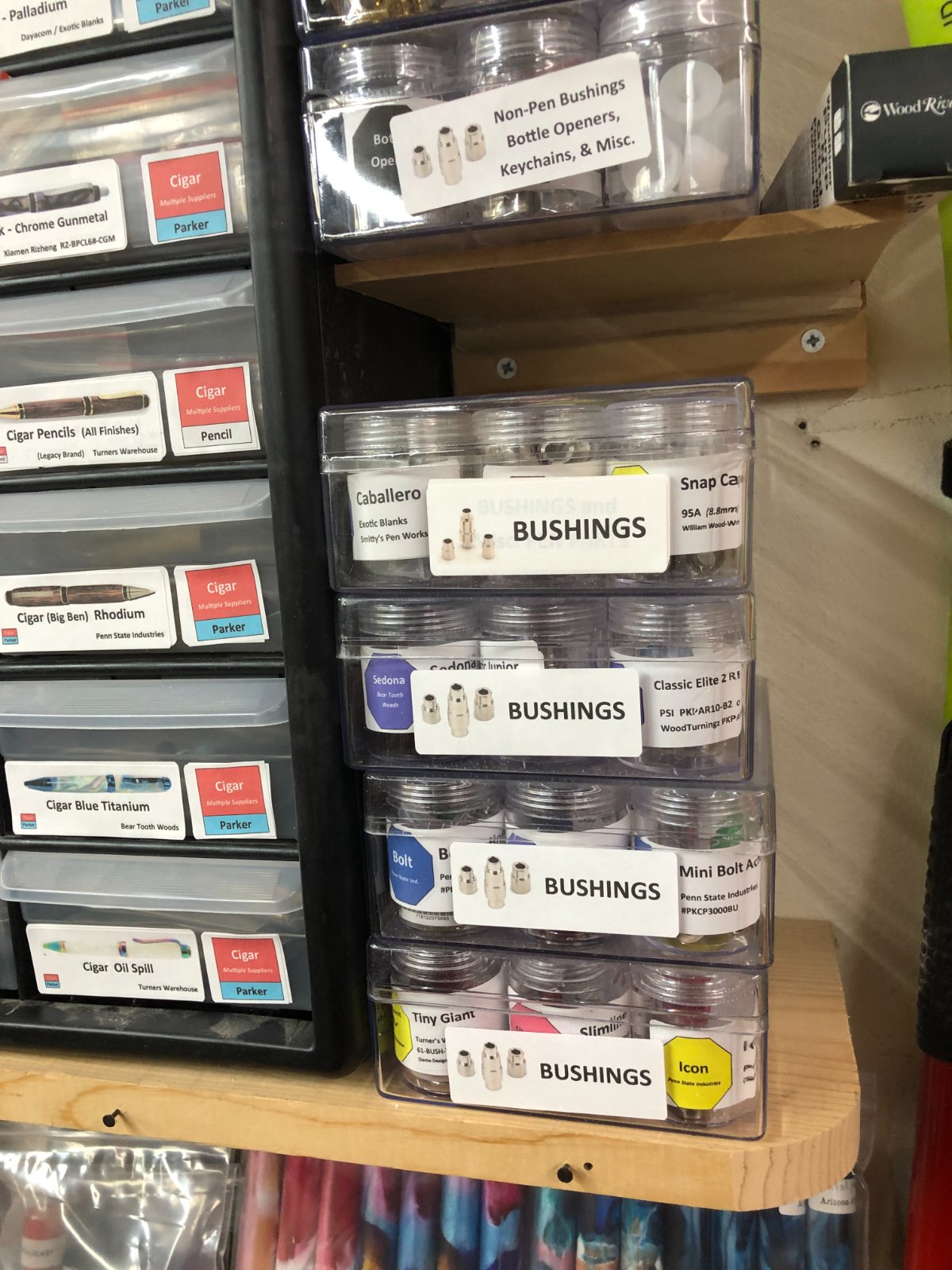

I use small plastic jars with screw on lids that come in a larger box (12 jars per box). I keep two sets of bushings for each type of pen in a jar, a working set a new, unopened bag. (I also color code the jars according to kit styles and label them so I can easily locate the bushings for a particular kit). I use a Dremel tool to mark each bushing with notches to help me keep them straight without having to measure them each time (one = tip, then two, etc. with four = cap/finial).
If I didn't already have a system I would consider doing something like you did, but with 1/4-inch bolts and wing nuts to keep the bushings captured. I would probably try to also make some kind of holder for the bolts to keep everything organized, maybe using rare earth magnets to hold the bolts in place or something.
Bob Blanford, aka RJBWoodTurner also made an interesting bushing storage project using a drawer and plastic tubes. Here is a link to it:
Regards,
Dave
PS I also use the same color coding scheme to label the drawers/bins that I keep my kits in which makes it easier to match up the bushings to the kit.

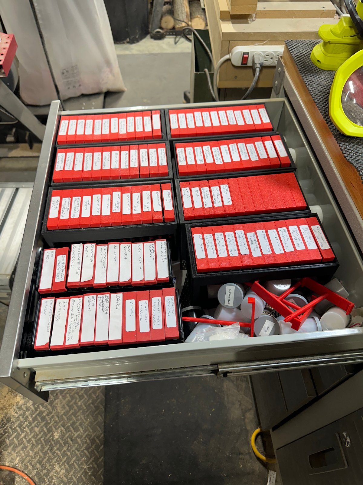

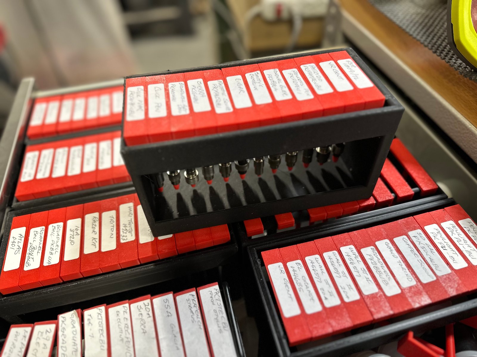

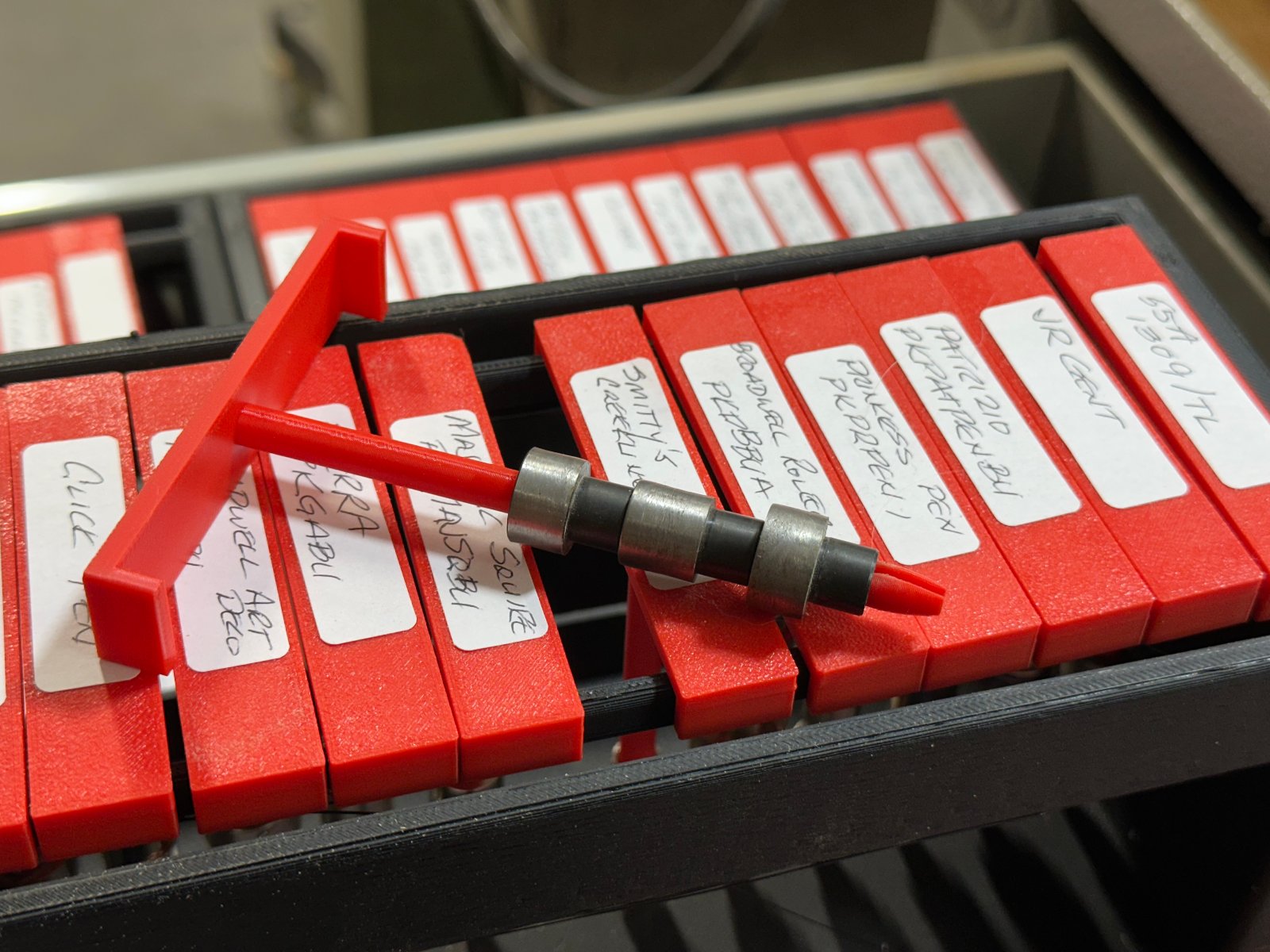

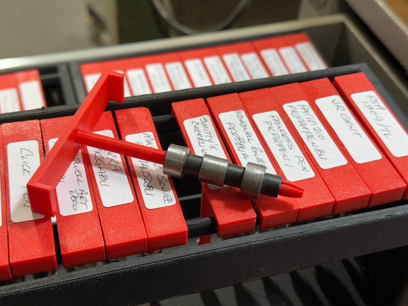

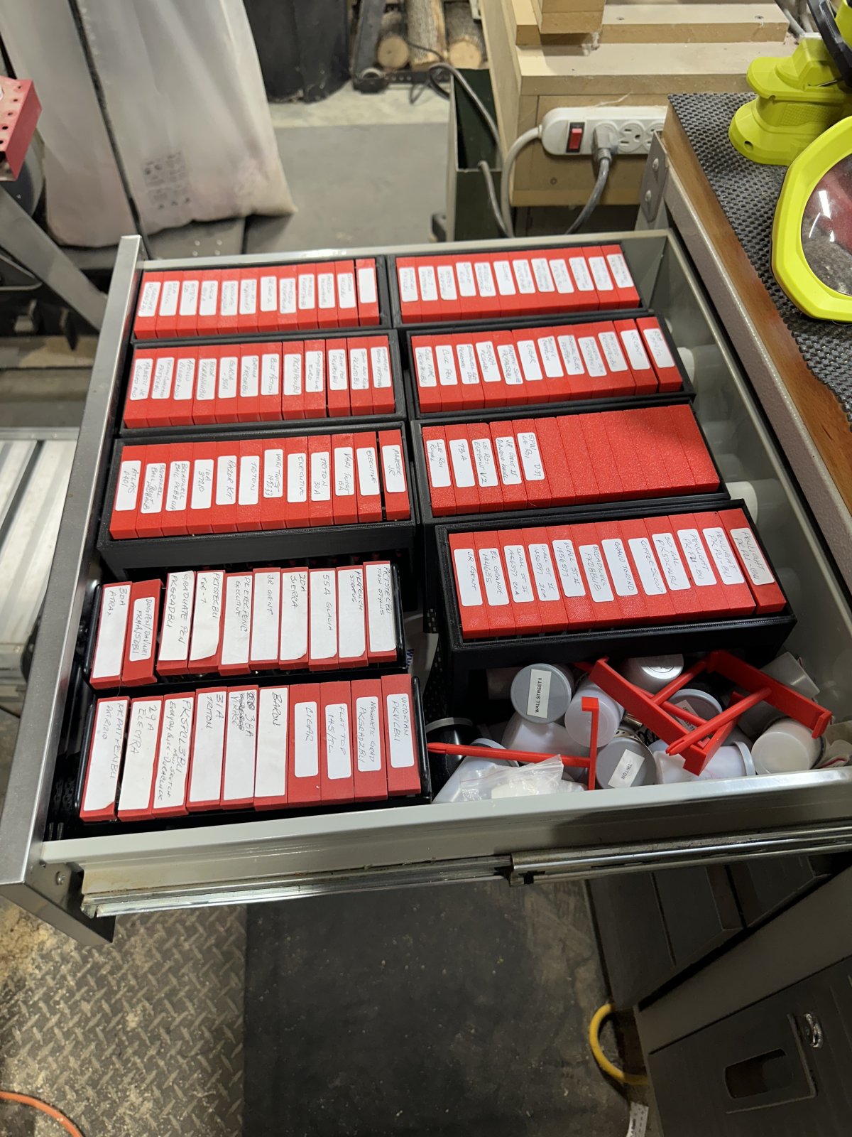

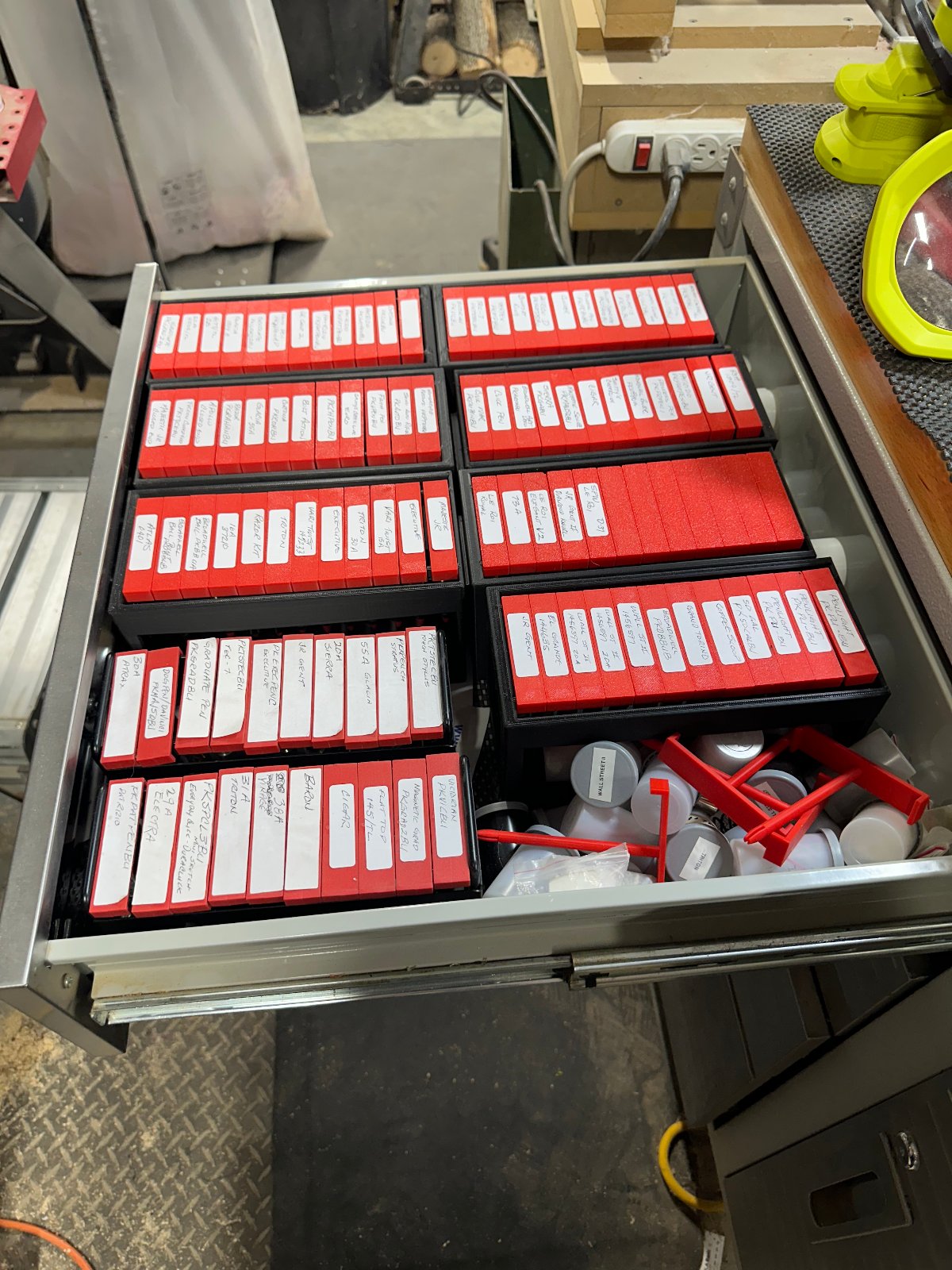

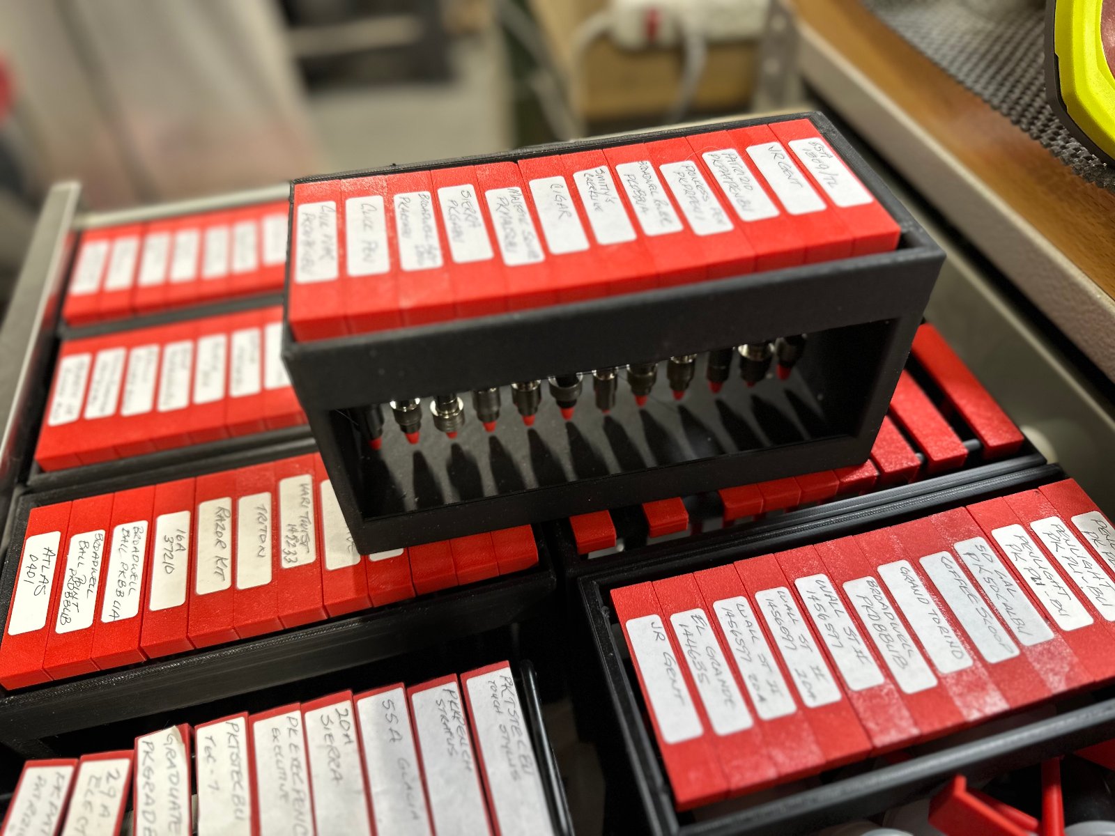

Thanks for asking JT...Here are some photos...these used to be available on Penn State...not sure if they still are...these are a little more delicate than theirs...I could use a different filament, but more $$$ for a spool...and I had this. I have been making pens for 20 years and I have a lot of bushings, and I am not into throwing stuff away...

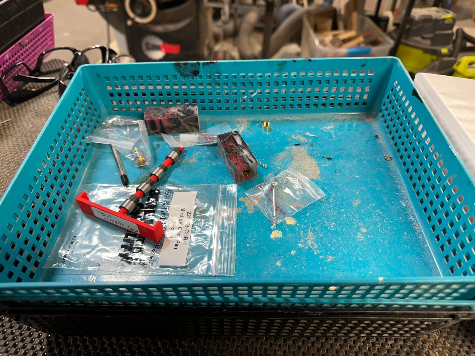

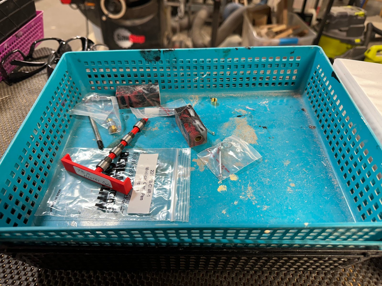

The last photograph is the way I make my pens...I owned a camera store/studio/ color lab/repair facility...I have a bunch of these trays left over, we used them in the color lab and camera repair area. Now they are used for my pens and each contains the blank, kit, instructions, and bushings.....I make about 20 at a time...One pen per tray...all acrylic...it takes me a couple weeks to do it all... and I am not really working that hard at it....I paint the tubes and inside the blank, I drill, paint, and turn the blank down to close to the bushing on a metal lathe...I can take off almost a 3/16" per pass, then put onto my wood lathe and turn to shape and sand to 400...then buff to finish...then a little ren wax by hand and assemble....while it sounds like a lot of messing around, when doing 20 at a time you can really get them done faster. I also usually have a segment or two going at one time...they have their own tray and are usually all wood. It works great you need to have organization. to make that many at a time.

OK Mike. Now I am not the brightest lightbulb in the package. Have to say I never seen this method and I have seen a ton of methods over the years here. I too have a ton of bushings and need to someday organize. I have bought various small packaging methods and latest those squeeze bottles which I think will be the final method I like most. These are the type that Turners Warehouse ships their bushings in. The thing is I have many sets that I have 2 and 3 duplicates and those bottles will handle them I believe and handle any size. Just need to make some time. Not sure when that will ever be. Thanks for the photos.
What I really need to also do is make a list and and file it plus make it so I can print them out on sticky back paper to adhere to those jars. A label maker would take up too much tape and that gets expensive.
