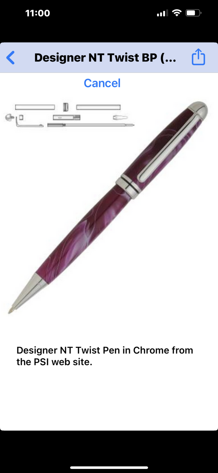

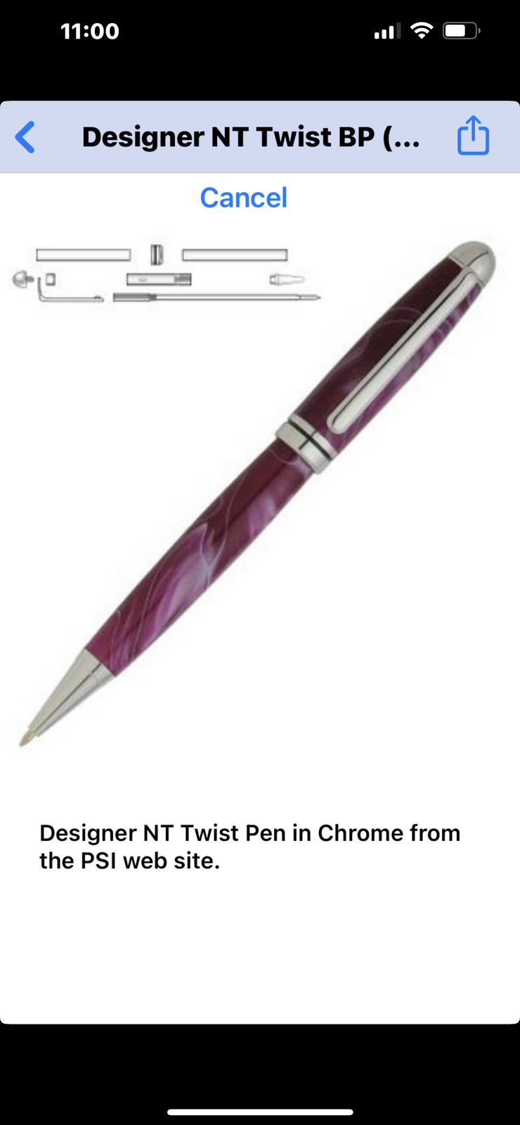

Possibly a Designer Twist BP - it has tube lengths of 2.38" & 2.13"
That's an older kit that required turning a tenon at the end of the 2.13" (upper) blank. The newer version is the Designer NT (no tenon) that uses a 2.03" upper tube.
Instructions for both are in the IAP Bushings & Tubes App. Here's a photo:
The Father Sing tubes are a little shorter, but those blanks would work as has been pointed out.
There are also several other kits that would work if you can find them: Surfix (Berea), Oxford (PSI), KC (CSUSA) - those all have a metal upper cap and have a single lower tube that's 2.36" or 2.37" long. The Oxford & KC have been discontinued - not sure about the Surfix.
