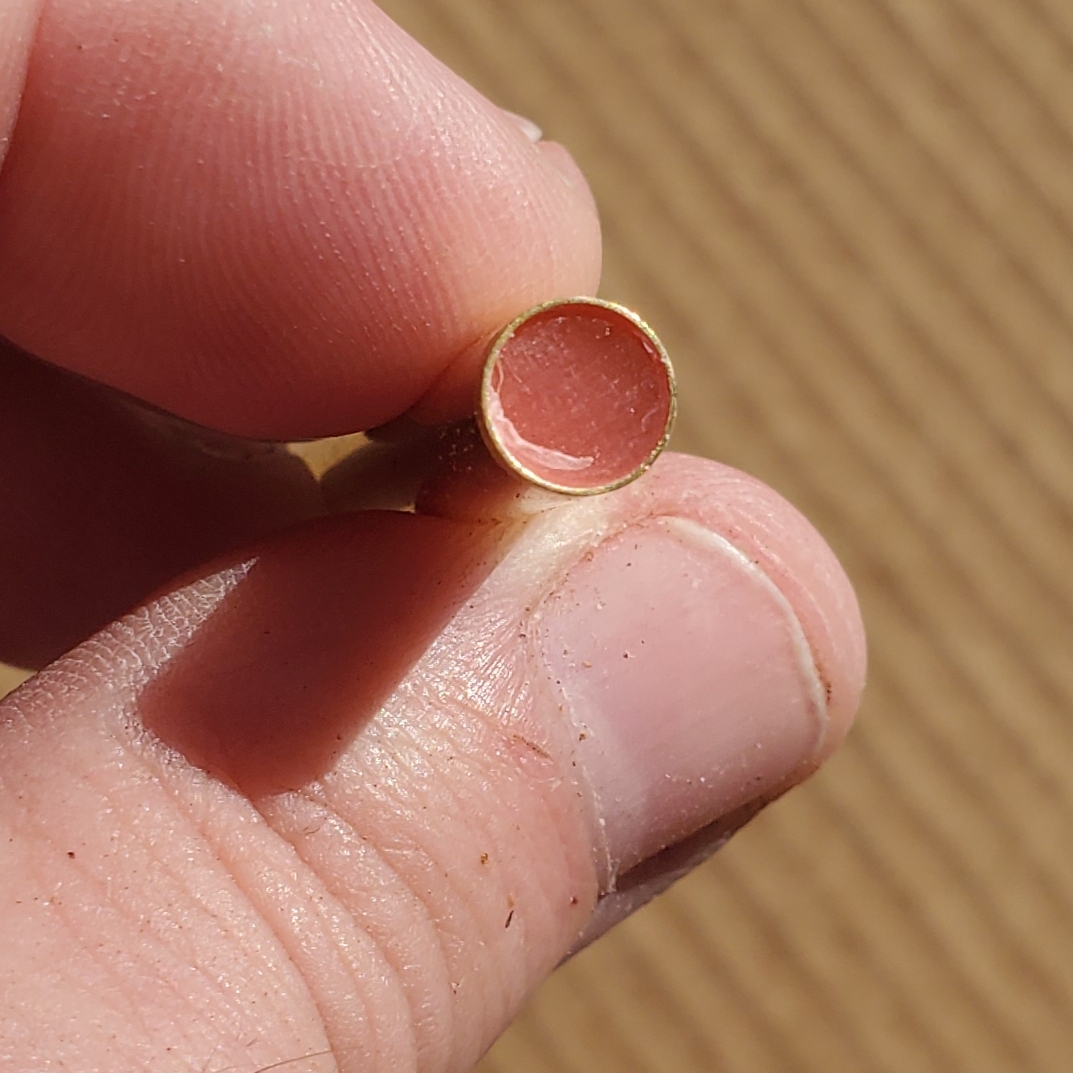

I thought I'd pass this on... This is a subject that may have been addressed in the past dunno... I know that we all know to "rough" up the tube before glueing... But what about the ends of the tubes. I personally prefer putting Dental base plate wax... (Found mine on Amazon) I put it on the ends before gluing the tube in the blank. So excess glue dont go down the tube. After glue sits for 24hours (I do several at a time so glue has plenty of cure time). Next, I Don't use a pen reamer some kits are so perfect might cut down the tube = wasted kit. I simply sand down to the tube so wood and tube are square and flush. After this I use a dental pick to remove the wax ready to turn... Just what I do any other suggestions... I like new ideas and just thought I'd share this one..
