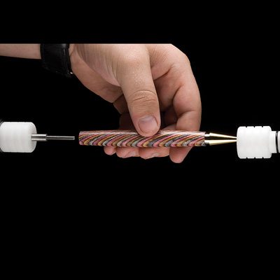

As for assembling,I made a set similar to this:
and love it for assembling pens by turning the MT2 and flat press area out of scrap (doesn't have to be a perfect MT2, as you will not have your lathe on when you use them!!!:tongue:) It gives you MUCH more precise control over how far you press things in (great for those 7mm transmissions in odd sized barrels...) than any of the hand presses I've used...

I saw a really awesome home made pen assembly tool I might try to make as well.
I just put together my first pen the other day and boy... it didn't take me long to realize it might be worth it to have a more precise tool because it is a lot more difficult than these simple youtube videos make it look. They are pros after all!
