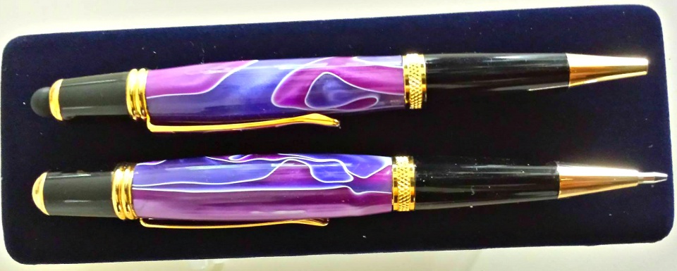

I used the pencil adapter from Schmidt as well to make pen and pencil sets. I have used Wall Street 2 and Sierra sets. Both worked well. There was only one issue that was easily resolved using the directions in the library to drill out the transmission to 3/32. It is not even really drilling as I simply used the drill bit in my hand, so obviously the material I removed was very minor. I think any pen that uses a Parker style refill could have the Schmidt pencil adapter installed to change to a pencil.
The only issue is an eraser, which I have not figured out how to do with this conversion.
This is the pen and pencil set I made my Mother for Mother's day
