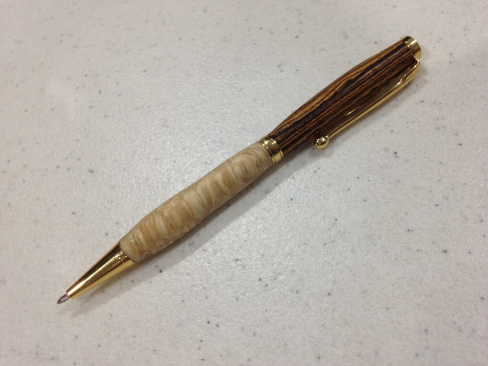

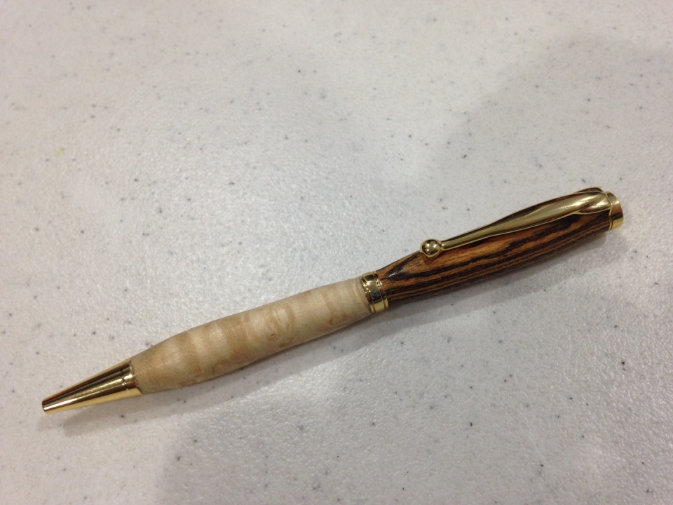

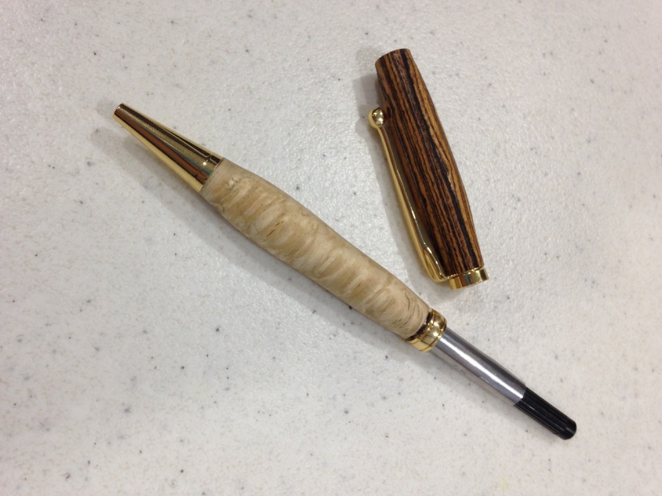

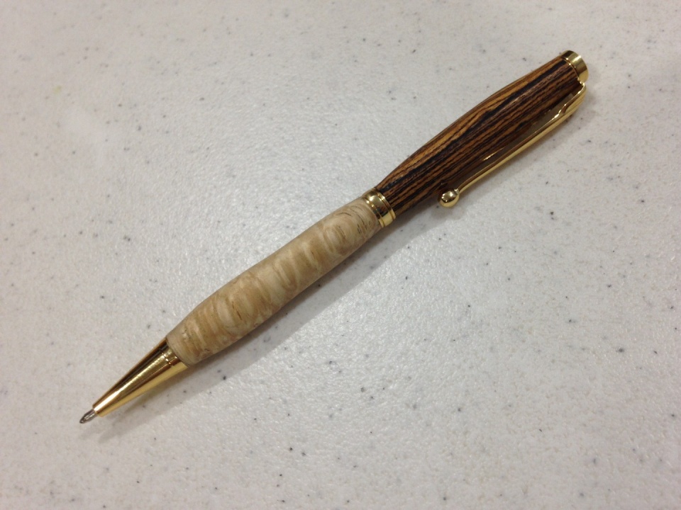

Pen #1 - Slimline Ballpoint
Kit: Apprentice Fancy Slimline - 24k Gold
Blanks: myrtle burl & bocote
Finish: Mylands Friction Polish
Let me just say, turning my first pen was such a great experience! The bocote wood turned like butter, but the myrtle had a little bit more difficulty. It was definitely an interesting time. I was debating a CA finish, but really I wanted to try the Mylands my first time.

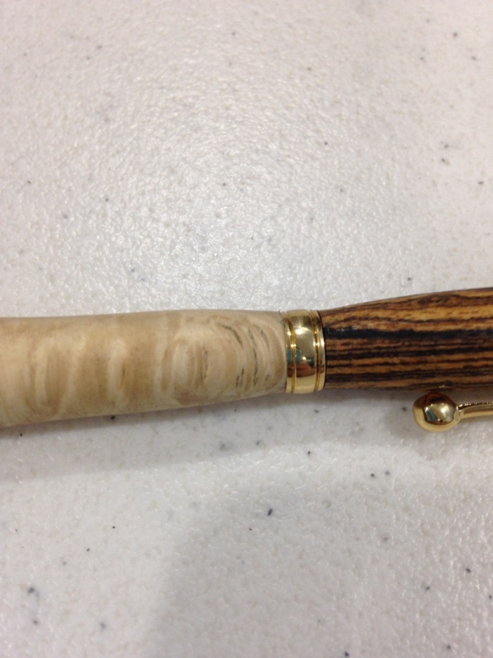

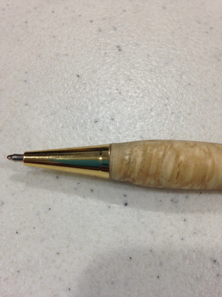

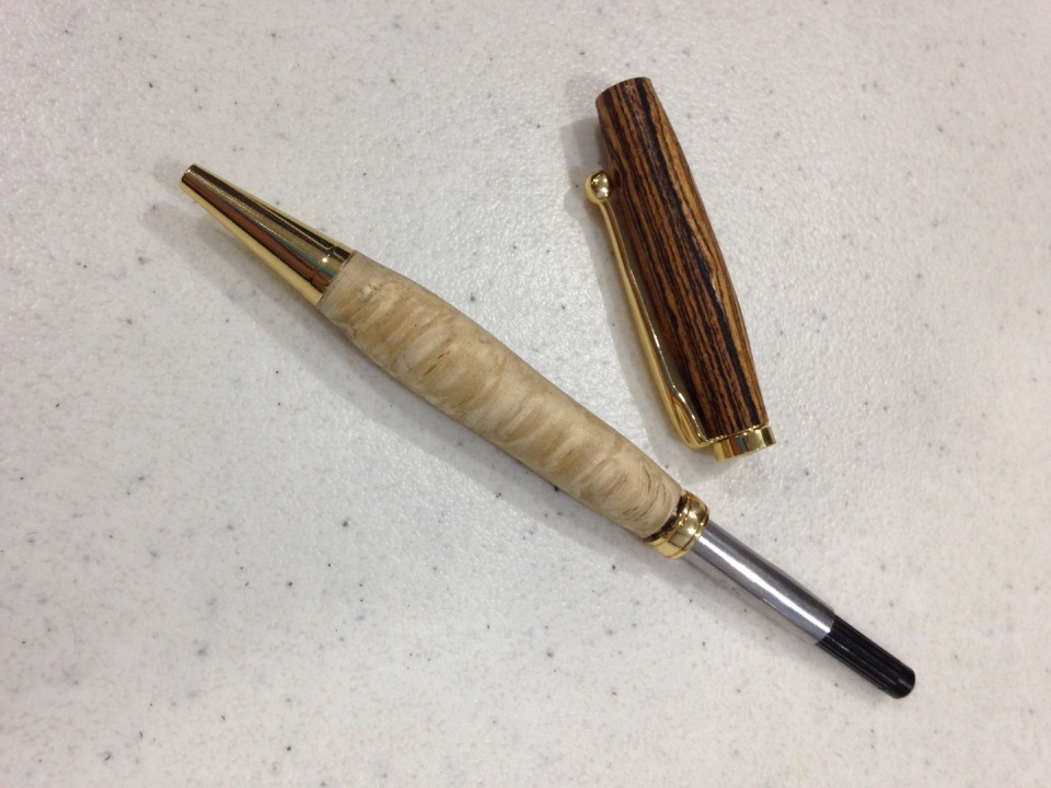

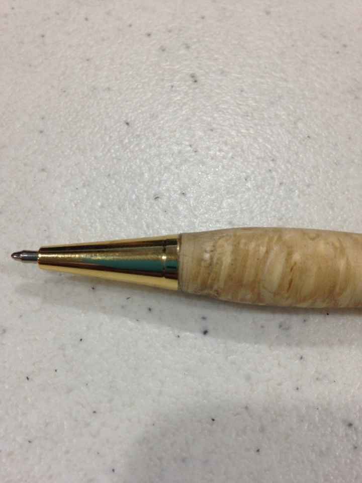

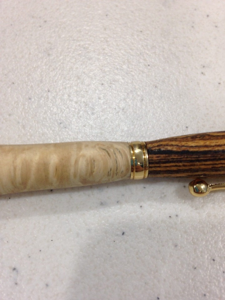

After tinkering around with the pen, though, the myrtle did get little stains towards each end. Gosh darn fingers, always getting in the way. The wood, otherwise, was great! My big complaint is the slimline kit. It is entirely possible that I did not put everything together right, but the twisting mechanism stopped working after assembled. I ended up pushing the ink cartridge down to the bottom so that the pen can at least be used, though now it cannot be retracted. This is my first pen, so I will keep it as a showpiece, I suppose. Learn from mistakes.

Avi, Very good for a first!
Consider this a continuing learning experience.
If the transmission is indeed faulty, it can be disabled and a new one pressed in.
As for dark ends on the light wood, it may be first, sanding dust from the bushings which inbeded in the wood.
Next is the brass tube showing through the thin part of the blank. Painting the tube can help here.
Good luck in a repair or your next pen.
You should always keep you first pen.
The wood combo is interesting. Looks like your fit is spot on.
Wipe the blanks between each change of sanding paper or micro mesh. This will stop you from carrying dust from one to the next.
Looks like you did a great job.......keep it up and post even more.
I know this may seem like a really stupid question but I did it once while not paying attention to what I was doing and ruined a cartridge and twist mechanism. By any chance did you press in the transmission (twist mechanism) with the refill installed in it? If you did then that was the problem. If you didn't then I am still the only one that has ever admitted doing that.
Nice first pen !!! . I like the contrasting wood colors.
Changing the transmission is not a very big deal if you have a spare one. It would help to have a transfer punch set ... you need only 2 of the punches at this time, but it is handy to have the whole set ... about $15 from HF. Be sure to ask for help with the process of replacing the transmission if you go that route.
You know, I think I may have for just a second. I'd already pressed the twist mechanism in what I calculated as "enough" but then found it was just a short distance shy.
I think I'll start looking into that. Thanks!
And thank you everyone for the compliments! I was actually going to make the entire pen out of the myrtle burl, but the glue didn't take in one end and the tube slipped down while I was squaring making it a little bit too short, but after thinking it over, the bocote drew my eye. :)
