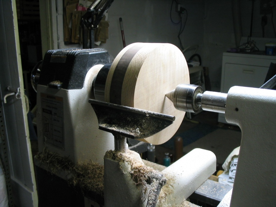

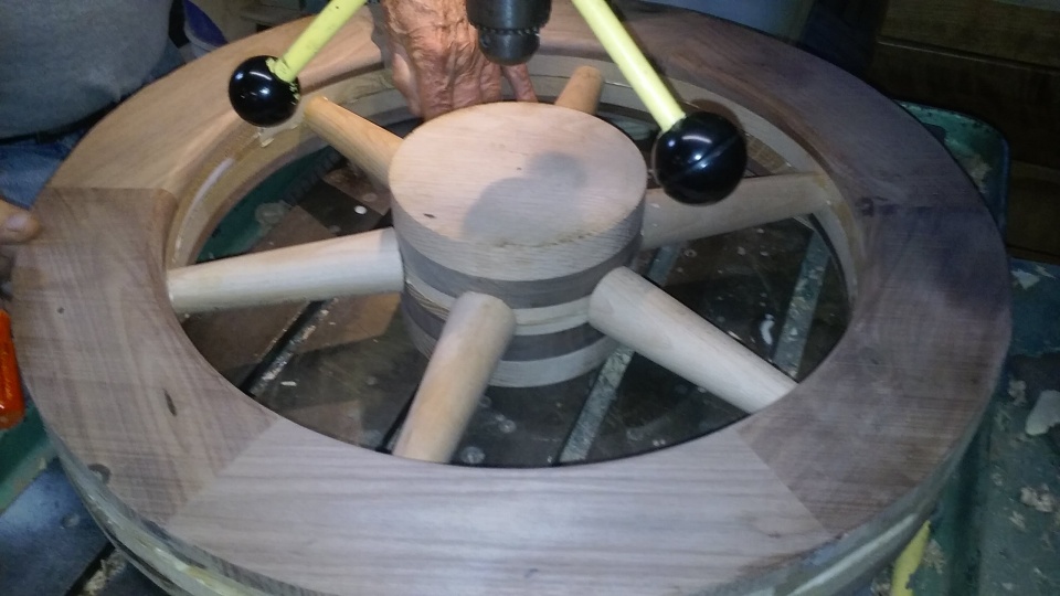

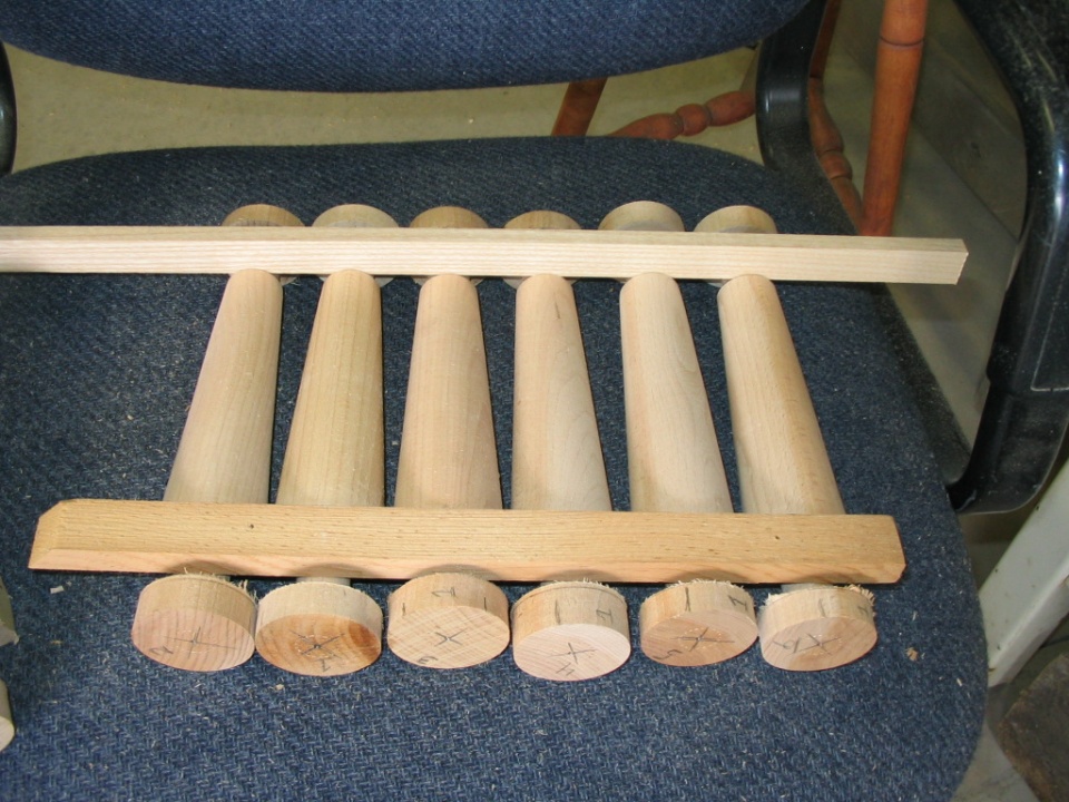

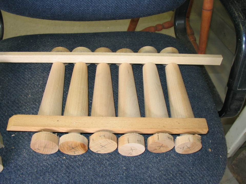

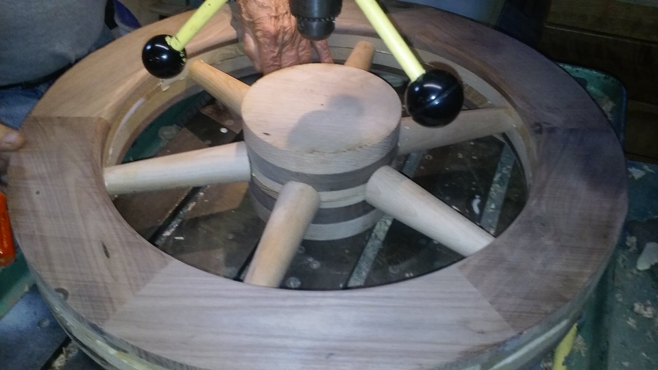

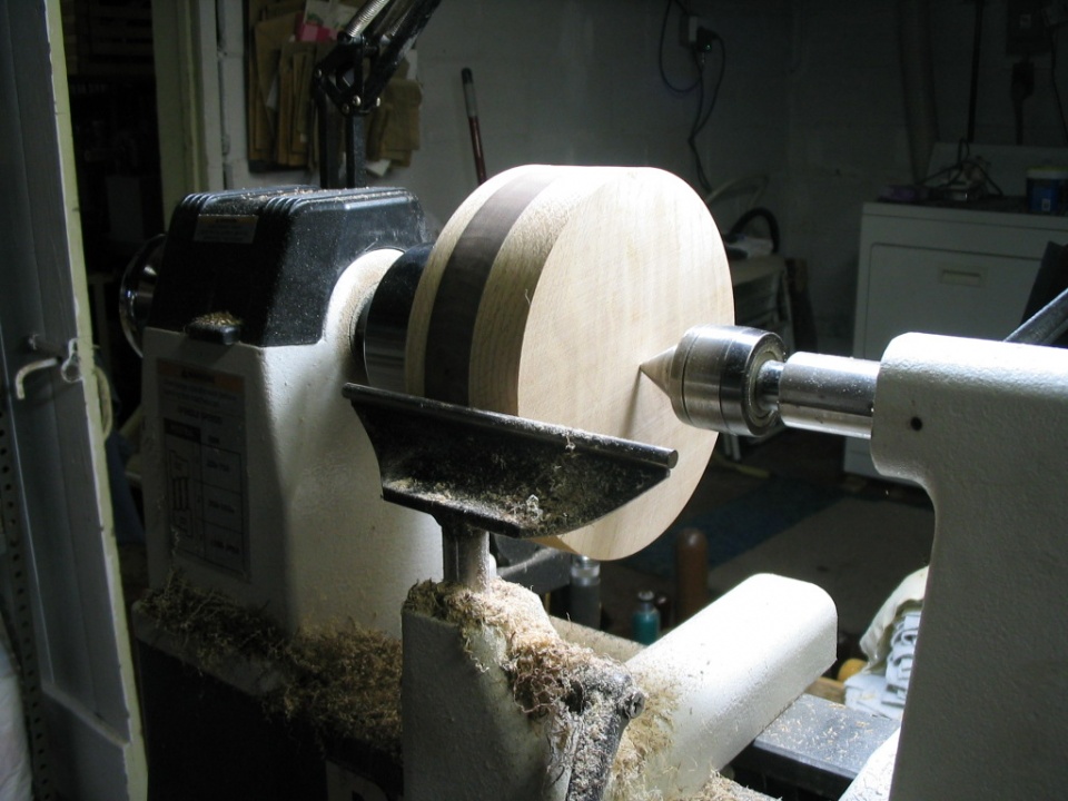

Thanks for the compliment Tom. I have built the center hub and turned the spokes. There are fourteen Club members making parts. The current thought is to sell tickets and have a drawing at the Paul Bunyan Festival. dogcatcher that is pretty much the same lathe from Fine Woodworking. We used a one inch shaft and threaded it for a chuck. The tailstock incorporates a quilt from a Nova Comet large.
Treadle Lathe

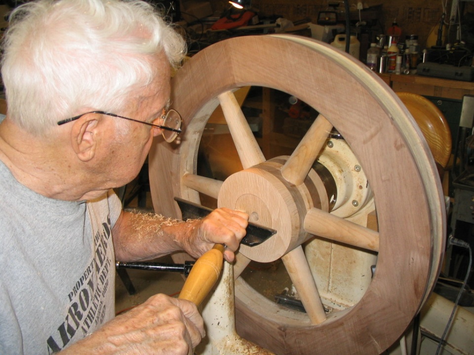

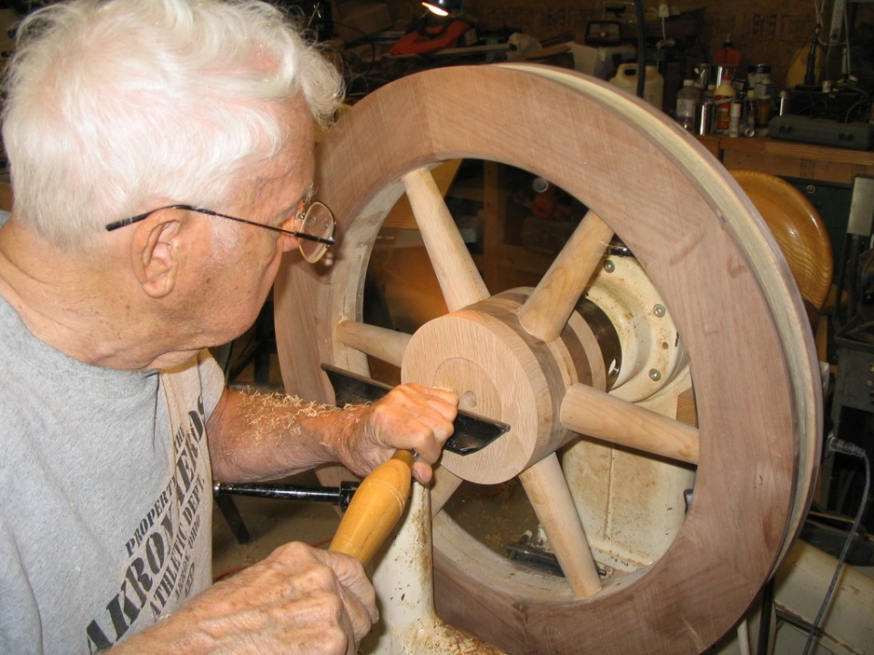

A couple pictures. The Gentleman turning the flywheel in the last picture had his ninety-first birthday yesterday.
