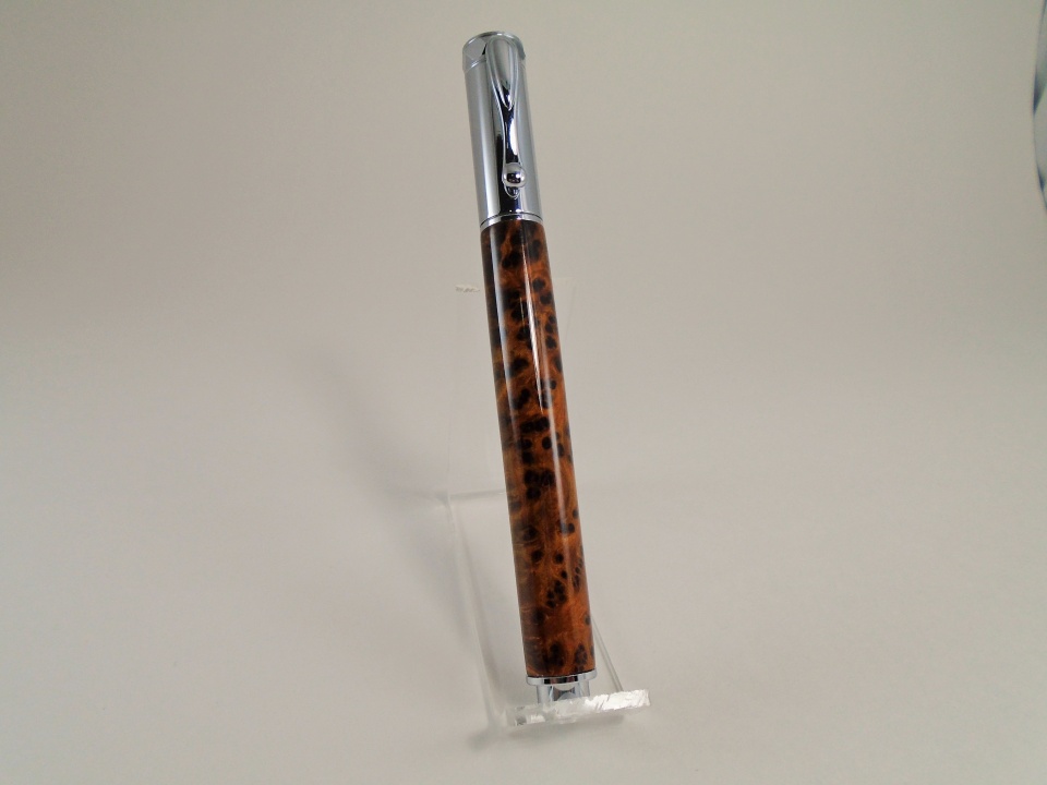

First Zen (making my way though my bucket list :-)).
  • Pecan blank
  • 10 Coats of thin CA (BSI)
  • Sand to 600 Abranet
  • No MM or wet sanding. I tried something new thanks to TheWishMan and MackC (from Canada) introducing me to some Caswell buffs and compounds (even learned how to turn a 2MT).
  • Meguiars 105, 205, and Rejex.
Welcome to say what even you want. I think the lens of my camera had something on it, but it did not get in the way of the pen.
Thanks for looking.

Thank you. I forget to add that my last three steps are always the same: Meguiars 105, 205, and Rejex.
Thank you Chris...what did I call you 30 times in two weeks? And that was alternating between you and MackC on Skype! You are both super guys. Thank you. I am going to build another set of buffs tomorrow (with the strings buffs this time).
This method will be my "ticket" out of wet sanding on CA; I fail (with a cloudy spot 20% of the time)..I had enough.

Tony great looking pen. Zens are great kits... Is that pecan a burl? Beautiful and I'm interested in your new finishing schedule as well
Thank you. I am only sure that the packaging stated pecan. It was also only $3. I thought I would try it given its figuring and price. It doesn't look.like any of the Amboyna that I own. I also stink with a camera. :smile:
This process was not my invention. Chris c and MackC shsred their buffing process with me and I emulated it. It was nice not to wet sand. We will see.

Getting back to the blank - the packaging said "pecan". I may have bought it from Ed (Exotics) months ago. Or one of the three stores near me that sell pen blanks. I will take more photos later and rotate the blank.

Thanks. And I checked Ed's site and he had some nice spalted pecan, but I didn't see what I had. I am going to check Hut's site. Remember, the packaging may have been missed labeled. Also remember, where I lived for 44 year's -NYC, anything that grows out of the sidewalk is a tree - so I am not the guy to know. :-)
That could possibly be pecan burl. I don't have any that looks exactly like that, but pecan burl is typically much darker than the normal trunk & limb heartwood. I've also seen photos of some very reddish pecan burl similar to what you have, I just haven't seen any like that in person yet.

Correction: Not Pecan
Sorry folks. I visited a Woodcraft today and saw exactly what I purchased and presented as pecan.
It is thuya burl, and it was $9.99. My apologies to anyone that I unintentionally mislead. It is a packaged blank. The online WC doesn't look like close to what it actually looks like.
