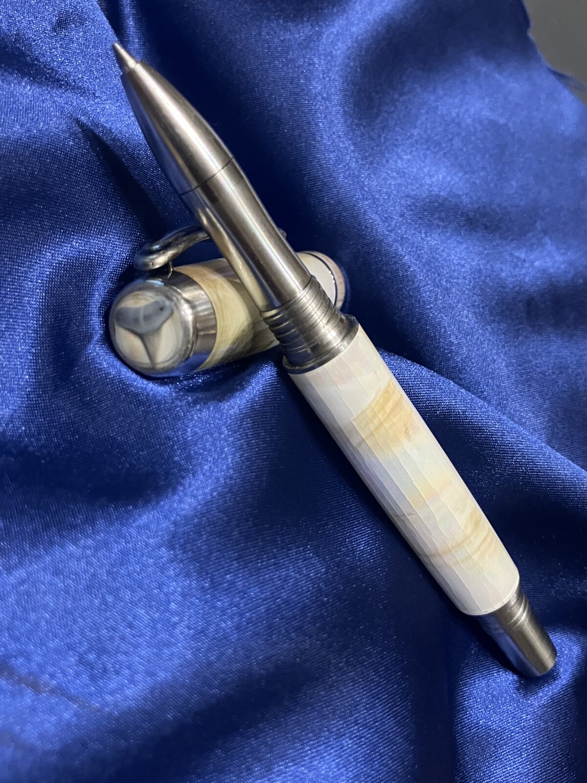

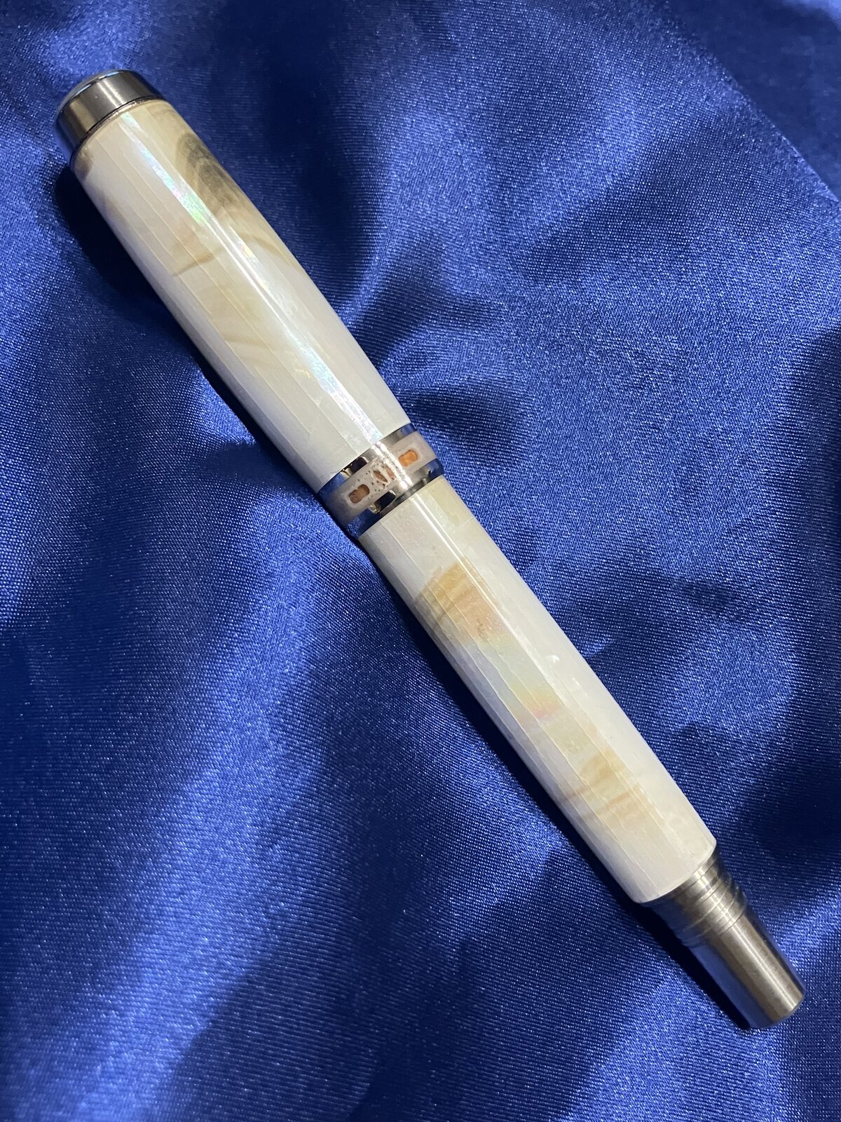

This one gave me more headaches than any pen so far. Thanks to John U. for his input trouble shooting some of the issues. The pen and cap is Light Tahitian Pearl. For some reason the pen decided to give me fits during the casting process. The center band is an actual shark vertebrae. I knew I wouldn't be able to fill it with CA on the center band so I cast it in clear resin then mounted it on the pen part. That actually went fairly well. The shark tooth was a different story. Installing the shell was easy. When I started filling it in with CA I had trouble with voids and bubbles. I lost count at 12 attempts. I decided to make a mold and cast it in resin. That was the ticket as I achieved it on the first try. I'll give this idea another try with a few tweaks. There's a couple of things I'm not happy with but I was ready to finish it up. Questions and Comments are Welcome.
I just noticed the finial is cracked. I guess I'll be disassembling it and redoing it again. I found some smaller teeth so maybe that will help. I guess I need to look a little closer before posting!!!!

Thanks. I pressed the finial in last but then noticed the center band wasn't seated all the way. I guess it cracked then. I'll have to call a meeting with my quality control guy. The problem is he's half blind and family so I'm stuck with him. Ha Ha

Thank You. I've already started redoing the finial. I found some smaller teeth so maybe it won't be quite so difficult.
