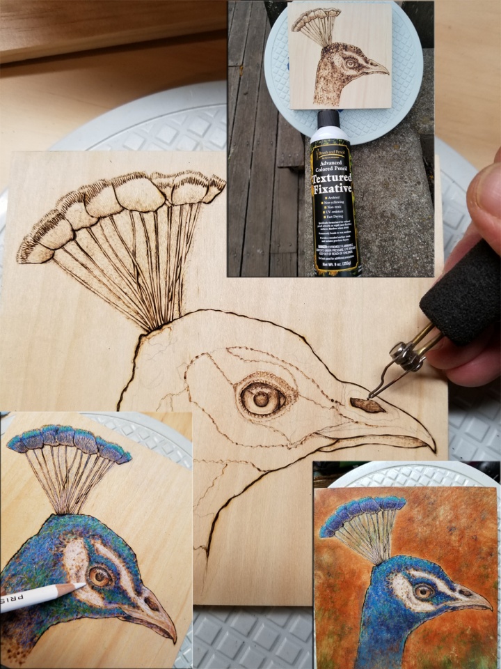

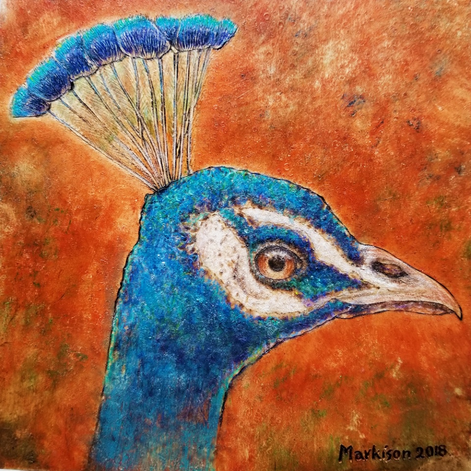

Fun little commission for a bird fancier:
Steps:
Life drawing of a peacock at the SF Zoo; HB pencil on a 6x6" 1000 grit-sanded birch wood panel.
Pyrographed with a Razertip burner.
Spray fixed with Alyona Nickelsen's Textured Colored Pencil Fixative.
Dried for 2 days.
Color penciled with Prismacolors.
Dried for 2 days.
Background painted and bird details hand brushed with Golden High Flow acrylics.
Spray fixed with Alyona Nickelsen's Final Colored Pencil Fixative.
Dried for 2 days.
Hanging hardware applied.

My long search for colored pencil fixatives that isolate the colored pencil layer and permit overpainting with acrylics (or other media) has ended with Alyona's fine fixatives (no financial attachment on my part).
These techniques will find their way into/onto pens in the next few weeks - stay tuned.

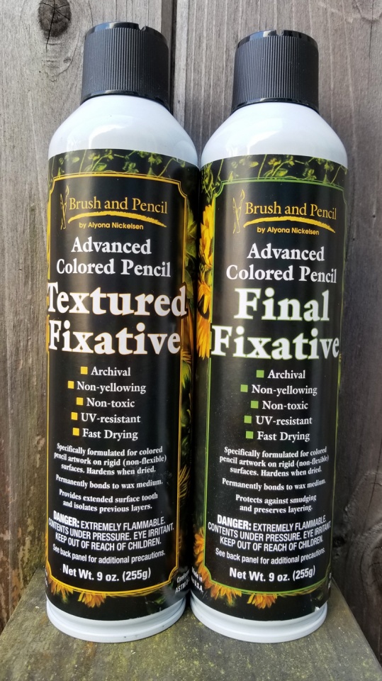

Mal - Clarification:
Just 2 fixative products:
attachment.php
Textured fixative over the pyrography and over subsequent layers, then Final fixative over all.
My next test is PR casting after final fixative application. I'll be doing some experiments with similarly sequenced wood pens in the next couple of weeks - and will keep you posted.
Hope this helps - Bob

Bob would the fixative be the art world's equivalent to a wood sealer? Seal the surface below and provide texture for the next coat to adhere to.
Bob ... thanks a lot ... helps a great deal !!! . Sorry ... that info was already provided and I did not pick up on it the first time.
Pete - Yes - BUT - colored pencil is a different medium insofar as the colors will shift and change with wood sealer. My goal in this piece was to go pyrography, then colored pencil, then acrylics, then fix the painting for archival purposes.
Wood sealer would probably be OK over pyrography followed by acrylics without an intermediate layer of colored pencil.
I've ruined my share of colored pencil artwork with the wrong fixatives, hence the nice little eureka moments with this combo.
Colored pencil colors are surprisingly brilliant on wood that has been sprayed with the Nickelsen textured fixative - enough to move me towards some pen experiments.
I'm hoping that PR will play well with the outer layer of Final fixative. I'll also try some CA finishing over the Final fixative, but prefer the added depth and "lens-like" magnification of a PR layer (stay tuned).
