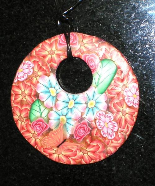

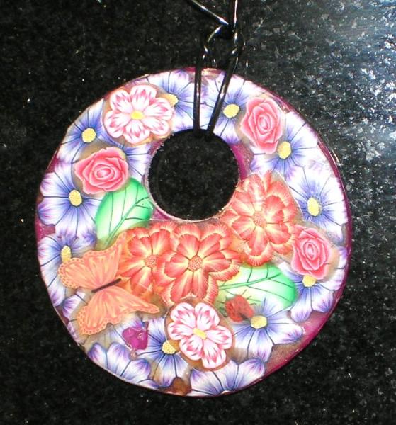

OK, we all knew it was coming. This is my first attempt at putting pc on a pendant. There is no backing plate, it is all pc. Kind of rubbery, I don't really like it, but it is a start and gives me ideas. The next will be on turned pendents and one sided. This is one pendent, showing both sides. It is sanded but no finish. This is how this one will end, put up in the shop for inspiration as I improve the next one. All comments and any ideas for improvement are always appreciated. Thanks for looking.

Looks great, I am pondering what if anything would be a good backing material. Would most wood be charred by the PC baking temps?
CaptG
Jan 3, 2007
2,686
Otsego, Mi, USA.
What about a metal insert? Then cover the whole thing in pc?
I have thought about that, but I think it might be easier to turn a plastic pendant, nylon or something like that, and then cover it with the pc. It would be a lot easier than cutting the metal and drilling the hole.

GARY!! Its EXCELLENT!! The reason its rubbery/flexible IS because the base is thin. When you make a pendant the base should be thick. But you can place it on a filigree thingy if you want.

Nice pendant, Captain!
How about Corian as a backer piece? They make countertops out of it, so it has to be somewhat heat resistant. Just a thought?

I made one using 1/8" alum. I covered it with liquid Sculpey to make sure the PC stuck to the entire surface. Sorry, it was a test piece so I didn't take pictures.

Gary, google pc pendants and you will get about a thousand tutorials. Wood wouldn't be good in the long run. The constant shrinking and expanding breaks the bond with the PC. I covered some wooden knobs for my daughters dresser and they lasted about 4 months. I used different glues, pretreatments, and everything else I could find. Aluminum would be good or as Toni said a thicker base will suffice.

Gary all you need to do is make a thicker base thats it!! Go to the craft store buy liquid polymer clay in a bottle. Run a base sheet on a #1 on the pasta machine. Lay the finished piece on top cut it out, place the liquid sculpey on the un-baked piece place the baked piece on top and re-bake!! Problem solved:smile-big:
