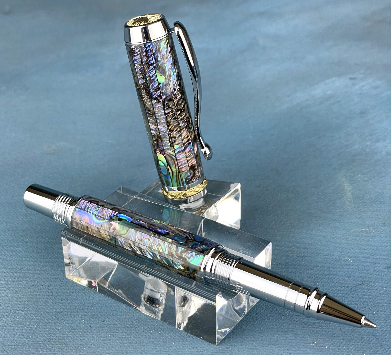

This arrived in today's UPS delivery and even after crafting 8 titanium inlay rings earlier I had to turn it. It took 45 minutes to flush sand, turn, flush trim again, sand, buff and build. There were two Tritons in process.

Really love your pens! They show off the beauty of the Triton kit so well! I think that is one of my favorite kits (despite some of the challenges with it, I seem to have a blank cracking problem unless I file down the tubes a good deal, then glue in the parts). Beautiful, yet simple enough and elegant. And they shine and sparkle so much with those abalone blanks you use!

I too make sure that there is no glue inside, but I do not file an extra amount. With the pen body, insertion is very easy for me. With the cap, the clip is easy. The plastic insert is made easier by using a 45 degree countersink bit to chamfer the inside edge. With that completed these pens press very easily for me.
