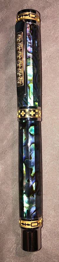

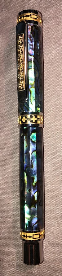

Jr. Emperor with Jr. Paua Abalone blank is a great combo (not the greatest photo).
