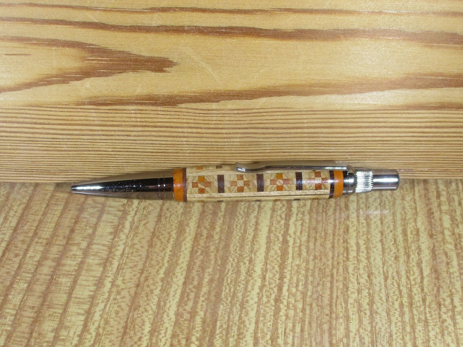

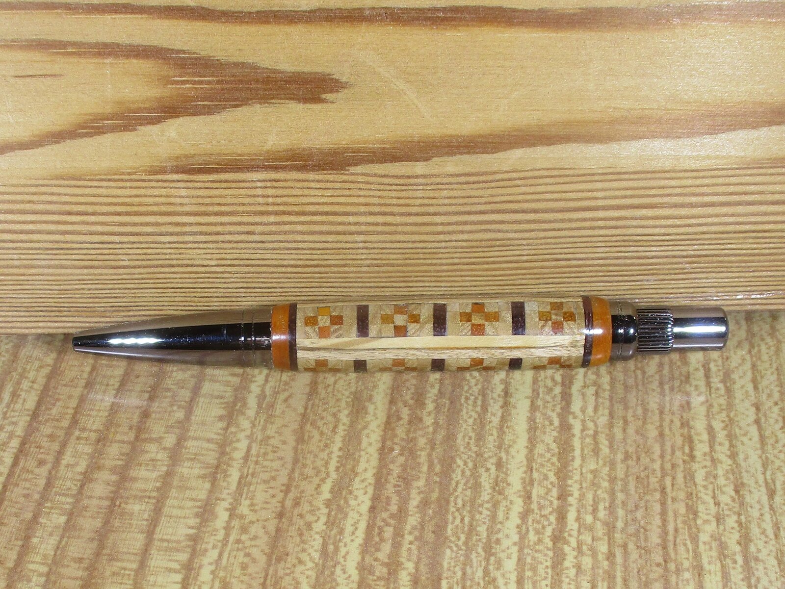

I finished turning the segmented blank that I posted recently and put it on a Solano kit.
I left it a wee shade fatter than normal as I didnt want the patterns to run into each other.
All comments appreciated.
Very nice blank. Must require lots of patience...which I have very little. May I suggest a more neutral background as a piece of cloth. Experiment with colors to get the best contrast without interfering to the multiple colors of the blank. Thanks for sharing.

It came up nicely.

Well done Alan. Did you cut staves or glue up squares with spacers?
Thanks Steve. The build was somewhat complicated and could probably be made easier, but this is how I did it. I made two identical blanks and ripped them into thirds, roughly, and reassambled, then added the end caps.
I'm not sure how to accurately cut staves, but know that it would probably be a lot easier. My problem has been maintaining an even dividing line between the patterns. I think that I eventually managed it successfully this time, but it has been a bit hit and miss.
Any advice on cutting staves will be more than welcome, by the way.
Thanks John, I will take up your suggestion.
