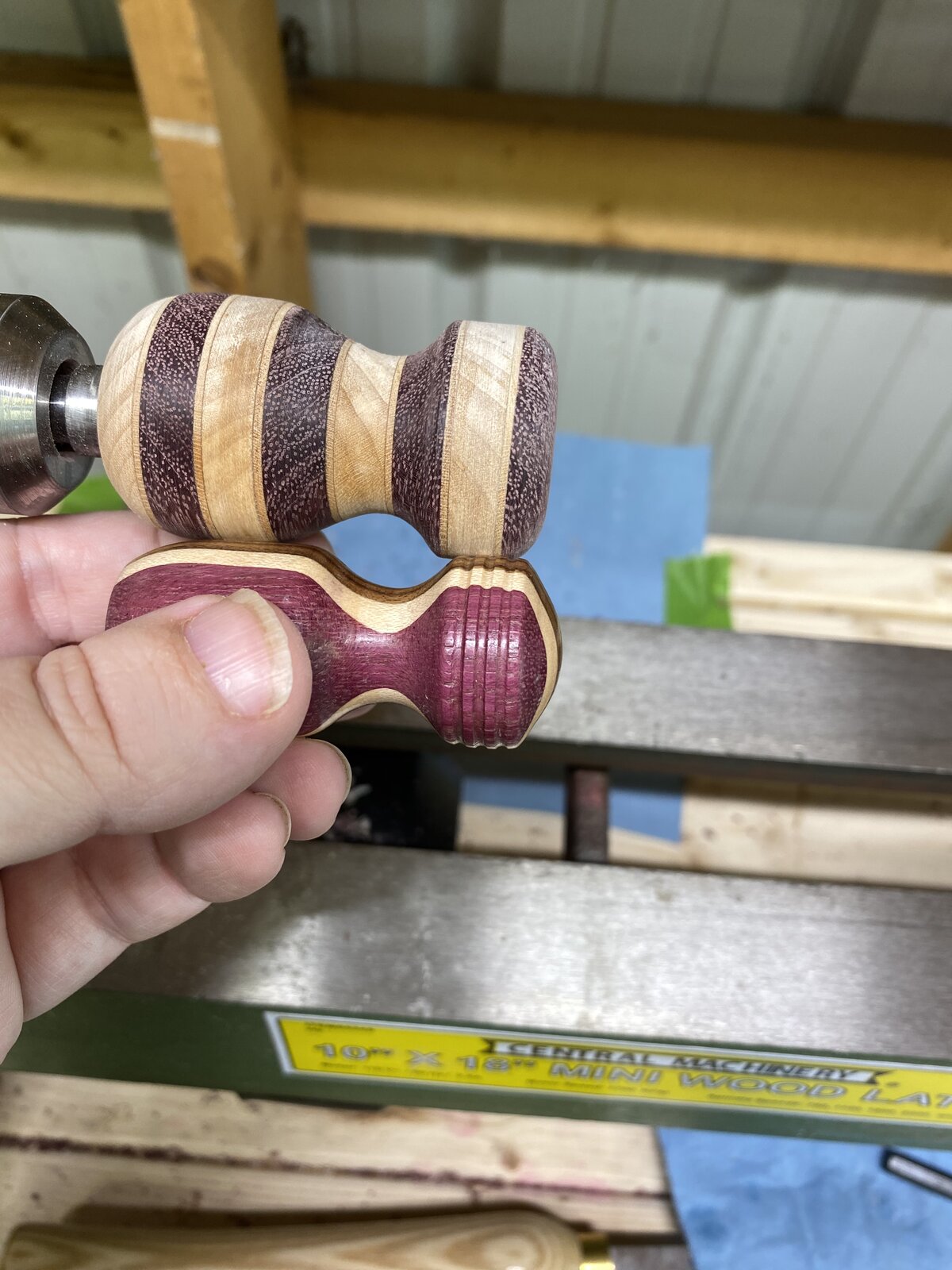

So, I'm totally new to all this turning stuff, but one thing I enjoy doing is making blanks. Blanks for pens, blanks for bottle toppers… I enjoy the gluing and pattern making and seeing what happens on the late.
So far, I just make sandwiches of thin pieces of wood, but I'm looking to expand and be more creative. I've looked into herringbone patterns, & inserting foil into the wood for Celtic knots, but is there a good resource for other patterns?
I'm big into cooking & work well with visual cues (especially visual directions I can print out) so I'm looking for something like a recipe to follow; like "place your wood exactly in this order shown in the drawing/photo, turn it down & it will look like this". Very A+B=C type stuff.
I've browsed Pinterest but haven't found any useful links for this sort of thing. Do you guys have any links you want to pass along?
photo for funsies; this is my usual "sandwich" patterns, but I'm looking to spice it up with something else.

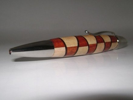

In my experience, it is hard to find or "dream up" a pattern that departs much from the "sandwich".
And they all require some rather skillful and time-consuming work with the saw and other tools.
I have not seen any "recipes" per se ... a la "cook books". . . Others may offer more ideas.
Celtic knots are one .... but they are kinda old .... and can be tricky because they have to be close to perfect in order to look good.
There are lots of examples of these.
One thing I have been thinking about for a long time is what I call "random" laminations of random thickness (all thin) of various woods mounted in groups at angles to each other ..... but not all "random patterns" (self-contradictory, I know) look good together.
ExoticBlanks ... sometimes ... has some for sale in their "Wood Artistry" section .... currently only one ... "Segmented pen blank 09A".
My meaning will be somewhat clearer if you have a look at that one.
Keep up your search and let us know what you find ..... preferrably with pics of your resulting pens !! . :) ;)

I've seen the "chaos blanks" and yes, I agree that some "chaos" blanks are less attractive than others and some are cool. I'm just a bit scared with those- unless I manage to glue up all the pieces with the grain in the same direction, I run the huge risk of chip/blow out. I have watched some YouTube's on them and the biggest failures seem to come from losing a piece due to "grain mismatch catch" when something is running in a different direction than the piece next to it. I might just try varying thickness of laminates and 1/8 boards and try cutting them on a bias, but I'm not sure how that would look. 🤷🏻‍♀️
IMHO, it is best to keep all the lamination grains aligned to try to avoid that problem of chip/blow out .... can still happen of course.
Gluing of the laminations has to be very secure.
Cutting on a bias does not always look cool.

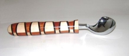

Looks like a whole bunch of pieces with dovetail profiles with banding in between.
Like Hank says plus a little more detail. A dark board and a light board glued together. Crosscut on an angle. Alternating flips with spacers of a dark wood between. Once glued they can be cut again to make a bunch of blanks.
