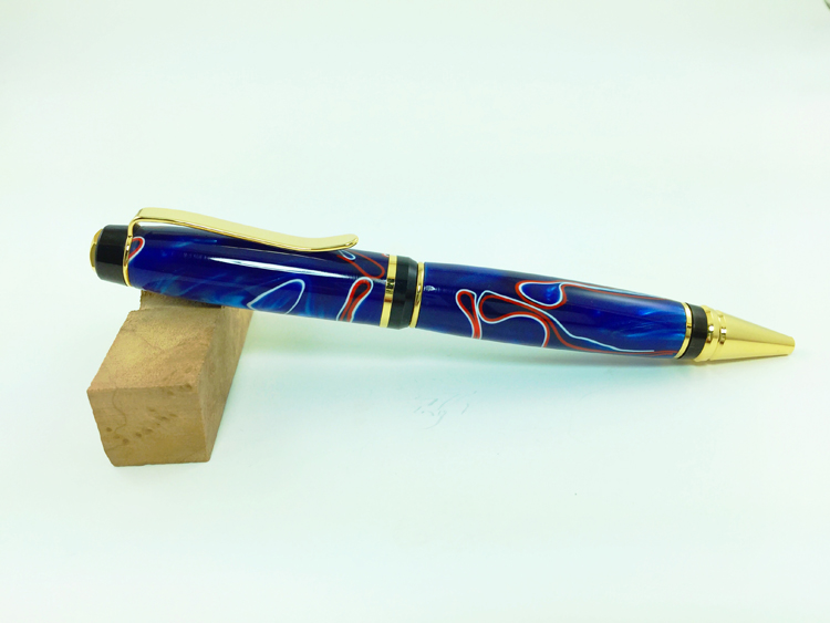

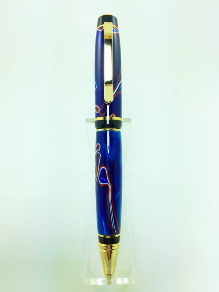

This Patriotic Kirinite acrylic blank really looks great on this gold Cigar. I really like these cigars and only flipped the bushings on two so far. Yep, I sure did and hate it but love the kit anyway.

That's a great looking pen, Michael !!! What are your impressions of working with kirinite ?
Magpens, I had no trouble at all with the Kirinite. I turned it at about 2000 rpm and made sure that my tools were very, very sharp. The Kirinite turned well and finished well. Really, really made a great looking pen.
