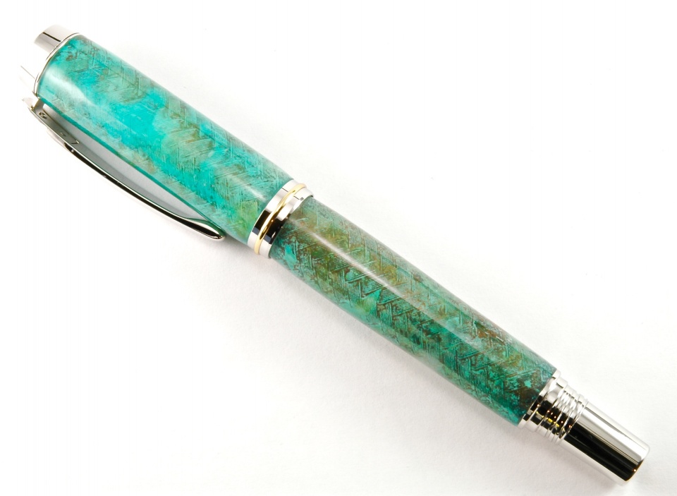

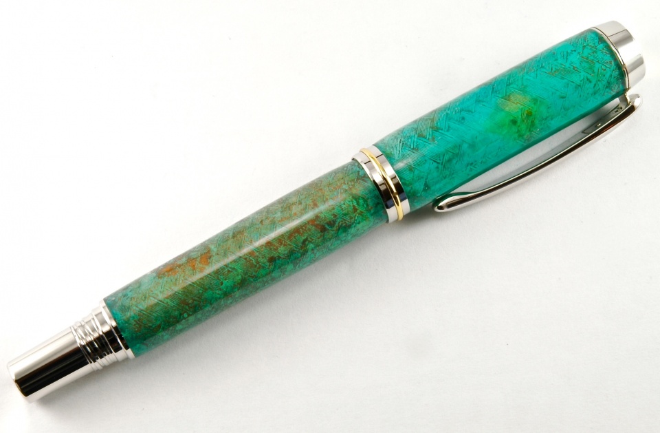

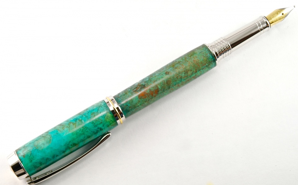

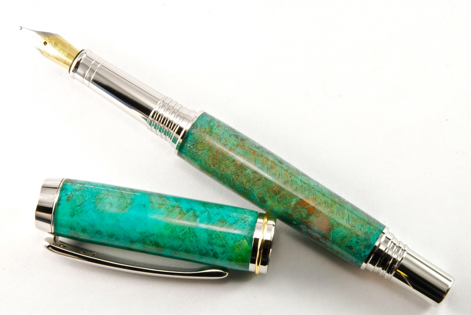

I went through a lot of material trying to figure out how to get a nice patina effect on copper. It's still a work in progress, but here is the result of lots and lots of trial and error. The kit is a simple Jr. Gent II Fountain Pen, the material is embossed copper with a patina finish. C&C is always welcomed!:wink:

Beautiful pen, very well done. It's a coincidence but I have been trying to develop a good patina solution for the past two weeks. I am going in a different direction pen wise. My best effort so far is vinegar, salt and miracle grow.
That looks great... A neat idea, my worry would be the patina progressing. Even though it's sealed in, or is there a way to stop the process before casting without ruining the blanks?
Even if it's real patina on the copper, it shouldn't progress ... needs oxygen, and it's in a sealed environment.

This looks really cool! For me... I would like to see more of the copper and less of the green - but not wait 20 yrs!
This is a nice combination. :smile:

I've never seen a source for embossed copper, do you emboss yourself?
Wow,that looks neat!

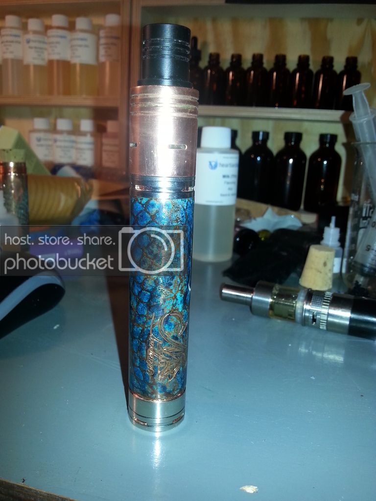

I've done some patina jobs on some of my electronic cigarettes that are made of copper. I used some ammonia on a paper towel in a tupperware container with the mod in there with it suspended in the middle of the container. Then we would sprinkle sea salt on the mod and then mist it with the ammonia in a squirt bottle. We'd put the lid on and come back and rotate the thing ninety degrees every hour or so. I usually left mine in over night getting up to just mist it every hour and rotate it. I'd add salt occasionally if it needed it. Here's a pic of it after the patina job.

Beautiful and very unique. I really really like it!
Great result from an original idea and process. Congrats!!!!
Yes Thomas, I emboss the copper myself...it's not too difficult and adds an interesting texture!:smile:
