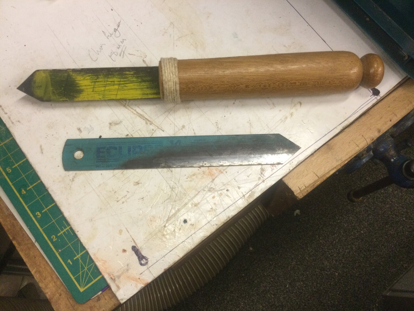

REALLY worthwhile calling into any local engineering works or steel stock holders and asking if they have any old machine hacksaw blades. You grind the teeth off and these make EXCELLENT parting tools about 1/16 wide by 1 1/2 " deep. Make a handle from two halves and bind it on and voila .
PS snap the blade in half by grinding a small line across it , wrapping in a cloth then hitting it when secured in a vice. DO NOT do this without a cloth and the line or it might shatter dangerously.
Reciprocating saw blades also can be recycled as parting tools

Here's a very old video of Capt Eddie on recycling a recip blade to make a parting tool
But let me emphasize that Rick Mayotte's idea of recycling a kitchen knife works just as well. I have a very thin parting tool that I made from a bit of high-speed steel that I bought from Harbor Freight (part of a set intended for users of metal lathes). I also made one from a conventional hack saw - it worked, but those blades are super thin and probably a bit too flexible to be practical as parting tools.
