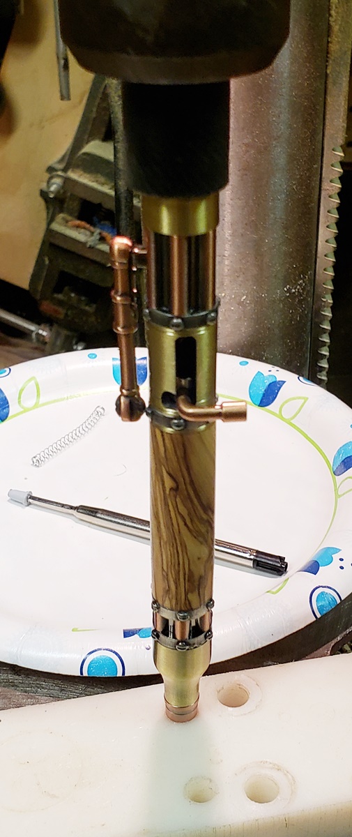

I used to have a problem when assembling pens, pressing the tip against a block of UHMW plastic. It seemed sometimes it would close the tip just enough to make it hang up. I now drill a hole in the UHMW so the tip isn't pressed against the plastic. Seemed to work for me.
Insert the refill in the opposite direction into the tip. If it doesn't slide in effortlessly all the way to the refill shoulder, you need to ream the tip area. If it does slide in easily, the problem is likely the crappy southwest tip casting. Use a "parker size" drill bit to hand ream the inside of the tip casting a bit. No need for power. It should be easy to ream the soft metal. That should clear it up. Not unusual for these theme style PSI kits in my experience.
