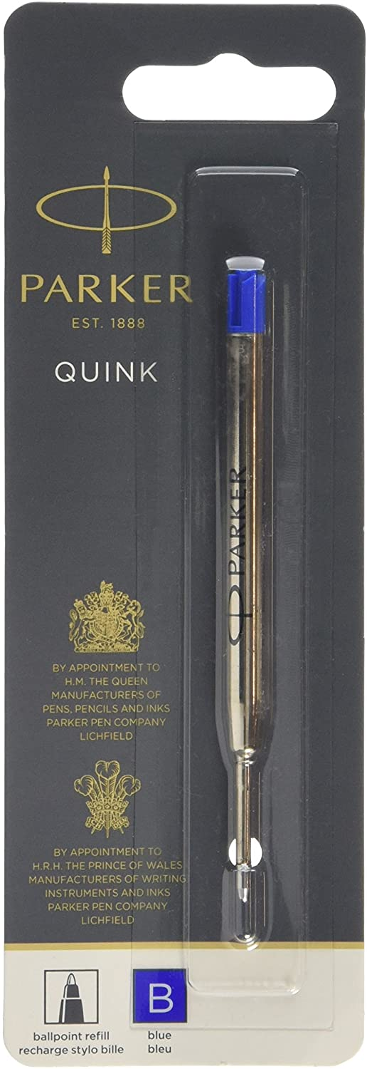

Hope you don't mind if I add a note of humor. . . I did a Google search for "specifications of Parker Quinkflow refill"
This is what I found out at one of the links listed on this page of results from this search :-
Results of search :-
The humorous part is that the refill size is not given, but what is given is the size of the the cardboard card on which the refill is sold .
At least, that's what I think is meant by these dimensions :-
Item dimensions L x W x H5.4 x 0.8 x 19.4 centimeters
Translated to "more familiar" units :- 2.12" x 0.31" x 7.64" ( can't imagine those being the dimensions of the actual refill ) ..... LOL !
Sometimes I marvel at the usefulness of doing some Google searches !!!
And then there is this link, which gives the lengths of a multitude of refills, but no diameters ......... THANKS A LOT !!! .... LOL !

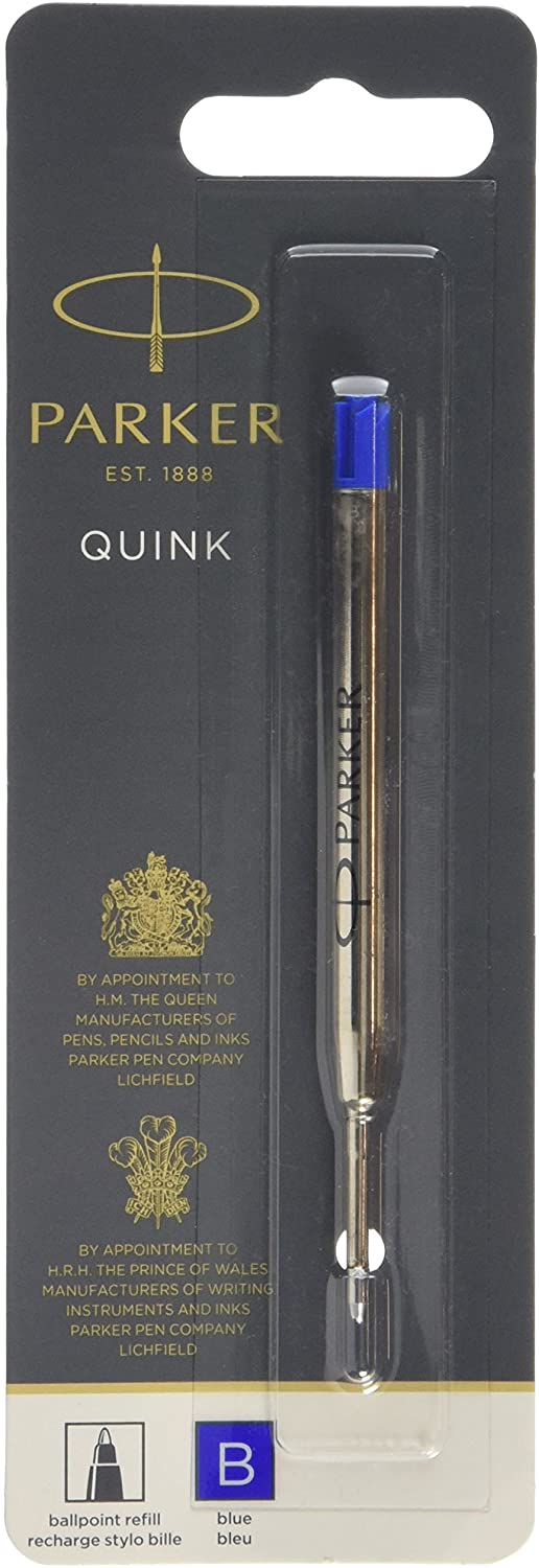

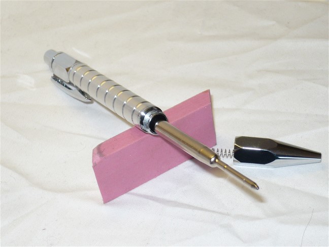

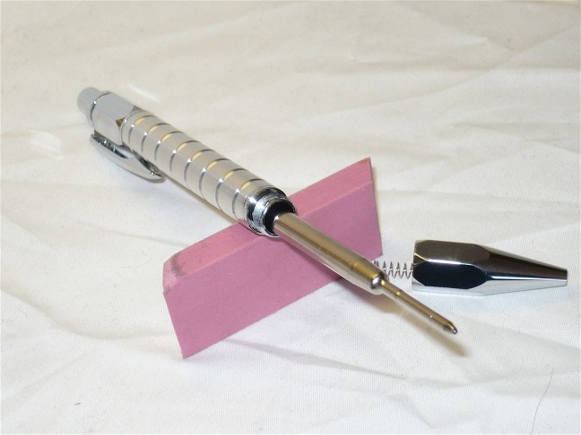

Hi,
I sold this Vertex pen a while ago. I get an email from the buyer saying that he is trying to replace the parker
style refill with a Parker Quinkflow broad tip refill
He says the diameter is larger than the pen barrel opening and it doesn't fit???
I've been searching for the past 2 hrs.to find the dia. of this refill but with no luck.
The standard diameter for the Parker refill is .236''
For the parker Gel / Rollerball the dia. is .248''
The length is 3.87''View attachment 301372
The opening of the pen barrel dia. is .290''
Does anyone have the spec for this Parker Quinkflow broad tip refill?
Thanks
Angelo

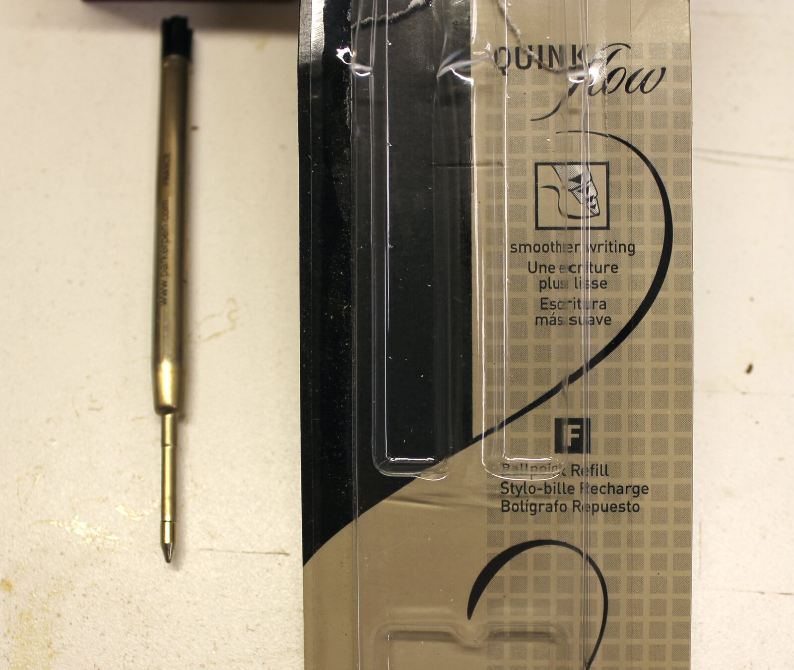

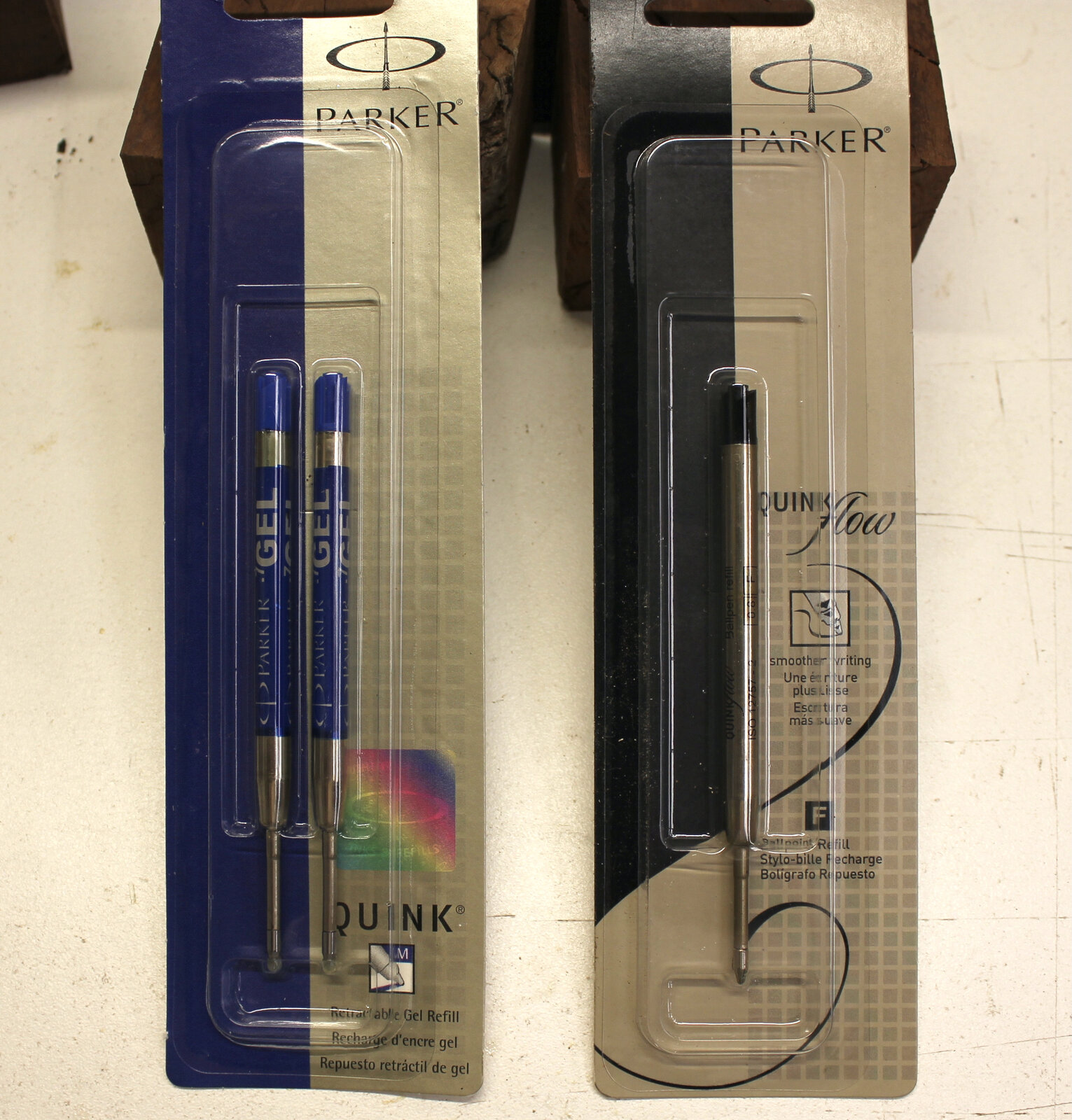

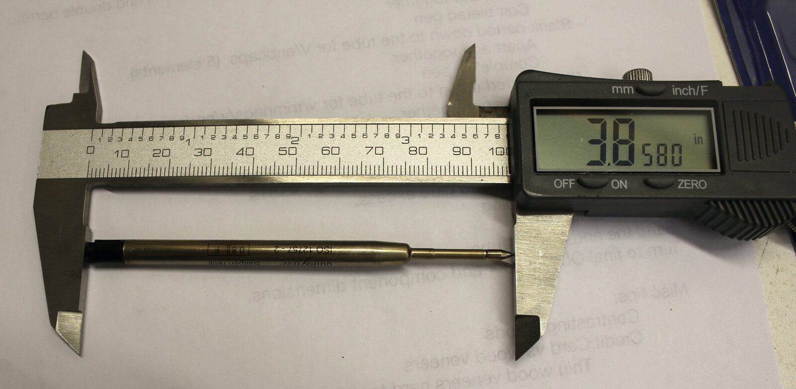

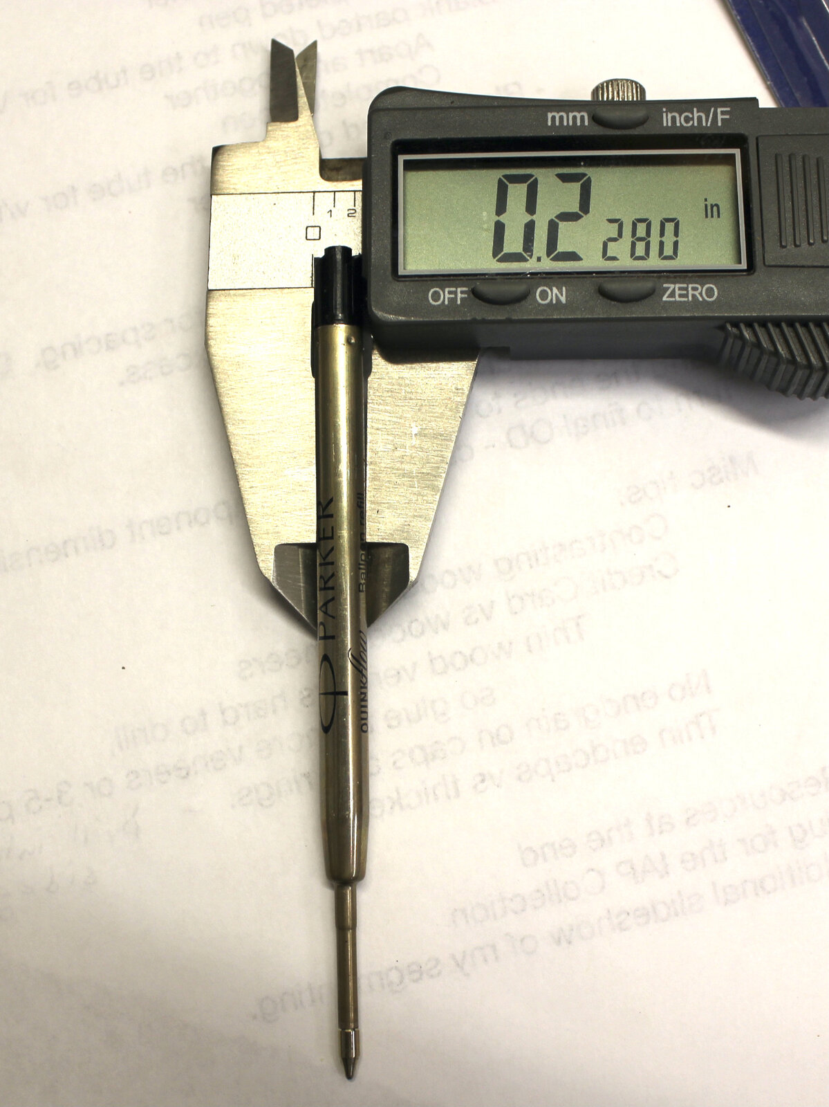

Just to add to the discussion. I have two Parker refill packets bought from Staples probably 4-5 years ago... Both Quink Flow, but not 'broad tip refill. Mine, on the right (Black) is labeled - Ballpoint Refill Fine.
Dimensions:
Length - about 3.858"
OD (Barrel) - about .2280"
Not sure if this helps, but it got me out of my chair...

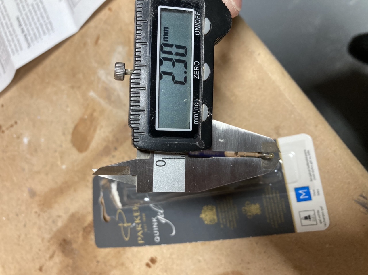

I just measured most of the pen tip openings that take a parker style refill.
Most are between .098'' to .103'' the Vertex measured .109''
Todd's pic shows 2.3mm = .0906'' If the pen he has can't accept these parkers maybe
it takes a Cross style refill???
We may never know LOL
