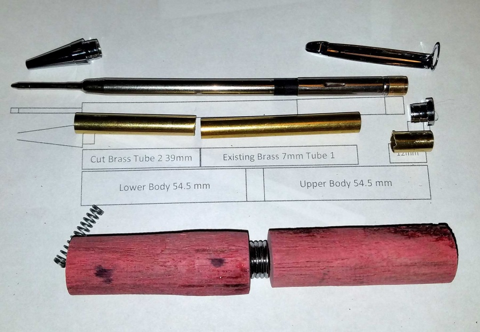

Had a Slim Line and a Wall St II on my desk and pulled them apart. The Slim line transmission moves about 1/4" in and out as you twist it. The parker refill laid beside the Slim Line lower is 1/4 in shorter the nib tip to end of transmission. Center band to the end of the transmission is 1 " the upper body is 2". The brass portion of the transmission presses into the lower is about 1/4".
So if you use a brass tube 3" long for the lower and 1 in long for the upper but use 2" blanks so1" is exposed. Use a sacrificial center band and turn as one piece. When turned/finished press the transmission in from the finial end backwards. Complete seating it by pressing in the finial and clip. Might need to trim the end of the parker refill to get a good nib exposure.

I have done that once before. Had an order for a slim pen using a Parker refill. All the observations about the length of lower barrel, and drilling the nib is true. Now as to the transmission, as Mal points out, a Parker refill back end does not fit into the back end of the transmission. To make it work I had to make a 'piston' that screwed into the transmission and CA'd in. I have tried to find photo's of the pen, but have not been able to. If I have time this weekend I will slap one together and document the process.
Worked ok, BUT (there is always one), the biggest problem is that due to the transmission only sliding into the lower barrel, pressure on the refill point tends to push the back section (holding the transmission) out. The only way to prevent that is to make the nib removable. The only way I can see this done is threading the nib (6mm?) and then tapping the lower barrel, so you would have to build up the inside of the tube.

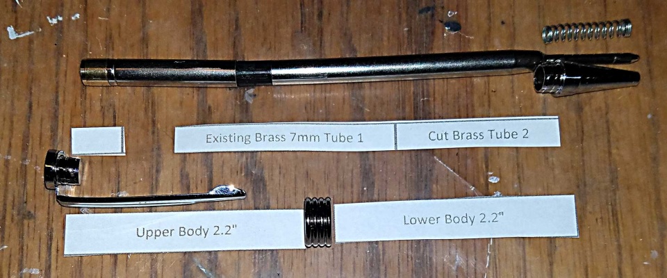

Attached is a layout idea I did based on Mr Vic's comments. Note that my measurements aren't exact - I think before I try this I'll calculate them out exactly.

Well done, Roy !!!!!!! . Thanks for posting all the details on this and your other thread.
