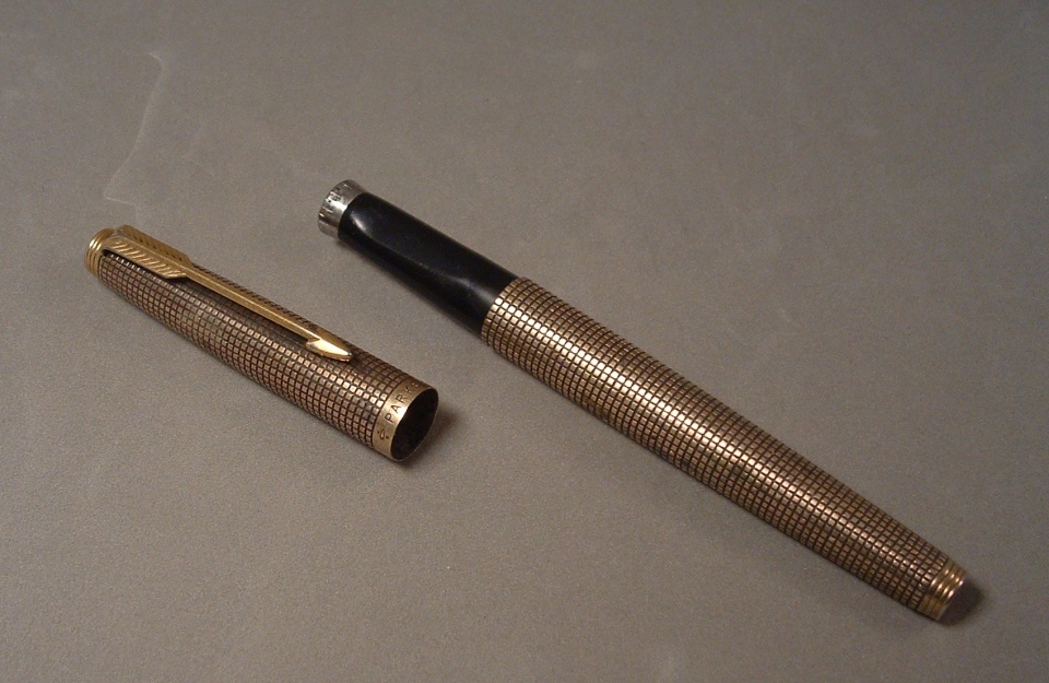

Someone asked me if I could repair the Parker fountain pen in the attached picture. I know next to nothing about fountain pens but I would like to see if I can do this for him. It is an older pen that belonged to his father and he would like to get it back in working order again.
To help identify the pen, the cap has 3 lines stamped on it, with "PARKER" on one side and "STERLING & 14K G.F." and "CAP & BARREL USA" on the other side of the cap.
The nib is broken off and missing, but it looks like the entire lower section can be replaced if I can find a replacement part somewhere.
Can anyone help me find where I can order the replacement part from?
He also asked if the pen could be polished up. Any suggestions on what would work to clean and polish the metal exterior of the pen?
Thanks!

Doug,
try posting this call for help on The Fountain Pen Network site. There may actually be a Forum there on 'Parker' pens. I am confident that you will get a response as to what model pen you have there and if it is a 'limited edition'. The GF stands for 'gold filled' but not 100% certain. Hope that the lead will help in getting good advice on possibly restoring the pen that you have there.

It will been a new nib for that pen looks like Parker 75 for a nib section will run about 125.00 for that pen or more.
I've seen some nibs with feed for $75. Is the feed broken off and still in the section. If so it will help ID the type you need. They don't happen to have the nib? that could also help ID and you might find just the feed if you only need it.
From what I've seen $75 for the section with a nib is a pretty good price Mr. Vic. The nib is not available and was broken off flush.
I'm afraid the lower plastic part is damaged and will need to be replaced in addition to needing a new nib. The plastic part just threads into the lower barrel so it should be very easy to replace it once I find a replacement for it.
Check with Indy pen dance Mike may have one if not I will be in philly for the pen show at the end of January.i could see if I can fine you one.
I do believe that is a Parker Cisele. They are still being made today. There's probably nothing wrong with the pen, just needs cleaning out. Fountain pens need to be flushed once a month.
I wouldn't try to repair that pen if I were you. It really takes a specialist.
