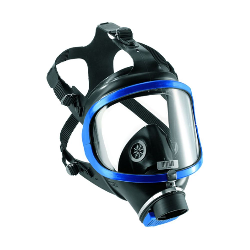

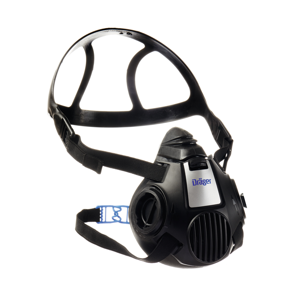

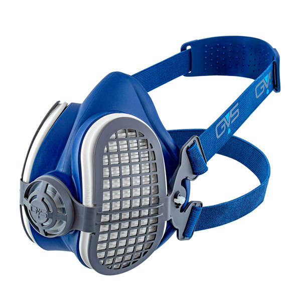

these are the masks that i use: the draeger (xplore 3300) half mask is great for and easy to wear, the full face is great when working with ca,fumes etc. they both work with the same type of cartridge that filters fumes and dust. i use the jvs for lighter lathe work and not sanding. jvs is great and lightweight but i can tell that the fit is not as good as the others, thats why i use it mainly when woodworking outdoors. so my question is: is the papr an upgrade in terms of filtration or you pay the extra buck for comfort? cheers
