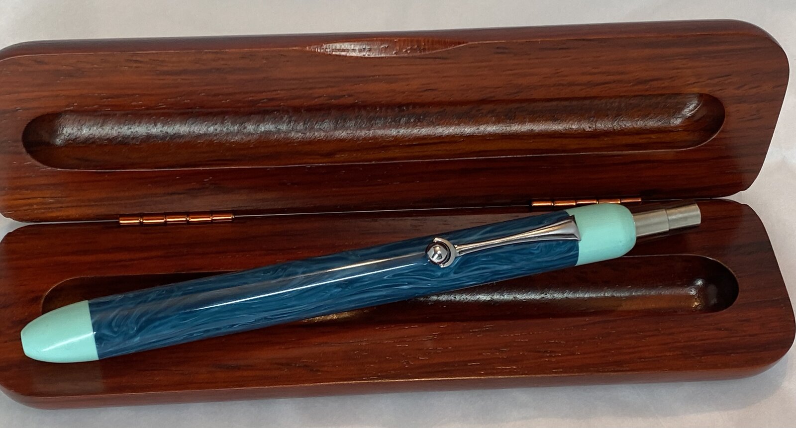

My future Daughter in Love likes the PaperMate Profile 1.4mm pens. So I took the kitless click concept and adapted it.
She also loves sea foam green. The only seafoam I had was water pipe. I had some of this bluish green wispy material too.
Both of the green ends are threaded.
The ballpoint part of the papermate is much shorter than a Parker, while the refill is about 5/8" longer. Made for some fun measurements.

Very nicely done ! ! ! . . Thanks for showing.
Is that a Schmidt SKM-88 click mechanism at the top ?

That's impressive! It can be challenging to get the length just right on the clickers even with the adjustments sometimes required with kits. The color combo works well. She'll make some bold statements with that ;).
