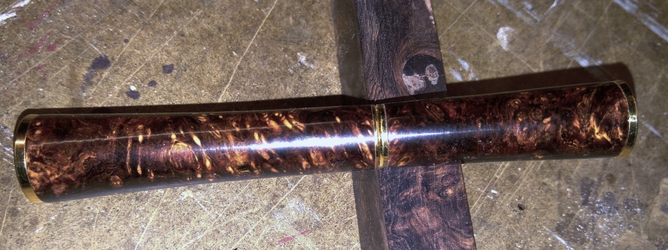

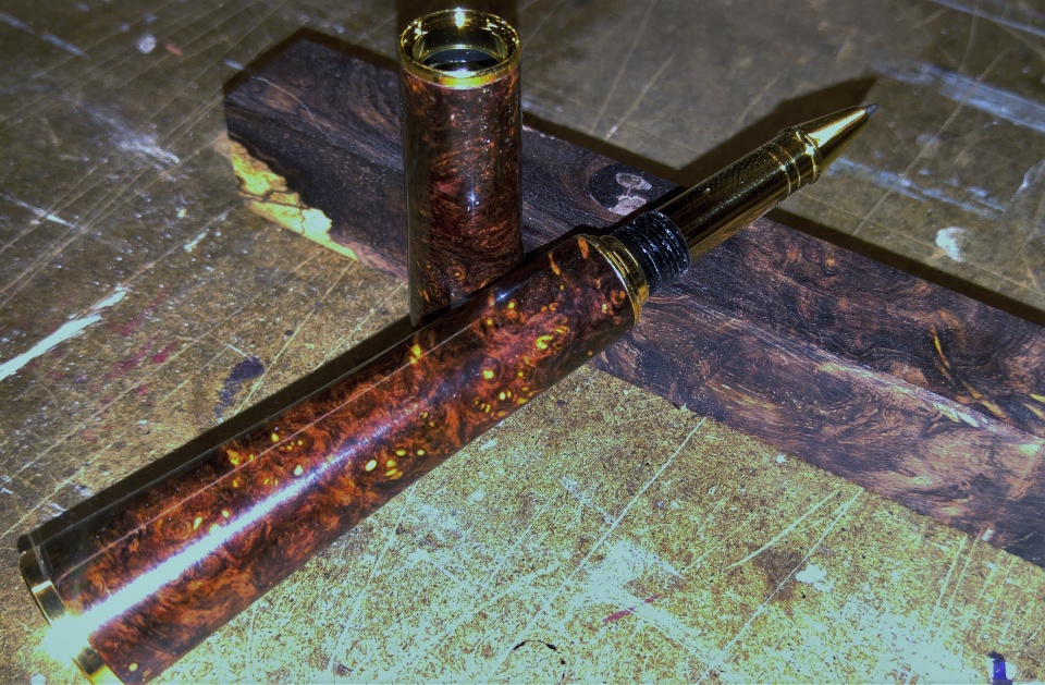

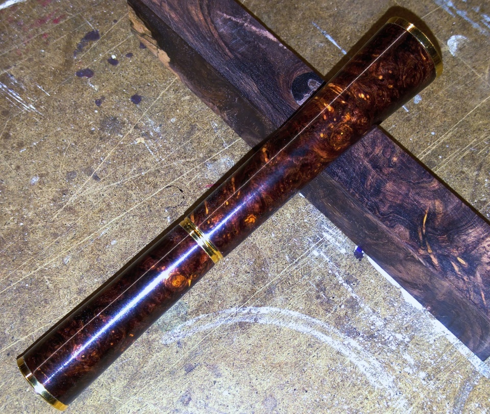

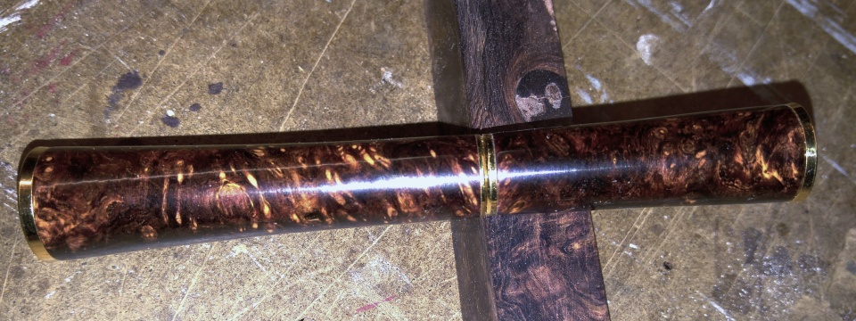

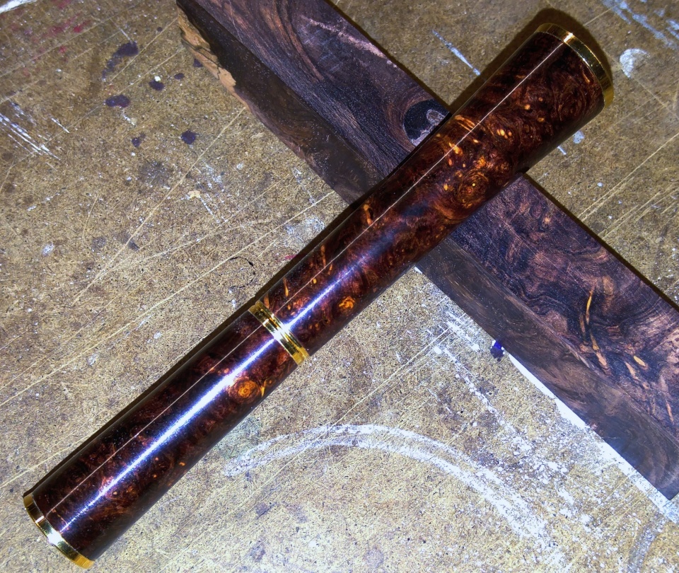

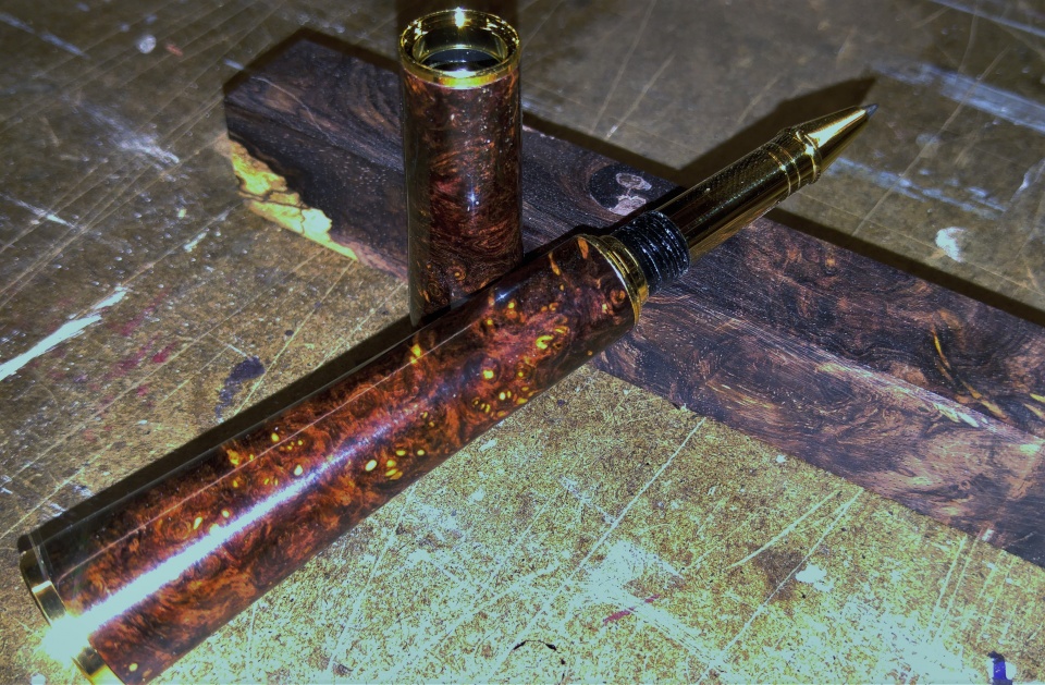

Ok, here is what I ended up with. Now, this was basically accomplished with hand sanding as I had the bulk of the profile completed while I was communicating with ya'all.
These pictures are not the best as they were taken quickly with my LG G4 phone.
I want to practice some on the coves before setting out on a $20 blank and $20 kit.
This is a Panache in gold accents using a Honduran Rosewood burl blank.

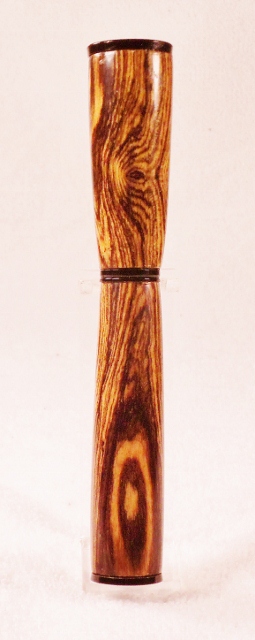

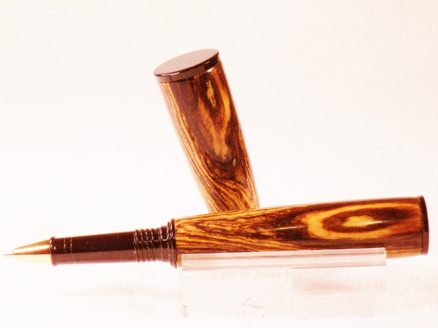

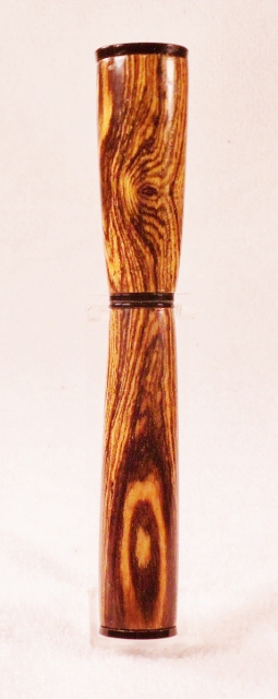

This is a twist I do on most of the Panache kits I build. It gives them a much better balance and look, stays away from that vampire stake look, and gives them a much better base for a stand alone deck pen. I switch the large end cap and the small end cap end for end. You will have to cut or grind off the flange for the large tube and super glue both caps on. Jim S

That's really close,a slight bit more curvature needed on the cap.If your using bushings,slip it out of the way and hold the end cap up against the blank.You can check the angle and adjust your sanding to finesse it into shape.Don't forget to slip the bushing back in for sanding.
