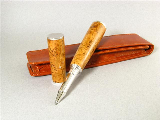

Hi Randy; Not sure of your question! Use your burl blanks, no problem!
attachment.php
This was turned from a 3/4" X 5" blank!

Huh... Strange, must be a typo on the website. Thanks! That's a gorgeous pen :D

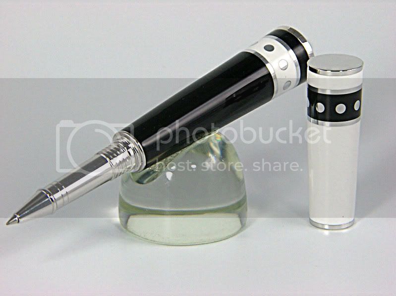

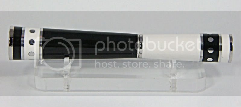

Really nice lookin' pen John. Which metal did you use, aluminum or something else?

Thanks John
I used aluminum and black and white acrylic.
