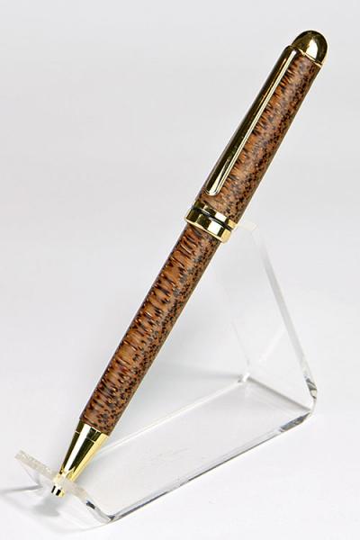

ren-lathe
Feb 6, 2011
343
St. Clair Shores, Michigan
Turned several. A gouge works but as has been said you have to take light cuts. & squaring with a pen mill can be a disaster :eek:.

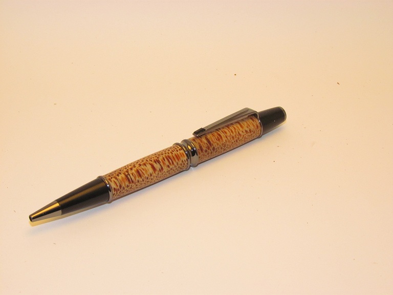

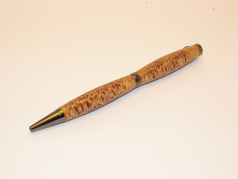

Lauhala is fun to work with,very similar to palm. I like it turned both ways but love cross cut better

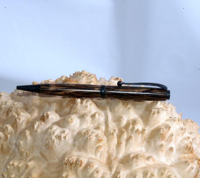

The issues with palm may be the main reason I have not made another one. I did this one about a year ago before I got so much better ideas from the forum. It was quite a struggle, but I found out that if I concentrated on making angled slicing passes with my skew rather than flat cuts, it went better. However, I did have to use my palm dust and thin CA to reinforce the exposed grain near the end of my profiling.
