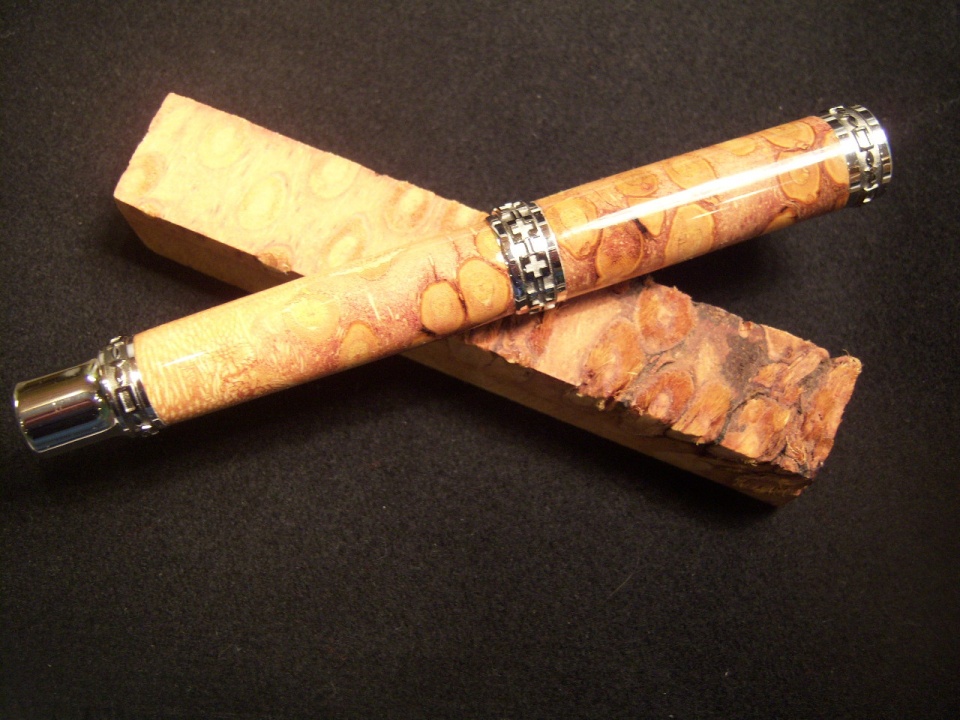

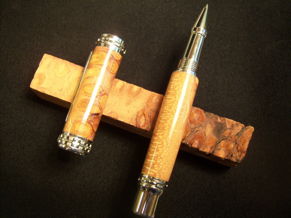

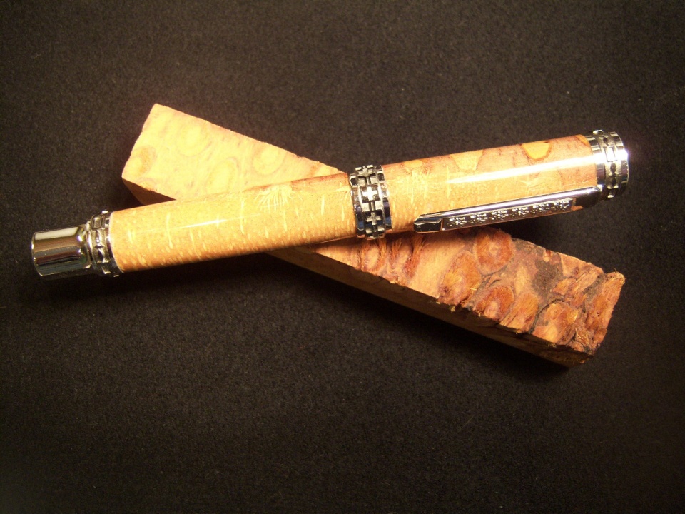

Just to prove I don't destroy every blank you send to me George..and am still waiting on an epiphany to save the olive blank that had a booboo...palm root on an emperor with 5 coats of med ca mm'd to 12k..all and I mean ALL c+cs are more than welcome...unless ansel adams is out there..photogs know..

Really nice job! The blank fit well with the kit, and the turning and finish look great!

I had a few of those that i wished I had the stabilizing system then, they are not the worse to work with because they are the very joint where the roots strains start to form from the Palm tree butt/base, the strains are still all connected to the main Palm wood material, keeping everything together and without and soil in the mix. The same can not be said for the root material I use on the Resifills, they are fully composed by Palm strains with dirt/soil as the "spacer", mother nature done that, not me...!

Thanks to all for the nice comments! I turned it with a gouge kept very sharp and when I was getting close to the sanding stage I kept applying ca and cutting very little at a time. George, I believe that was the first order I received from you about 3 years ago and if I remember correctly I got 8 of them. Blew 2 up, took a break to improve my skills, turned this one and I have 5 left.:smile: I'll be turning the others sometime soon for other component sets as I like how this one turned out. Maybe I'll use one of these on the olive majestic that had the stress fractures and poor fill spot:wink:

Those were a special batch I cut from another smaller root I got and I specifically cut those blanks with half/half of the normal palm fibers and the joint where the root strains grow from, like I said is workable but was/is on the soft side of things, and that is the reason why I said that I wished I had the Stabilizing system then, I would have stabilized them for sure, as you find out, without some gentle handling, they can be destroyed quite easily...!
Those blanks are OK to be used with HSS sharp tools as they don't have any soil/dirt that far up in the root however, a small catch and goodbye blank, with the flap disc, you don't have catches and the sanding motion of disc turning in one direction while the lathe turns the other way, the finish will surprise you even with a 40 grit flap disc.
