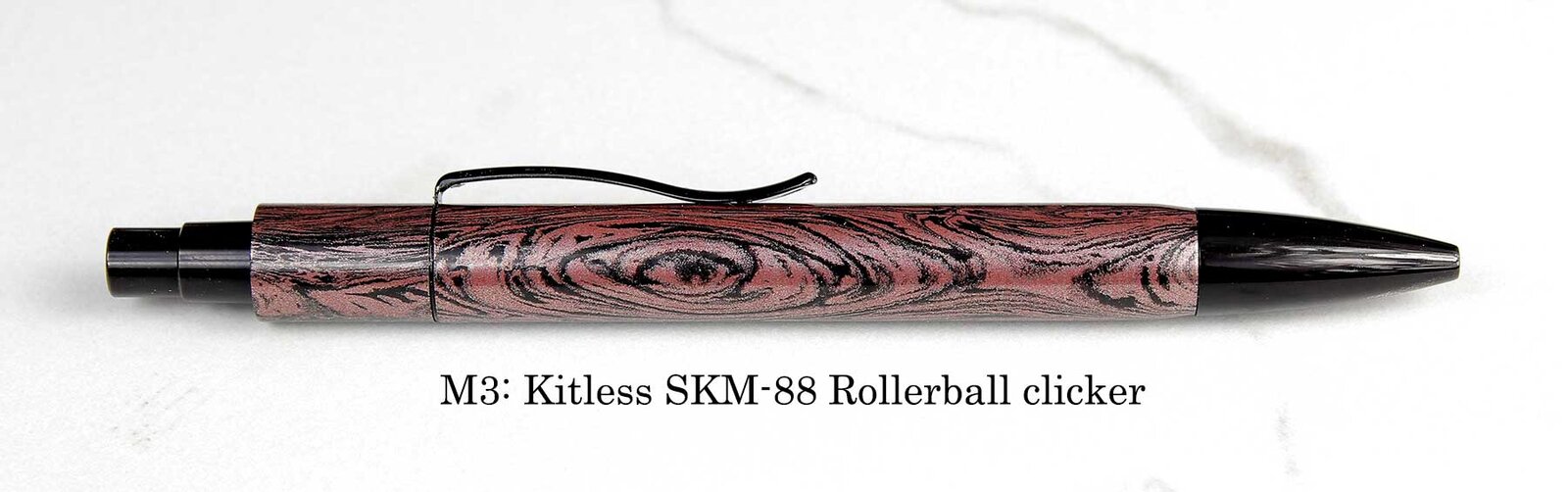

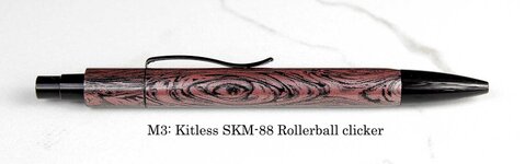

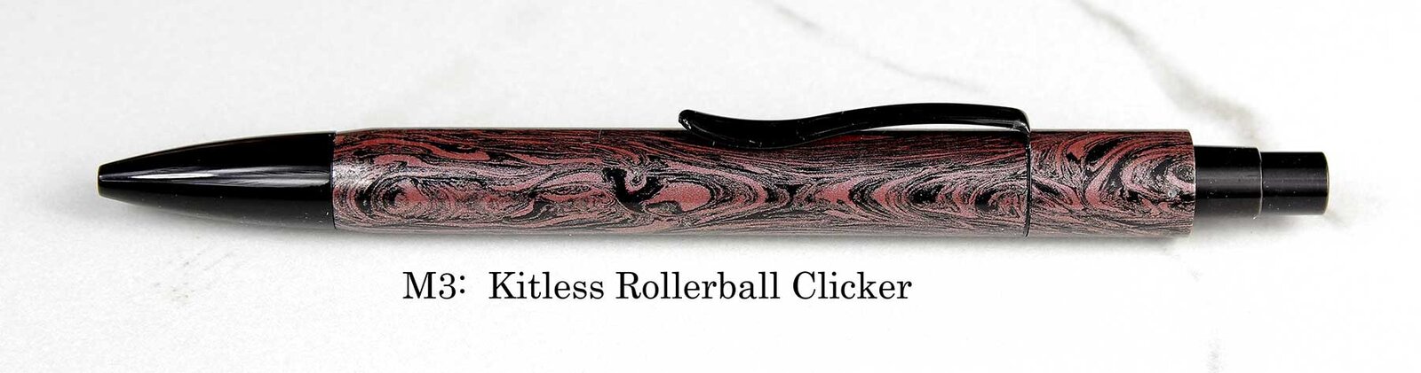

Finally got a bit more shop time after blizzard cleanups.
M3: Kitless Rollerball w/Black SKM-88 clicker

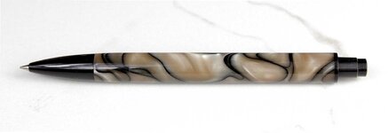

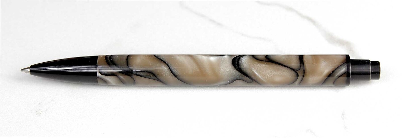

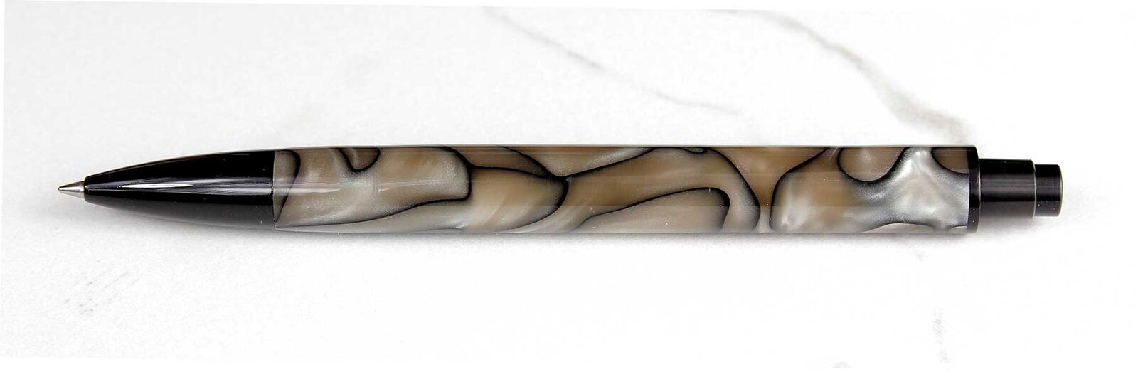

Acrylic Kitless Rollerball w/Black SKM-88 clicker
M3 was pretty crumbly when threading. Weight is not quite double that of acrylic. The blank was labeled black/peach mokume. The peach darkens to a nice dark red color when finished. Clip was intended to be much closer to the clicker but an OOPS got in the way. Refill will be a Pilot VT-R7 capless rollerball cartridge (dimensions similar to the Schmidt 5888 or Pilot G2 but OK to be capless)
The acrylic was to have a clip but I ran out of blank and didn't want a large distracting accent piece.
Black nose cones from the scrap drawer (m9x.75 thread)
